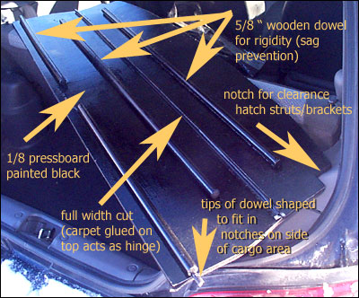

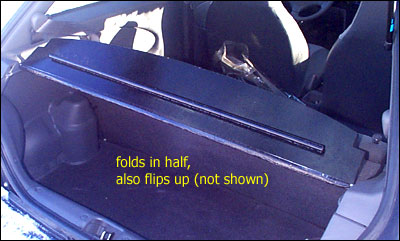

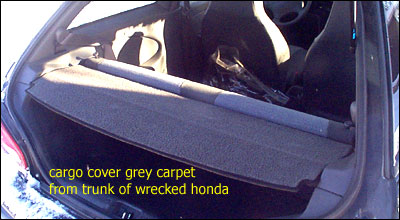

so i ended up making one myself. took a couple of hours. materials were pressboard, half inch doweling and a big piece of clean trunk carpeting from a wreck to cover it. turned out nice. i should take a pic and post it.

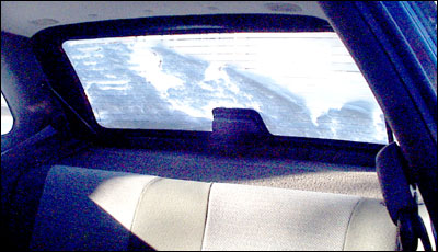

DIY cargo cover: 95-99 hback
it's thin enough that when i want to fold down the rear seatback, i just drop the cargo cover on the rear seat and fold the seatback onto it, sandwich style.

Good work my man! Good work.

Thanks guys for all the info. Nice job on that custom deck!
