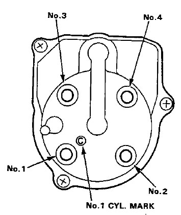

Hi,
Whenever I start my car the engine sorta backfires like the timing is off.
what is the correct spark plug order on the distributor.
Also when looking at the front of the engine the order is 1,2,3, and 4 right?
Thanks
ci5ic
08-05-2003, 06:00 PM
From the front of the engine, the order is 4, 3, 2, 1 (left to right). On the distributor, the order is this:
http://files.automotiveforums.com/uploads/695735DizzyCapOrder.jpg
blade34609
08-05-2003, 07:09 PM
Aiight thanks Alot now I got the correct order.
