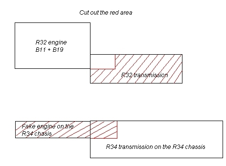

Many people asked me for the method of putting the RB in the R34. Here it is. This is only my way of doing it.
It does not require cutting the R34 chassis and swap with the R32's chassis.
It can use on the R33 kit too.
You might need both kits instruction to understand the pictures. Use you imagination might help too.:D
Sorry for the rough drawing. Drawing are not in scale. Part number are according to tamiya 24210 and 24090.
http://files.automotiveforums.com/uploads/7749571.jpg
http://files.automotiveforums.com/uploads/8028212.jpg

What's the purpose of keeping the 'small part of' R32 transmission? Does it help alignment or something?
