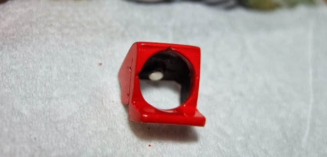

what kind of paints again did you use? it might be a delayed reaction between the color layer
Hi nugundam93, I used on that part of the door,
(*All the layers were air-brushed)
1, Tamiya super surfacer and dried for 1 day then sanded
2, Tamiya fine surfacer and dried for 1 day then sanded
3, Gaianotes White Surfacer Evo (thinned by Tamiya lacquer thinner) and dried for 1 day then sanded
4, Gaianotes EX White (thinned by Tamiya lacquer thinner) and dried for 1 day
5, Tamiya Spray Italian Red + Bright Red mix, about 4 thin layers and dried for 1 day
6, Gaianotes EX Clear (thinned by Tamiya lacquer thinner) about 4 thin layers and dried for 4-5 day then sanded with #1500 Tamiya sand paper
7, Gaianotes EX Clear again
Finally after 4-5 days, I polished with Soft 99 compound, Tamiya course compound, Tamiya fine compound then finishing compound.
All the paints were lacquer based, and basically this problem wouldn't happen. The clacks seem to be from deep, from surfacer.
So far, I would try the clear coat again, then sand and polish... if failed again, I would... try urethane clear, maybe (but after trying on other sample, seeing the deference of luster between the other body parts.

The problem you're having with the cracks is because you applied far too many different layers of primer/surfacer and you didn't allow enough drying time in between the different layers. By my count you put 4 layers of white primer/undercoat onto the body before you applied the red, and they were all different products. For that amount of layers I would have left a minimum of 1 week drying time, however to be bluntly honest it's just too much primer/undercoat. 2 to 3 light coats of Tamiya white primer would have been adequate, with a minimum 1 week to dry. The problem is when you applied your colour coats and ultimately your clear, the thick layer of primer wasn't properly dry, so once covered it then continued to dry causing shrinkage and the top coats have cracked as a consequence. Also sanding the clear with 1500 paper and applying more clear has made things worse. 1500 is too rough and has inflicted fine scratches into the clear coat. Once more clear was applied over the top it has emphasised the scratches. Sadly urethane will probably not fix the problem. Usually a strip and repaint is the only option as the cracks will just keep coming up through the layers every time...

Thanks for your reply! As you advised me, yes, now I can see the biggest problem was the "too short drying time" and "too many layers". This time I made many mods and put many putty, so I should prime and sand many times, but I think I could use white primer from the first layer, as you pointed out. So far other body parts rather than the left door seem to be safe maybe because I allowed about one week drying time between every layer.
FYI, "#1500 (or #2000) sanding after clear coat then clear top coat" method is being used by many modelers in Japan and shows good results. But this time, because of my haste; I struggled to match the color up with the left door, it went worse, I believe. The method is now becoming very popular. (If enough drying times were allowed, it works )
I am recovering the left door now ant it's ongoing, so I'll report the results soon, Thank you so much again!!!

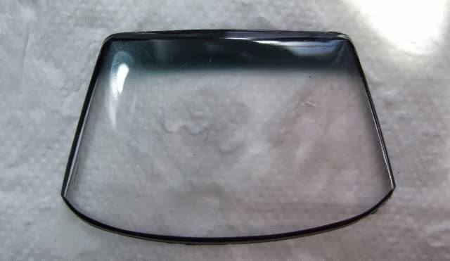

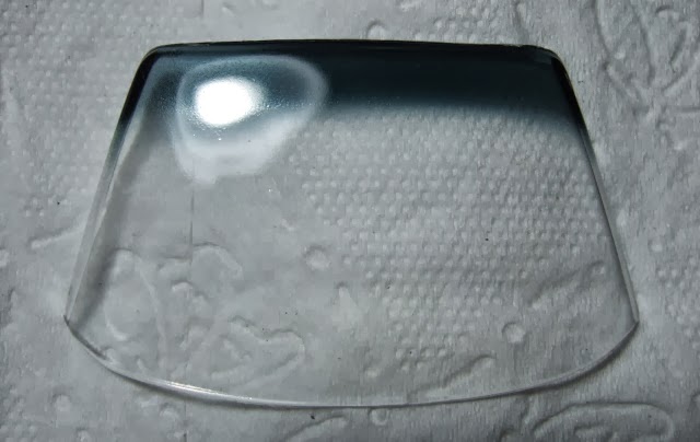

Masking of the shade on front window. Thick double sided tape and 0.2mm plastic paper.
I decided to use the front window from Revell's box. It was not too bad, and I thought it'd be too tricky to attach the thin, 0.2mm window I made. For now, I want to finalize this project and see the completed GTO!
The shade's color was, clear blue 60% + clear red 40%. Then clear coated. After this, I'll polish.
But the rear window was replaced to 0.2mm plastic transparent board. I want to see the dashboard clearly through.

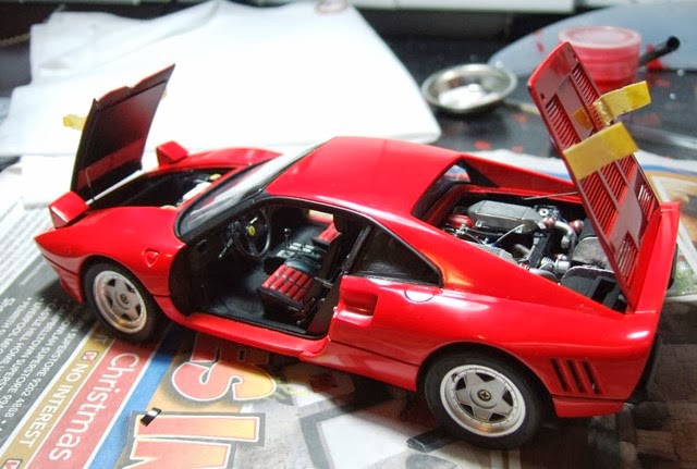

I'll post progress of 5 days (I wish I could spend all my time making my GTO, though maybe 1-2 hours a day).
I'm sure I'm approaching to the goal (except the left door).
Masked and sprayed the window rims.

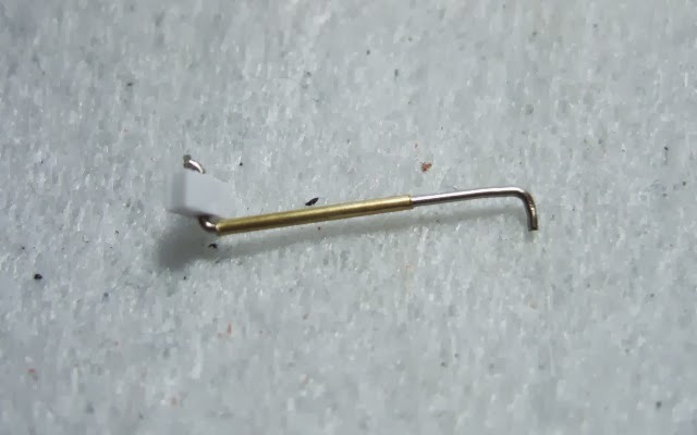

0.3mm Plastic paper was adhered to the side of rear window. It could be a bit thinner, but I thought thinner materials would trace the rough surface. This was cool enough for me.
Front hood stay. Mainly just made from 0.5mm nickel silver and plastic bar to be adhered to the body, but to show as if it was dumper, I just added the brass tube. ....I forgot to take photo of rear one (rear one was simple, as the real one was).
Finally the body and chassis were docked. Still there were lots of adjustment for the hinges of front and rear hoods, height of the interior tub.... and so on.
I normally trim the edges of the back of the wheels. I don't know why car model manufactures make me do this messy job.
Then simply masked the wheel centres. I could take off the plating, but after painting the metal-look paints, it's all the same, we can't touch so much. I took an easier way.
Sprayed Flat Aluminum (Tamiya enamel XF-16) and the air valves were attached. I bought these valves about 10 years ago.
Tyres were attached. Now I can see this is a car, indeed. Luckily, it seems like I don't need to adjust the height again.
I need to hurry up instead of watching, but I can't help smiling watching this "almost finished" appearance.
It was lucky I didn't need too much time to adjust and fit the head light units.
Left door is now under repair, but just some small jobs to do!!
And I'll be making wipers, fitting emblems, mirrors and show case as well very soon.
I hope I could tell "I finished!!" on the next post.
Have a happy Monday...
