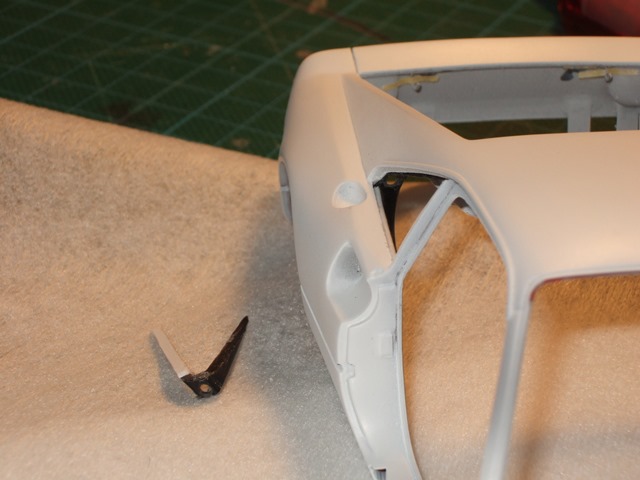

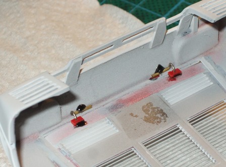

Hinges for engine hood. 0.5mm nickel silver rods and 0.6mm (inside) brass tubes. Plastic pieces are the stays for hood.
Adjusted several times, then I was satisfied.
But the hinges hit to the air cleaner parts... again I cut and pasted. Upside is the cut one.

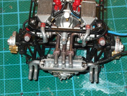

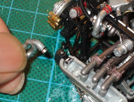

Attaching the exhaust pipes. I again put the magnets 'cause I found these pipes have to be movable when the body and chassis joint, otherwise these pipes will hit to the body.
Adjusted to certain position.

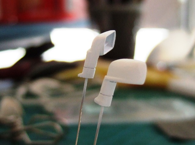

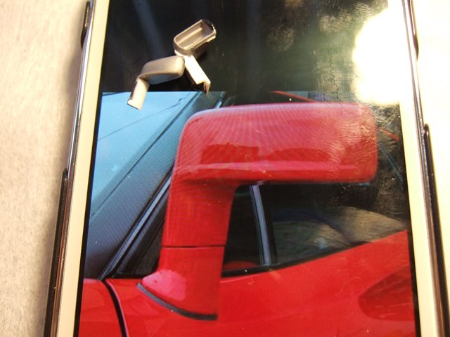

I choose Revell's mirror. Fujimi's are too small. But still Revell's mirror stay were too skinny.
So I applied 0.5mm plastic papers on the stay, as you can see.
Using files and sand papers, the mirrors were made to be preferable shapes.

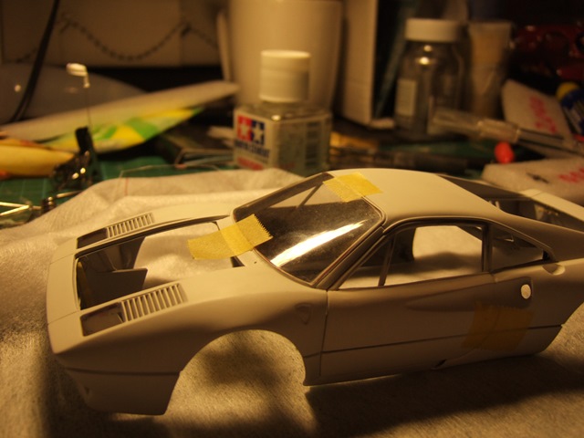

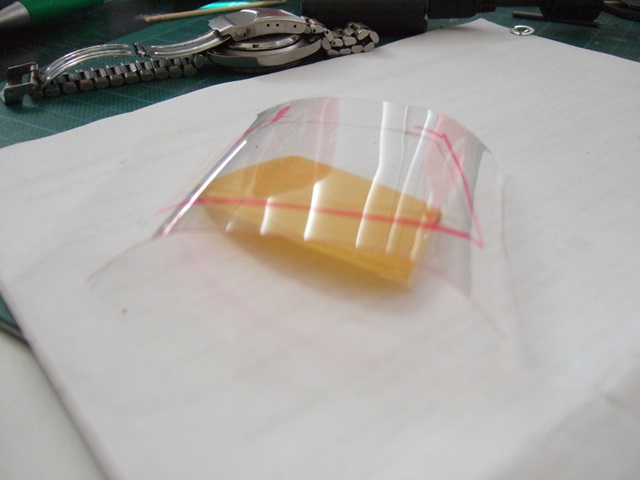

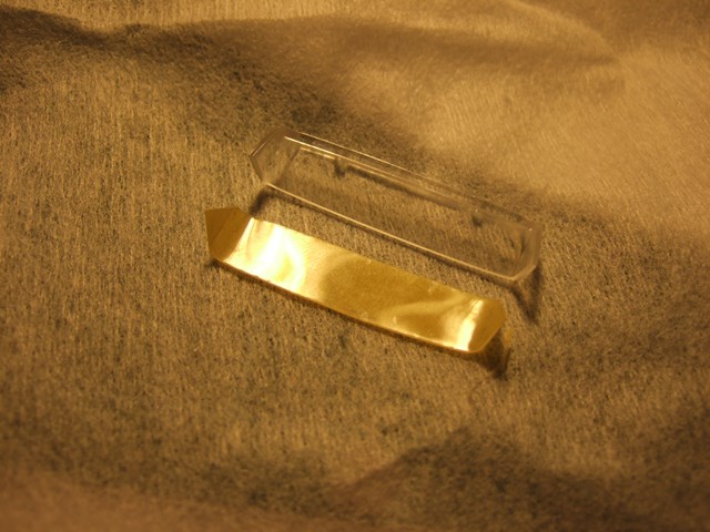

Then front window. I don't use the "heat press' technique (don't say I have no press machine), but simply curved by putting in boiled hot water (of course I curved after taking the part off from hot water). I used 0.2mm transparent plastic board.
It took nearly 2 hours to adjust it.

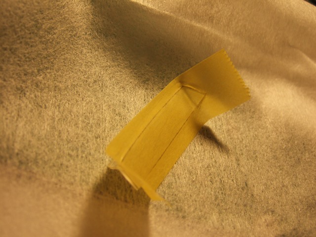

Copying the rear window's shape to the masking tape...
I used the same technique on the rear window, by putting it in hot water. I believe it's much easier than the heat press.
The side-rear windows were a bit easier. 0.3mm white plastic papers were glued onto the 0.2mm transparent plastic board.
Then curved in the same method. The transparency is much better than the original parts!

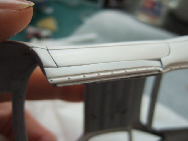

Still sober works continued before painting the body. These tiny small things were cut from plastic rod.
Pointing the preferable position by using the maker...
The tiny small things were glued with acrylic bond.
I sanded on top because I found they were a bit exaggerated.

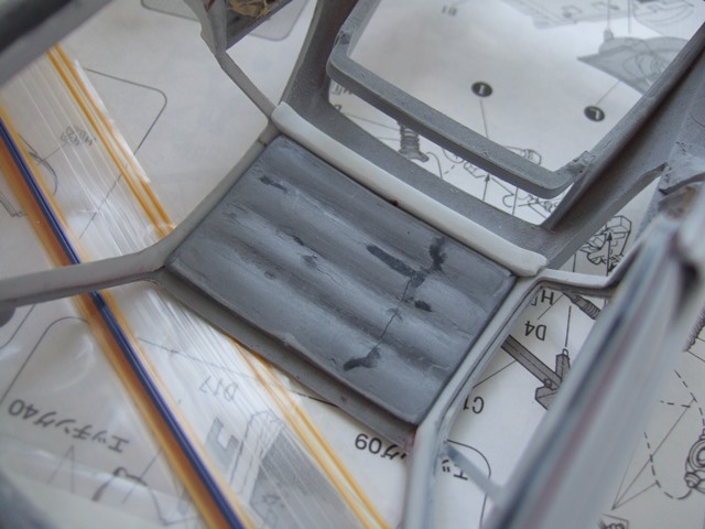

The ceiling was originally from Revell's transparent part. Putty and sanding were applied.
