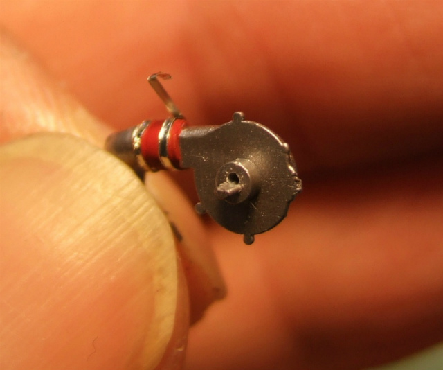

Nuts and "burnt" color (mixture of TAMIYA enamel clear orange, flat black, clear and flat base; I can't remember the ratios, but maybe 8:8:8:1, I used the brush) were applied to the exhaust pipes.
I don't even know what this part is for, but I thought I needed to make this. They are, maybe 1.5mm (2mm?) plastic rods and the blue pipe is my daughter's broken hair band; light blue applied.
And the hose clip is from KA Models, also insect pin as the nut which was cut after this photo.
I believe this part gives mechanical atmosphere to the engine bay. Please someone, tell me what this pipe is for and where the blue hose goes???

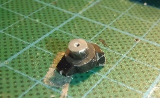

Plug covers were from 0.7mm (inside is 0.5mm) brass rods so that I could put 0.5mm plug codes and painted in black.

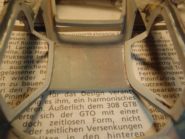

This is Fujimi's frame. To be fitted horizontally to Revell's chassis, 0.3mm plastic boards were fitted; white part.

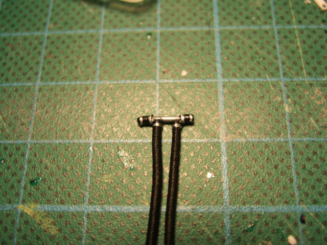

...Once I started to use the insect pins, I became insect pins addicted. The black hose was from price tug bands attached to my daughter's shoes. Maybe some hair bands have the same textures.
Using plastic rod and the bands... (small holes were applied on rods so that I could attach the bands easily with CA glue.)
Now you can see what this part is for. I used the same bands for both sides of the rod. The silver lines are aluminum foils and silver paints.

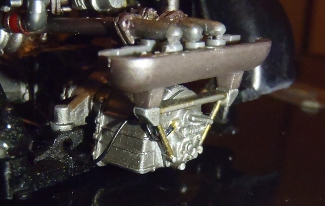

Oops, I haven't mentioned about exhaust pipes from engine.
No wonder Revell's exhaust pipe looks better. so I did lots of cuts and pastes to fit it to Fujimi's engine.
(...I reckon the engine won't get high power with Fujimi's exhaust pipe.)
The engine was temporary set in the frame to raise my spirit. Wow, they look really cool!!!

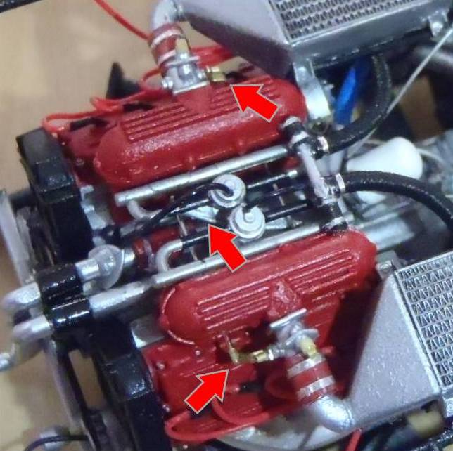

Still I'm looking forward to the answers where are the hoses goes to... I know it'll be a difficult question though.

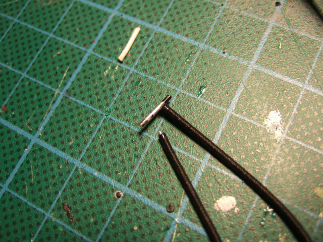

The band (same as the last post ones) was applied to this part. Connector parts were from ancient MODELER'S plugs and connectors set and plastic rod.
Still, I don't know where this black pipe goes....

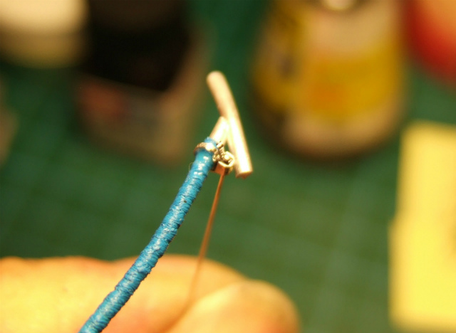

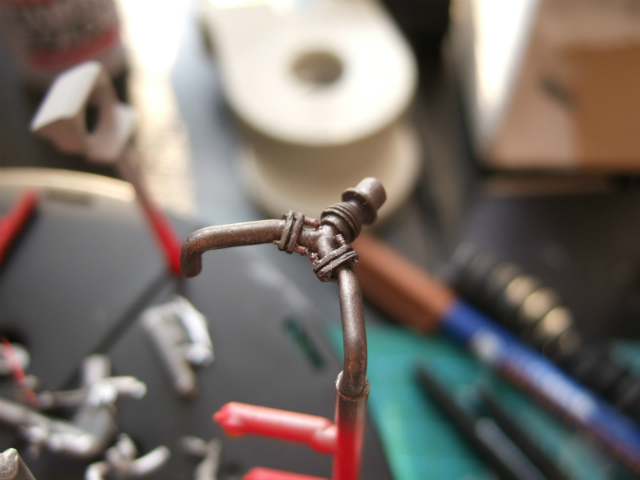

Every pipe has nickel silver rod or pin hole to be settled together in proper position. Without this works, I don't think I could assemble these pipes with enough strength. These rods were also convenience when painting. Of course they were cut short when assemble.
Hose clamps were from ancient MODELER'S "Metalook". Of course we can find several foils like this now.
These were also troublesome and irritating works, but now I got used to these kind of works. Once you think 1/3 to 1/2 of trials will be the mistakes, you would never give up when making mistakes.

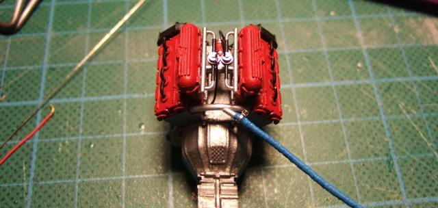

Plastic rods were applied and cut to set the inter coolers horizontally. Heights and stay positions adjustments were needed.
For the piping, I decided to set the inter coolers firstly, because those are the most impressive parts in the engine room and have to be settled in proper positions. Then the other pipes were adjusted according to the inter cooler's positions. Of course there were lots of cuts and pastes on the pipes.
I checked the position not to touch the engine hood. It was OK.

Other pipes were applied. Nickel silver rods, brass pipes, steel wire, plastic rods and so on. I made holes for every pipes to be settled. Sorry, I know this expression is too rough but I was concentrating too much to take pictures.
The black pipe from gearbox is from MODELER'S plug hose (painted in black).
The progress so far.

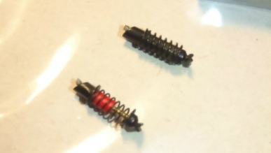

Assembling the shock absorbers.
I replaced the spring section to 0.3mm nickel silver rod, the dumper to 3mm plastic pipe and 1mm brass rod. Just because I thought these works were as easy as masking and painting, and would lead a much better result. (This picture is for the front suspensions)
I coiled the nickel silver rod to plastic pipe, then stretched and cut to a certain length.
Then painted in these colors.
I didn't glued the brass rod and pipe but only the end of the spring so that this part has the mobility to fit in the right place without adjustments of its length. Right one is the original part.

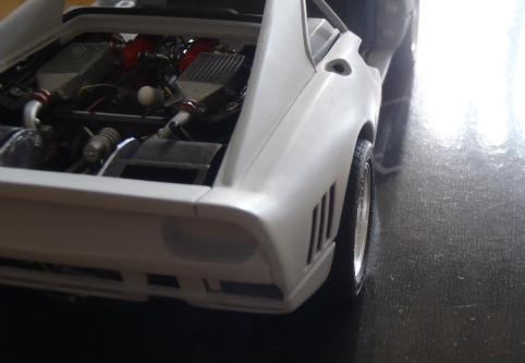

The rear shock absorbers were fitted. I had been afraid if they would obstruct the air cleaner pipes, but they didn't. Lucky me. The upper arms and the brake system sections are from Fujimi. Fitting the tires and looking the balance with the body, I tried several times to fit them to the right place.

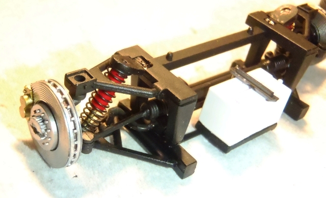

Mainly out of box of Fujimi. I of course used PE brake disks. The gates (seam lines?) on parts were treated after this photo... taking photos, lots of mistakes are shown on them.
To fit into the width of Revell's body, I sanded this parts about 1mm on top and the second-top to set the brake disks in narrower position. Mmmm, hard to explain. Anyway, I had to make the width narrower about 2mm in total.
On top of battery, I attached EVER GREEN "H" plastic strip. I cut it in the shape of "T" then applied. On each end, I put insect pins. And the codes (MODELER'S 0.45mm) applied.
Now ready to temporary set to the chassis.
PE brake disk and modified suspension gives good atmosphere.
The battery came to the right place. Inside the battery, I set a small magnet so that the rid (it also has a magnet) can be settled without glues.
The height of front section was adjusted by sanding the chassis.

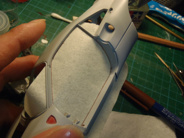

I thought I have to treat the gaps around front bonnet.
I glued 0.3mm plastic papers on both sides, then fulled the normal putty.
You can see the difference of colors on right and left edges. Don't say I've got to treat them earlier. (Of course I should)
Then I applied moving section on bonnet. This picture is the temporary one, I will cut the upper excess parts on bonnet.
Followings are how I made these moving parts.
I made 0.5mm hole in a 0.7mm plastic board, then inserted the 0.5mm brass pipe. This part will be glued to the body. From my experience, this part should be as front as you can, so that the moving width would be bigger (so that the body and the bonnet wouldn't hit each other).
This (right small one) is the part on bonnet. The 0.5mm nickel silver rod will be inserted into the pin hole. I am using the number plate part from Fujimi's box, just thinking it is thicker than 0.5mm plastic board.
I made lots of tries and errors on this stays (0.5mm nickel silvers). If they were too narrow, the bonnet and the body hit. If they were to large, the bonnet wasn't fit in the right place...
After some attempt, I found the right place to fit them in. Now I think I could use 0.7mm rods and more thick pipes for more strength, but I don't have guts to redo this job now.
Move to body modifying..
I should do this works earlier, now I can tell.
Using 0.5mm plastic board...
Then glued and sanded to the right shapes.
These parts are not only the gum packing inside the doors, but also they give strength to the body. Oh, I should make the ceiling parts as well... still long way to go.
The interior tub had to be sanded to fit in the packing parts. Again, I should do this job earlier to make things easier.
Anyway, things are proceeding little by little
That's all for today, have a nice Sunday!!
