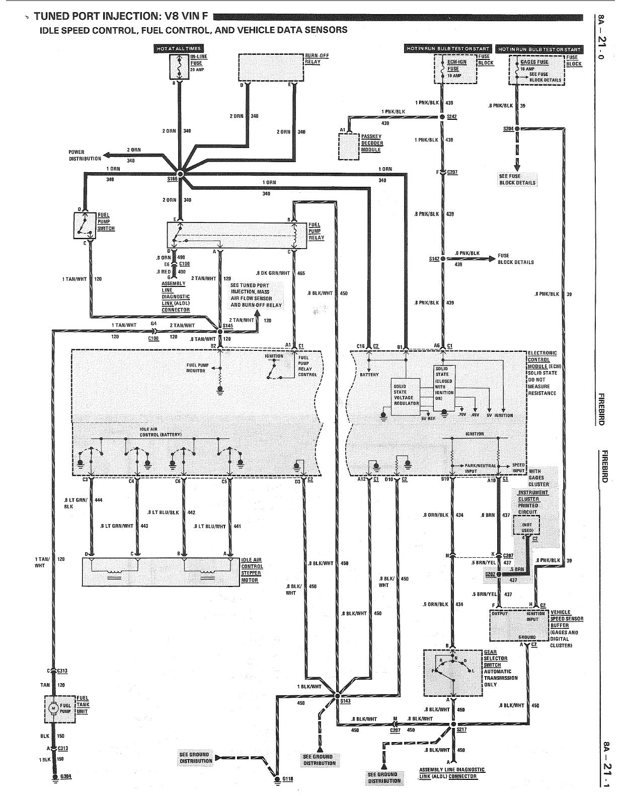

No. This is NOT a Ford. The auxiliary oil pressure switch is not a shut-off, but a redundant path for pump power in the event of relay or ECM output (quad driver) fault.
This comes DIRECTLY from the published General Motors service manuals. No soon-to-be-unemployed "expert" teaching tech classes will change that reality.
www.wwdsltd.com/files/F-CarFuelPumpPower.jpg
Most other GM applications are conceptually the same, with variations for terminal and/or connector numbers, routing, and circuit numbers depending upon the specific platform. CK classics, moderns, B-cars, D-cars, F-cars G-cars, Y-cars, Lambdas, P-bodies, and just about anything else GM made did NOT follow the "Ford better idea" of an oil pressure shutoff. That was started by Kohler and Briggs & Stratton, and Ford clamped onto the concept because they know those two were better products.
The only exception to that is a handful of V-6 installations in a very few sedans.
Further, anyone qualified to read a simple schematic diagram should be able to understand that the paths are parallel, not in series, and the ramifications of that. If not, please refrain from repeating incorrect information simply because some other source commented on the internet.
