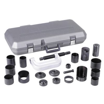

From his description I think he has the standard ball joint/U-joint press rather than the master kit you show. The master kit, along with experience using it, probably would take some of the work out of it. It's nice to read though what to expect when using the standard kit such as what is typically available as part of the Loan-a-tool programs.

I agree, I was just illustrating that there are tools that don't have to be "made to work with effort".

The ball joint goes in at an angle that makes the typical press (even the one you show) very difficult to use. Because of the angle, there isn't enough room on the spindle side of the joint to position the cylinder and disk from the kit in the appropriate way. A $65 special cone shaped tool, that is good for the Taurus and almost nothing else, will make short work of it. I found a thread here on the forum that describes how to make an installation tool from pieces of pipe, but most people don't have access to a wire welder. I considered following the directions and making one, but it would have taken more time to make it than I spent using what I had. Mainly, I was trying to provide assistance for people that are weekend mechanics such as myself and can't afford to spend a lot of money on tools with very limited applications. Incidentally, it took me less than 15 minutes to press the joints out and install the new ones with the method I described (at least on the second joint).

The angle isn't the factor. the surfaces that the joint mates to are still flat. If you flip the tool over so that it is pulling the joint into the socket there is no clearance issue with the part of the knuckle that the strut sits in. With the basic ball joint press this is impossible because shaft of the joint will interfere with the adapter so you are forced to use the tool to push the ball joint into the socket so the shaft of the joint can move through the hole of the adapter and press. With a master set there is an adapter that is long enough to allow you to pull the joint into the socket without any clearance issues. This eliminates the angle factor and allows the joint to be installed straight easily.
I'm not criticizing, your step by step is very detailed and right on I'm just saying there are tools that make this easier.

I must admit, I ran into an issue on my wife's Lincoln LS very similar to what Doug describes. I cut my losses and, even though I already had the bare ball joints, I ended up buying a new knuckle and hub assembly. I have the 3-in-1 kit (not the master kit), a 6 ton hydraulic press, welder, several fabrication tools, but there just was no way I was going to be able to get on the ball joint straight enough to apply the force I expected would be needed to press the ball joint out without risk to my health. I was able to buy the new OEM knuckle and hub for less than an ambulance ride.
I've not used a master kit and don't doubt you Airjer that there probably is an adapter that would have taken most of the work out of it, but I'm still impressed that Doug was able to solve the issue with what he had, and I'm sure he was proud of his accomplishment (as he should be). Both you and Doug have created a valuable thread here. If someone plans to do this type of work on modern cars and don't already have several tools to do so, take Airjer's advice and buy the master kit. It may save you a few hundred dollars the first time you use it. If you already have a tool that may do the job, don't give up (but be safe). These are the kinds of feedback that make these forums so valuable, and it's great to see people investing so much time to help others out based on their learning experiences! I know Airjer did not post with the intent to criticize.

Their is a special adapter for Ford Taurus. O'Riley's parts stores have a loaner tool for your use. Lisle's and Moog, and OTC have adapters.
http://www.amazon.com/ Search OTC-8032A,OTC-8032
http://www.tooltopia.com/ Search LIS-45450,OTC-8032A,OTC-8032
