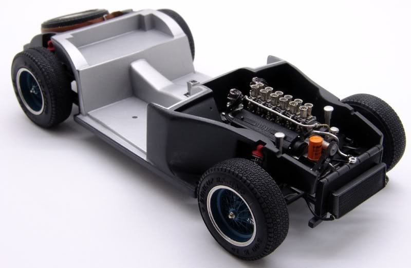

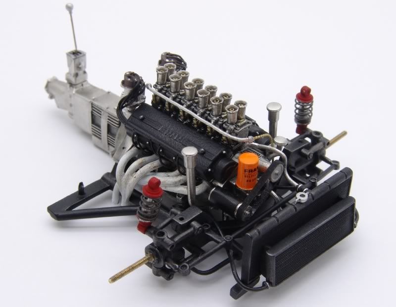

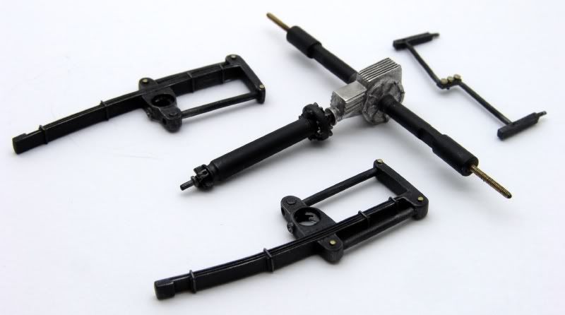

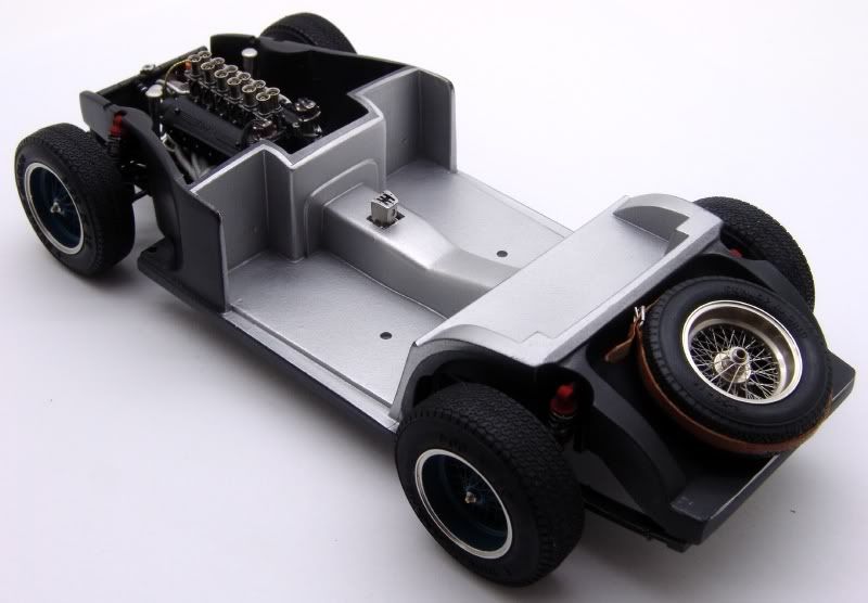

Time for another update folks!?Front subframe was mated to the engine, which was in its turn mater to radiator and oil cooler. Added all little details - oil filter decal, belt, stabilizers, plumbing, shocks, exhaust manifolds, shifter, etc...?Dashboard was painted "crackled black", and detailed. I also added circuit board made from scratch + some wires.?Mr. Hiro was kind wnough to send me another front wheel set so I col build a spare wheel. Only 750 Yen! ?I also fitted brake rotos with calipers, drilled them for brake lines, assembled sock absorbers.
Gas and oil tanks were carefully cleaned and sanded, drilled for outles, and fitted with scratchbuilt filters, lines, and fittings. Screws used on fittings are from old wrist watch! Lots of goodies there....?Rear suspension with differential, leaf springs, and Watts linkage...?And finally, powertrain assembled!
Then all this was put together in a chassis....
Wheels are on...checking the stance...looking good. Interior is next!
