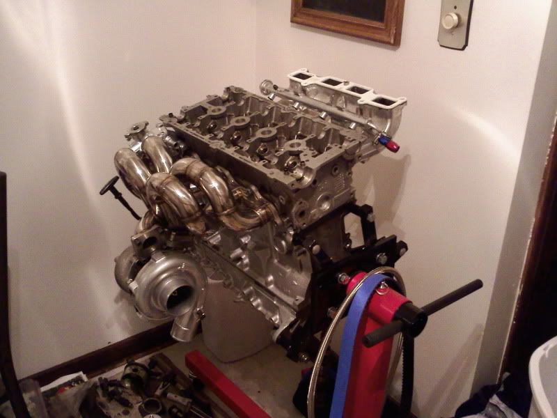

Damn, that shits sexy man for real. Hope it runs good as it looks, if so it'll be a beast. What brand is that manifold?
Also, it looks like the external wastegate tube/flange is right at the turbo....or do you just have the turbo on backwards?
Caleb
vanilla gorilla
'99 Spyder 2.4 5-speed - Red/black,14b,slow
'96 Eclipse GST 5-speed - Paint
www.myspace.com/ballsoutperformance
  #113
Old 09-26-2009, 01:13 PM
david-b's Avatar
david-b david-b is offline
Dave is THAT guy
Join Date: Nov 2003
Posts: 6,868
Thanked 7 Times in 6 Posts
Re: david-b's 95 Eagle Talon ESi-T Motor Build
It's OBX brand. There's mixed feelings about this manifold but the price was right. Cheapest I've ever seen it for. Worth staying up late one night to win this shit.
Ya the WG runs right into the compressor. I think the turbo is too big Going to try to make a flange and use a little curved piece going up and around. Not sure how well that's going to turn out. It's a 4-bolt 40mm WG, but still going to use my Tial 38mm.

Can you have someone heat up the wastegate flange and just bend it up a little bit more so it will be easier to flange up the wastegate?
yea i figured it was an offbrand manifold. Its purty as hell but i didnt see a brand tag on it. Theres always mixed feelings on cheap manifolds, well turbo ones anyway. As cheap as it is its worth the try i guess. I ran 2 pacesetter mild steel manifolds on my car and they both cracked after a month. But yet pacesetter makes great headers for v8s. So you never know.
ned
I really dont think that that can be bent.

Your probably better off cutting it and turning it to a better angle, heating the metal enough to bend it would mess with the strength of it in that area

Ya I'm not going to try to heat it. Figure it may mess with the structural integrity of the piece. I ordered a flange and going to fab up a little extension piece. It may have a weird angle coming off of it. It's hard to find pics of this thing installed since not too many people have it, so I can't see how everyone else does it.

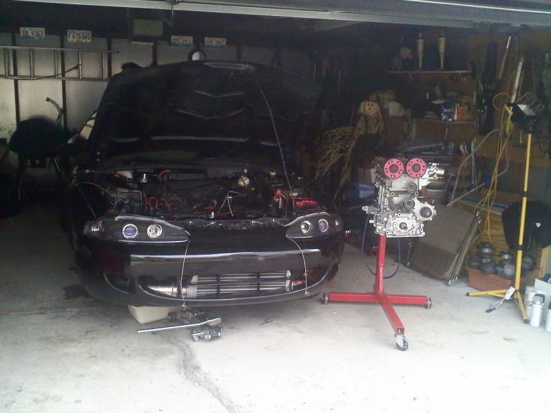

Talon made it the garage today.
Got pretty much everything pulled that I needed. I can't get the crank pulley off the old block and ended up cracking the UDP so now I have to buy a new one. New motor is together and nearing completion.
Where she sits now.
