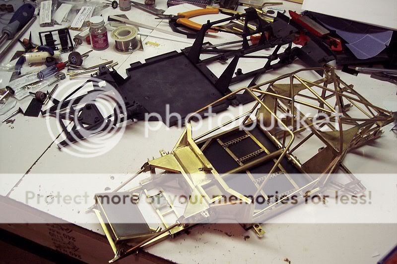

Here is a comparison photo of the kit frame in black plastic on the left and the brass frame I made on the right. Actually, there is no comparison, as you can see.
Now my earlier post about the kit being very mediocre should make more sense.
BM1

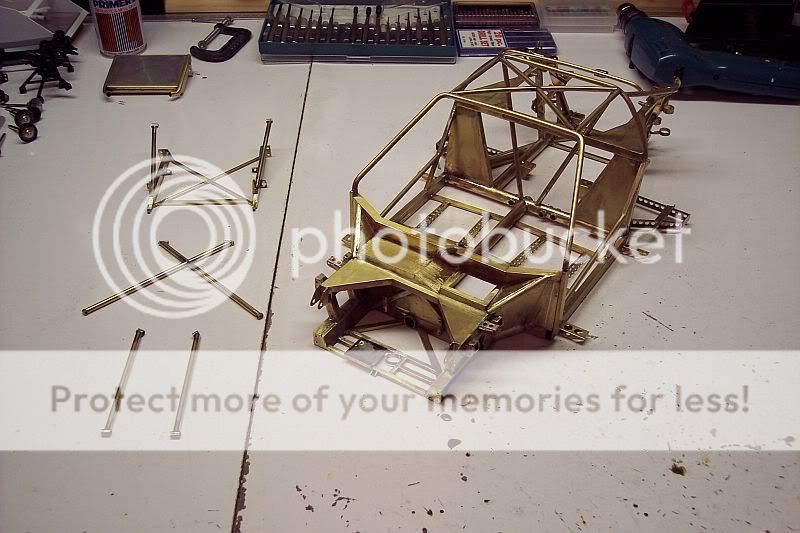

At last, an update! Unless I have missed something, I believe the frame is finished!!! I still have many hours of prep before the main frame goes to primer, but some of the sub-assemblies are ready and I even got some pieces prepped and primed tonight! I also received my Brummel decal set from Manfred at m-tec, today, so I snapped a picture of them also. Enjoy!!!
As always, thanks for following!!!
BM1

Old 02-17-2009, 11:52 PM
tuned.by.twenty's Avatar
tuned.by.twenty tuned.by.twenty is offline
AF Vendor-TBT's Owner
Join Date: Jul 2008
Posts: 940
Re: Pocher F40 WIP
That frame is art! I can't wait to see it primered.

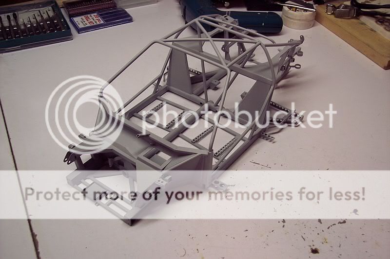

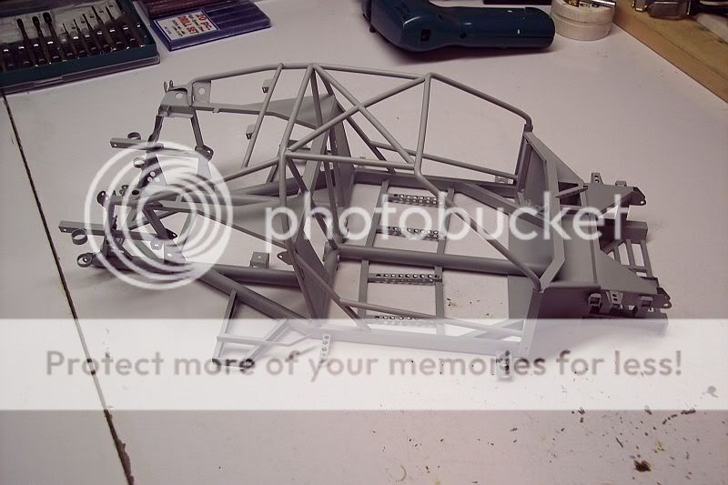

I'm traveling this weekend, but I couldn't leave everyone without the latest photos to look at. Got the frame prepped and shot with 1 coat of primer last night. Still some thin spots and there will be some filling/sanding to do before color, but hey, at least it's grey now! There was alot of real estate to cover with primer... I realized that this frame is big, once I started to paint it! Enjoy!!!
Thanks for looking and have a great weekend!!!
