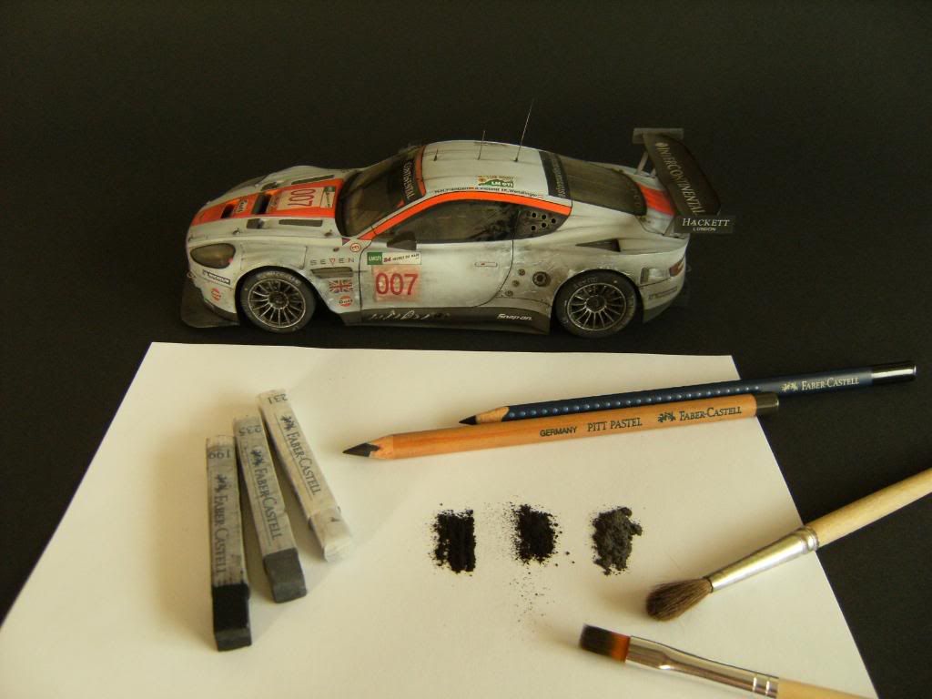

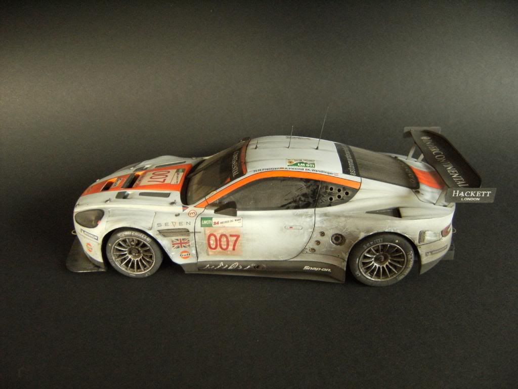

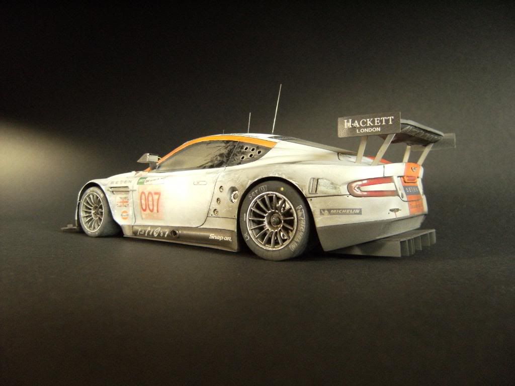

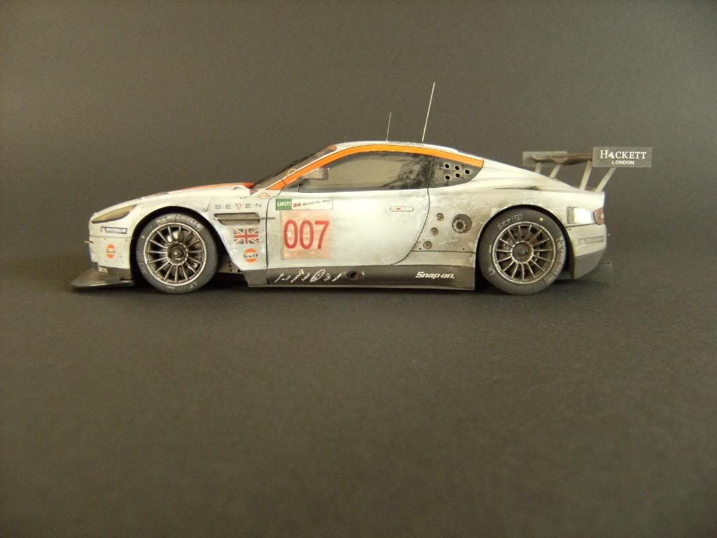

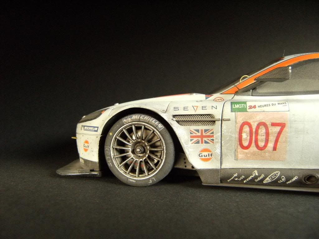

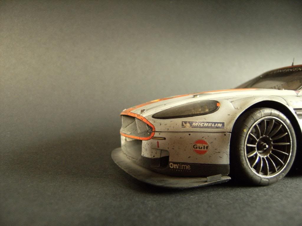

Back for dirt.....
Finishing sessions took me quite a while, it's almost done, only two or three more sittings for the whole thing in general.
Gents, i feel my energy fading away little by little on that i can tell you that....BUT i do love it still.
I'm also working on a nice little base plate with a small peace of race track on it and a corresponding appealing tag.
Dust was simulated with grinded pastel chalks in various tones, applied with different brushes and several pens came to use for the right look of the battle scarred front and the engine bonnet. The tires are not fixed by now thats why the brakes are not where they should be .......
I have to say that i'm not really happy with any of the pics i took.......dammed i don't know. It looks so cool in flesh but not one of the pics show that. Ok, here's my interpretation in scale of the 2008 Le Mans running Aston Martin DBR9 no. 007.

Very cool work again Jochen. The weathering looks very realistic to me. I like the little details like the dirt being wiped off the side window where it must have been touched during pit stops ( although i think they should have given the driver better visibility and clean the whole thing :-)
On the other hand it hurts a bit to see your painstakingly enhanced tires covered in dirt...
I'm still in "all glossy" mode i guess and have yet to master that task before wanting to build dirty cars :-)
