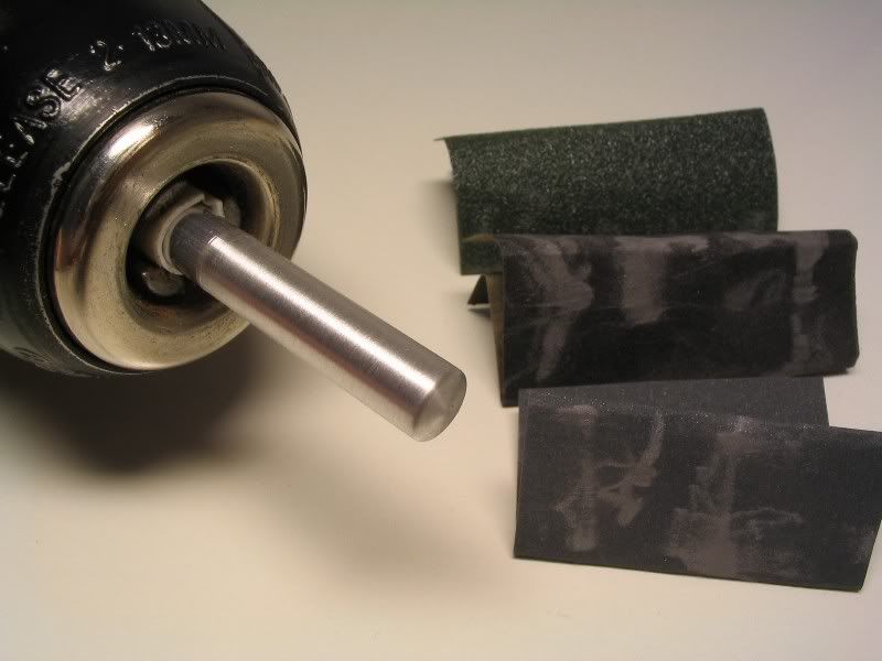

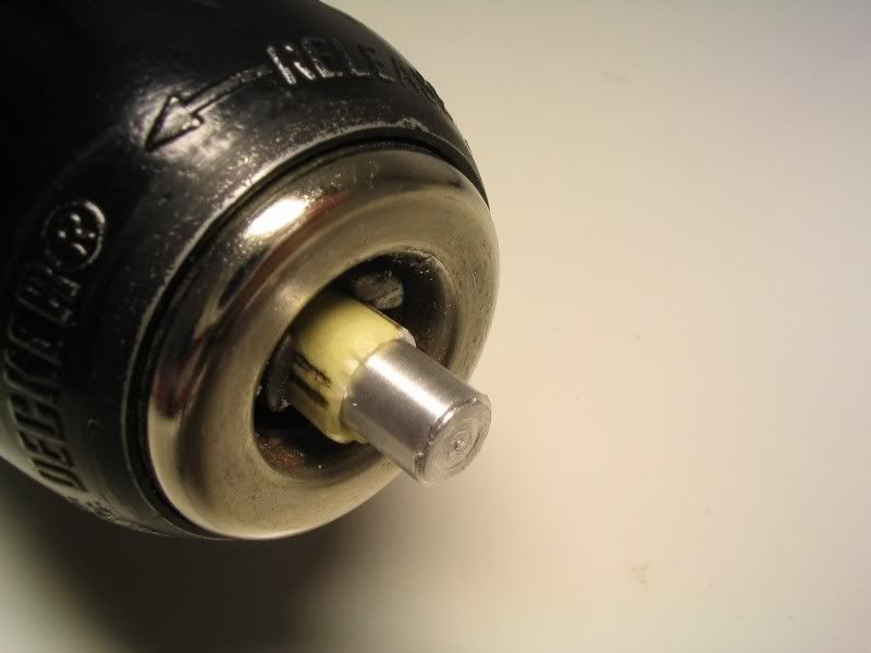

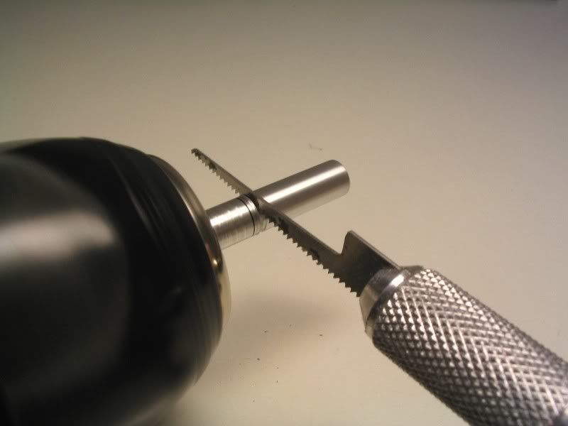

“So, what shall we do with this fire extinguisher ?”. This was my friend Alessandro yesterday during a phone call, he’s also working on a Challenge. In five minutes we declared that the kit part is horrible and there are no offers from the aftermarket…
When I saw the F1-2000 progress from Mr. Kamimura, last year, I’ve been impressed, among the other things, how he scratchbuilt from bare aluminium rod, some fire bottles using a motortool. Hmmm…

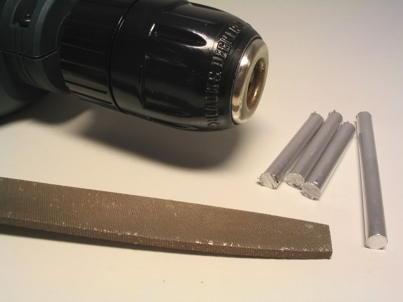

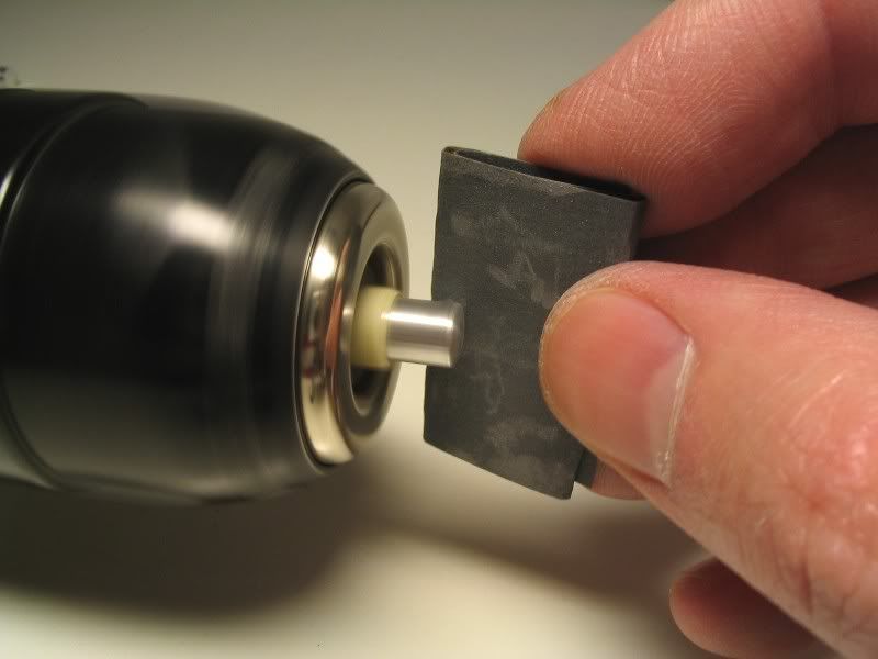

So I bought 1 meter of alu rod dia. .23”/6mm and cut in pieces (1.55”/40mm). A drill, a file and sandpaper
To avoid surface damages, I wrapped some styrene around the rod and fixed in the drill. At a rather high speed I started filing the rod to obtain a perpendicular cut. Then with the file again I gave to the rod a little rounded shape. I refined it with sandpaper #150, #600 and #1000. And this is the first side of the bottle
I traced the length (a little more) where to cut the rod
and started cutting
At this stage, I removed the unnecessary piece from the drill and installed what will be the bottle with the finished side in the drill, always protected by the styrene
and repeated the same filing procedure above described
and this is the result

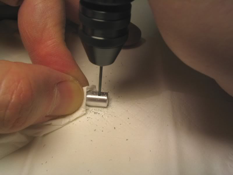

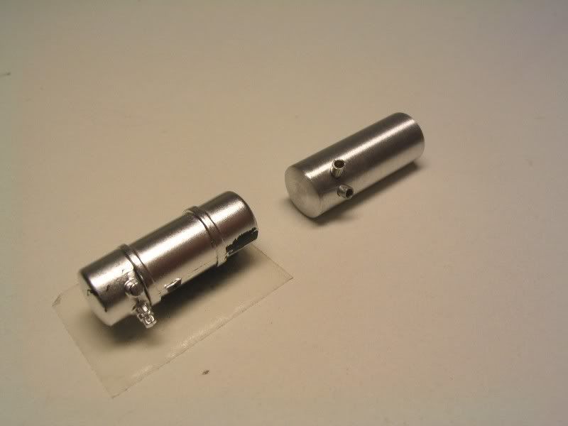

Using the kit part as reference, I drilled out two holes .051”/1.3mm on the bottle

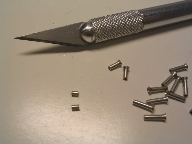

and some cable terminals (is it the right word ?) to detail the bottle have been used
These small pipes have been hammered on the bottle
Strap, caps and cable will added for further detailing. Despite this part will be almost hidden once installed, I’m really pleased with the result, considering that it was my first attempt on such topic.

Cool, another update. Looks good Robi, I have tried that with a moto-tool but eventually gave up and bought myself a lathe.
What are the cable terminals for (in real life) I have never seen those before and I could use those kinds of tips for various things.

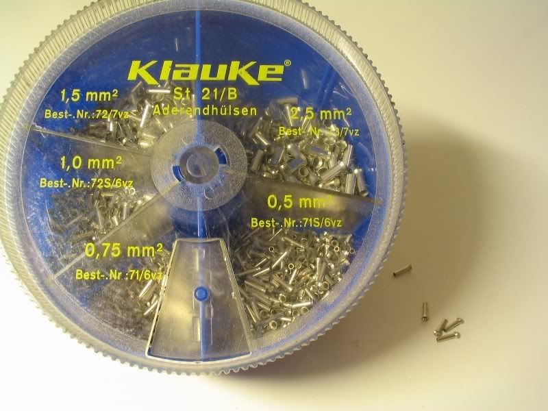

Mike, I have seen them used on the terminal boards of industrial control cubicles and CPU connections
Those have been a gift from a German ex-colleague.
Robi

Originally Posted by Robi J
Don´t tell me these things are called "aderendhülsen" in Italy as well, or where did you bought them!?
Julian

Originally Posted by DasWiesel
Amazing detail work!
I don´t think so... In Germany there is a home store called "Prevo". There should be some to find.
I only know Pivo , never heard of Prevo!

DasWiesel > In Italy these things are called “capicorda”. Anyway I got them a few years ago from a German ex-colleague, as gift. I guess, but I have to verify, that should be found in the electronics shops.
