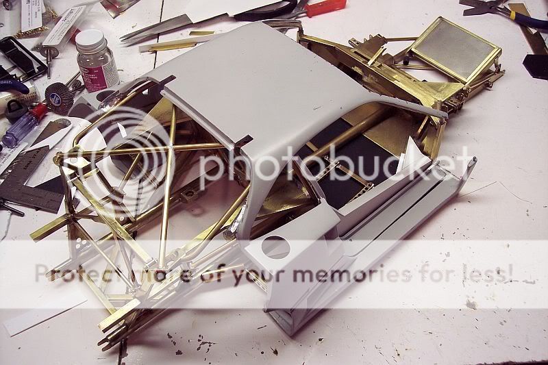

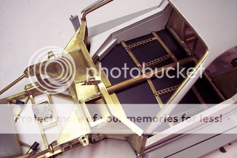

A quick update before I turn in... got some interior work done tonight. Lots left to do, but a good start...Enjoy!!!
BM1
