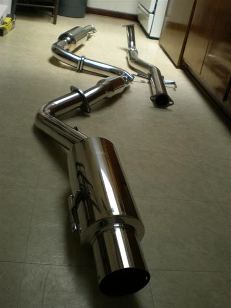

Re: david-b's 95 Eagle Talon ESi-T Motor Build
***Update***
Been making it happen, here's what's new:
Exhaust
-Got my 2.5" - 3" GST downpipe this weekend. I'm going to cut it up so it'll work with my car.
-3" cat-back came in. Huge 4.5" muffler tip on this thing. It just looks massive
-Have to make the turbo to DP sectional piece, so have some 2.5" pipe and flanges/gaskets coming in
-New rubber hangers and O2 bungs are all on order. Don't know what size the EGT bung is though.
-New WG flanges/pipe coming in
Hopefully I will do the exhaust this weekend if it's nice. I'm going to install a V-Clamp off the turbo at 2.5", then it's 3" after the flex pipe. No cat this time! Since the V-Clamp sticks out off the turbo even farther that just the flange and pipe, I'm going to move the Wastegate a little. You can see in the pics of my engine bay, the exhuast comes really close to hitting the WG pipe. So the WG will be on it's own little pipe sitting away from the exhaust hopefully.

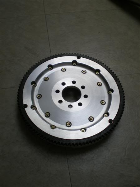

Clutch
-Fidanza 8lb flywheel comes in today
-ACT clutch is already sitting at my house. After doing some reserch, it may be the wrong clutch though. We'll see once I get to the flywheel tonight. Won't be happy if it's not what they said it was. Is rated for ~412lbs of torque. Should be good enough
-Have to order longer Neon flywheel bolts for the new setup.

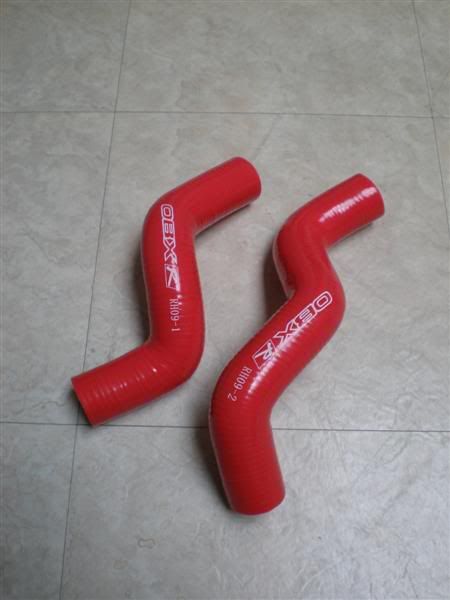

Little stuff:
OBX Radiator hoses
Fidenza Flywheel
3" N1-style exhaust
