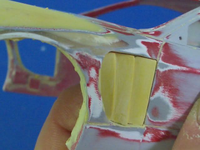

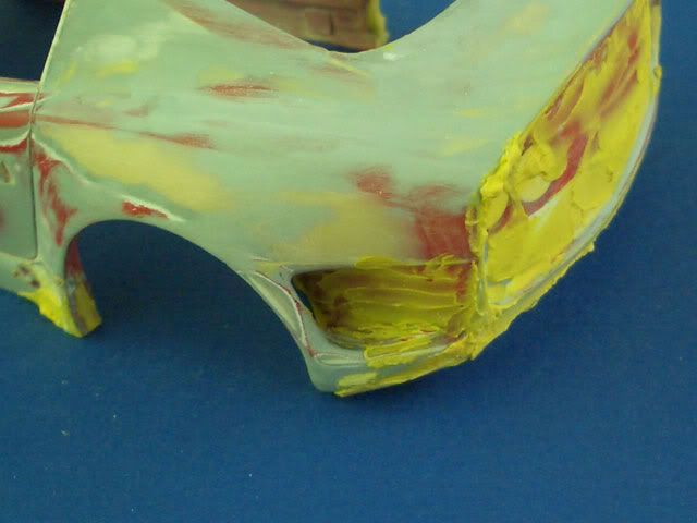

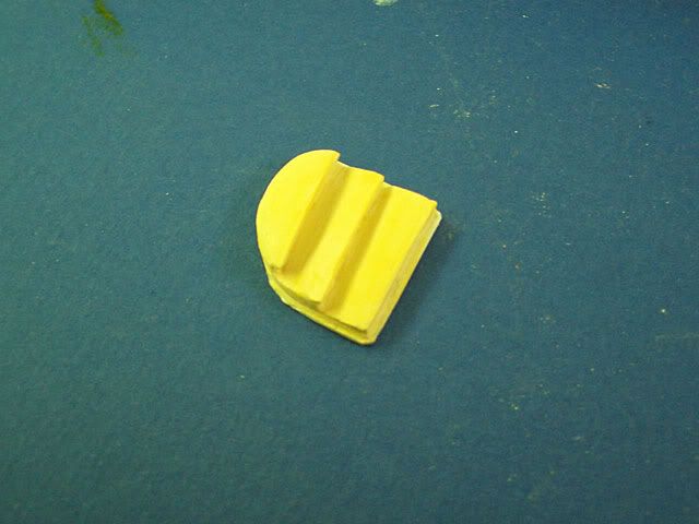

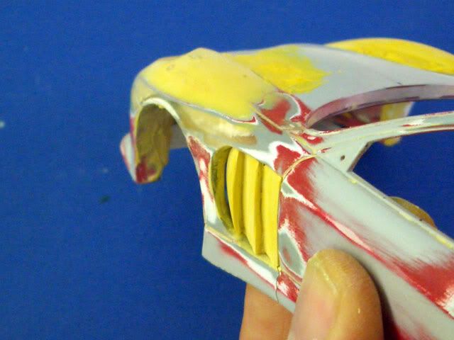

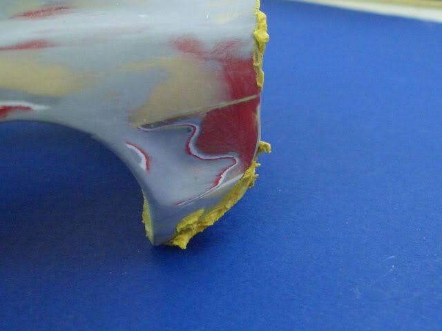

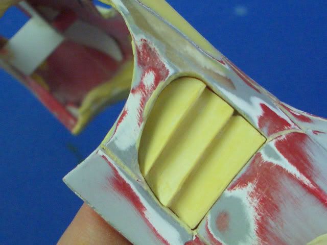

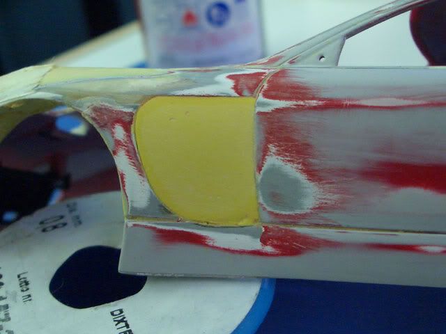

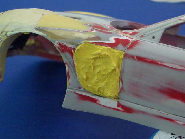

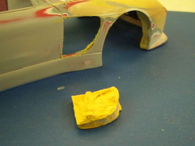

BBBBBUMP! This time is me!
This build make me to think about. I called GTO but she has nothing to do with her '62 grandma... Now a less more Really now would be a bit hard recognize that she's based on a Maranello... isn't it?
Let me (gio the modeler) to show how I'm trying to kill my alter-ego gio(nny be good) with Morimori fumes.... the worst smell you'll ever feel... bullshit smell like violets aside... ROFL

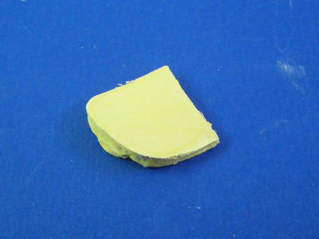

Guys I wannot to show the whole thing's design now becose it would be in primer>painted in few days (hopefully) and you'll understand better then. Anyway I wanted to share some Morimori tips, despite the infamous smell it's amazing, I feel it better than any other polyester putty I tried, and it have a kind quality: after 20-30 mins (depends of the kat %) you'll cut with a cutter like a good compact foam. Day after is rock.
First times may be hard to find the right formula: it would be catalised at 2%, so I used a squared paper 10x10 squares + 2 for Kat. After a couple of Kilos used I mix it by the color: the putty is grey, Kat is dark yellow, a good mixing ratio would be medium yellow. Too simple to do than to explain.
Let me show: enough words in my crappy english for today: new side vents:
(Sorry for dirty hands "We're working for you" ROFL)
Rear vent: (before>after)

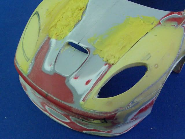

After dozen of drawing attempt I choose the headlight shape, I tried oval, squared... they're now in the average
More to come (hopefully... I'm creating by myself something wich I don't know the final result... ever if we'll have a final result LOL)
gio

Hi,
great to see you working on this model.
The vents behind the wheels look good (another opportunity might have been the SLR vents), rear vent also makes it GTO-like
Micha

Gio, rear vents and re-done rear deck looks great! I'm not such a big fan of the fender vents, they look awkward in the front, against the wheel opening... I'm torn on the headlights - they look nice, but too round for this shape? Great to see you working on it again though.

Gio, Love the rear vents, they are tops! Front vents do not seem to flow to well. I am no expert, but the initial surface that is cut from the body does not support the vents well. They almost need to be parallel to be more effective. I think that this can be achieved with the wheel arches. I dunno, I don't mean to deter you as you are always doing extravagant ideas. What ever comes of it, this is a work in progress. Anything out of the box is great for a lot of, literally.
