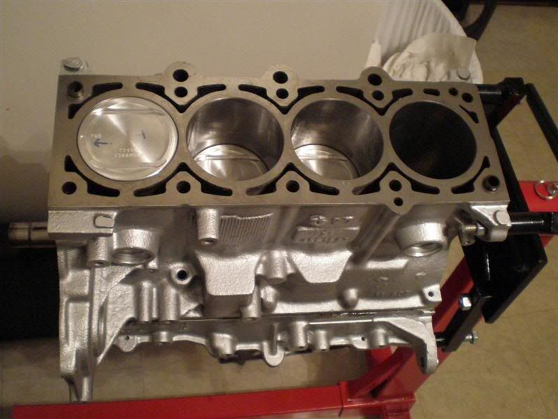

Did some work today. Got 3/4 pistons in.
I have a question. When I turn the crank by hand, should it be super smooth and easy or should it be a little rough?

Re: david-b's 95 Eagle Talon ESi-T Motor Build
They aren't ball bearings so the crank isin't going to turn super smooth. I wouldn't worry about it

Good. It just seems that you can hear the rings against the cylinder walls (yes I oiled them) pretty well, and when everything is mid-crank (all pistons same height), it seems to get hard to turn at that point. I'll get that last one in tonight then. I have to say, this is fun.
Also, what was the final torque specs on the caps? Manual says 20lbs/ft and then to 90lbs/ft. I threw out the boxes for the rods with all the papers yesterday (dumbass) so I don't know if they should be different. Was going for 90 and I can't because the stand keeps moving all over the place once I get past like 70lbs

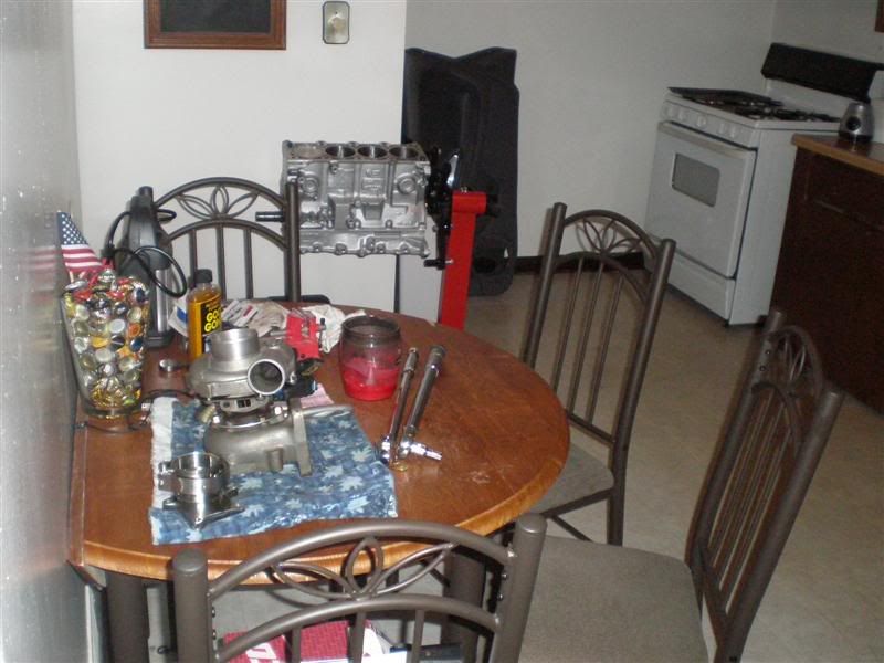

Also you can see in the pic of my kitchen the turbo is all back together except for the compressor. Still going to get that polished/painted soon and won't bolt down until on the car. Also next to it is a 2.5" v-clamp that I got off eBay for pretty cheap. Would have been cheaper to make my own, but this one is all polished and looks nice.
What rods do you have? Be careful torqing those rod caps. Mine where only suppose to be around 45 ft.lbs and i got them mixed up with the thicker studs and tried torqing them to 75 ft.lbs. I never could even reach that torque spec bc the bolt streched like hell. I ended up having to replace that bolt. So be careful and find the spec before you crank the hell out of them.

Eagle Rods. Shit. I hope I didn't screw them up. That explains why it doesn't really stop. I'm off to find specs!
EDIT: Looks like I'll need a new set of ARPs. DAMNIT!

some of the bolts held 75 lbs and didn't strech but one did bad and then i stopped so I only replaced that one. You may not need to buy all of them. I think there is a strech limit so you may want to check that out

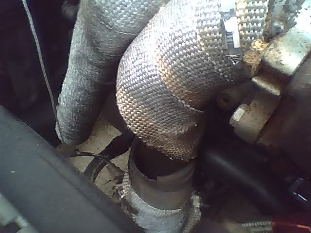

So this past week the car had been running like shit. I replaced the air filter (finally) last weekend and ever since the, the turbo has been super loud. Like any little bit of spooling was very audible. As the week progressed, I noticed the AFR was resting in the 16 range, and then last night and today, 17+. Also was getting a lot of misfires, died a couple times this morning, and just driving like shit. WOT was great though. Only thing I saw when I popped the hood was an exhaust mani bolt has started coming out.
Well today I'm flying home on the expressway and the car bogs, misfires, and is basically trying to die. EGTs go from ~1400* to ~400*. I then hear my downpipe hitting the ground. Shit. I was near my parents so I babied it home. Sounds like a big V8, metal scraping on the ground, and turbo making every sound very loud. Get there, and see this.
Downpipe ended up cracking in the middle and breaking. I didn't notice this because of the exhaust wrap. I guess since I made the DP sit too low, all the hits it had taken finally wore it out and just snapped. Only thing holding it on were the sensors and like 2 threads of exhaust wrap. Fun.
Well I redid it today. Was going to make a whole new one but since I'm doing that later, just welded up the cracked pieces back together. I didn't rewrap though... just painted it. Actually turned out extremely well. While I was in there, finally welded my hood pins to the radiator support (no more loose, rattling things), and installed the MBC. The MBC I can't seem to get the boost to raise up. Sitting steady at 5psi. Have to look into that, but car is running great again with no problems, 14.7AFR again and sounding like it used to.

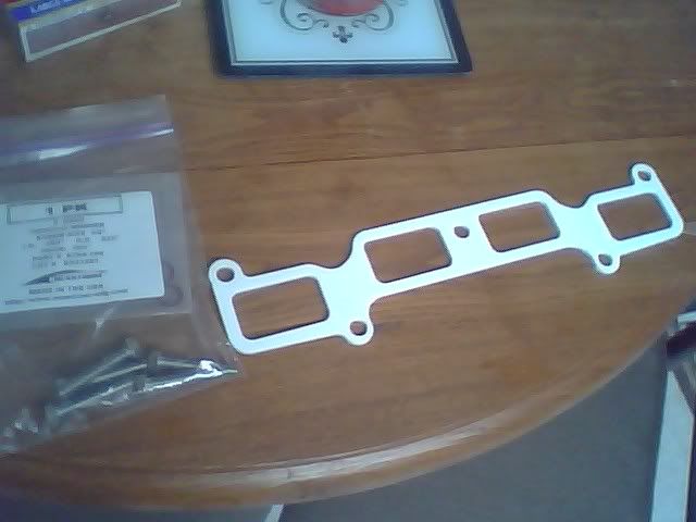

Last but not least, bought an IM spacer. Supposed to drop temps in the intake or something, and got the stainless steel bolts to go along with it which are also supposed to help. We'll see.
