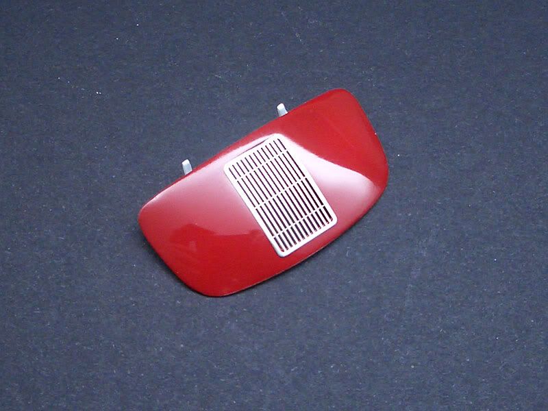

Thanks guys: done a quick polishing job, it need more patience for sure: anyway I wanted to start to share first PE jobs. PE are polished with MicroMesh and stick until 12K, than glued with 3M spray glue. Some spot was reinforced with thinned white glue. Back grill not glued yet. Sorry for picts but is very hard to have great focus on chrome parts, at least with my camera.

In the workshop
And a close up of the canvas cover: painted with maroon, covered by sand, both Vallejo air.
gio

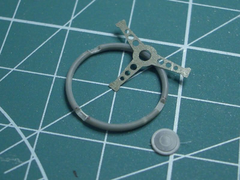

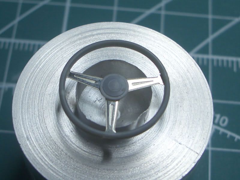

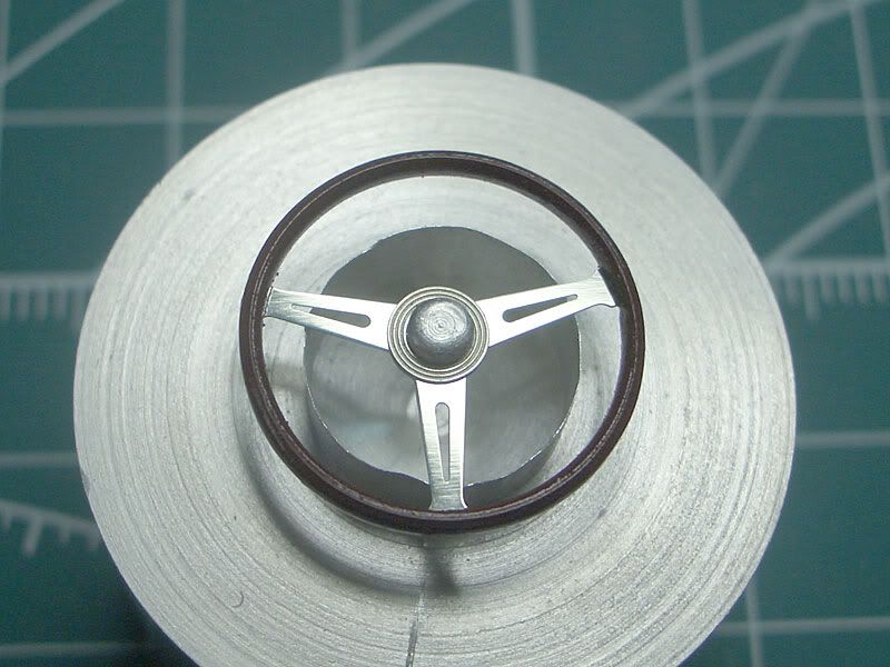

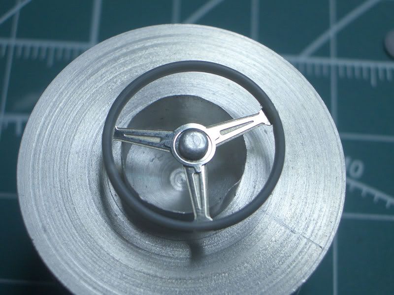

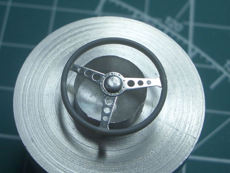

Done few other jobs on steering wheel, I polished and tried anything to be sure to do the right choice....never decided yet!
gio
