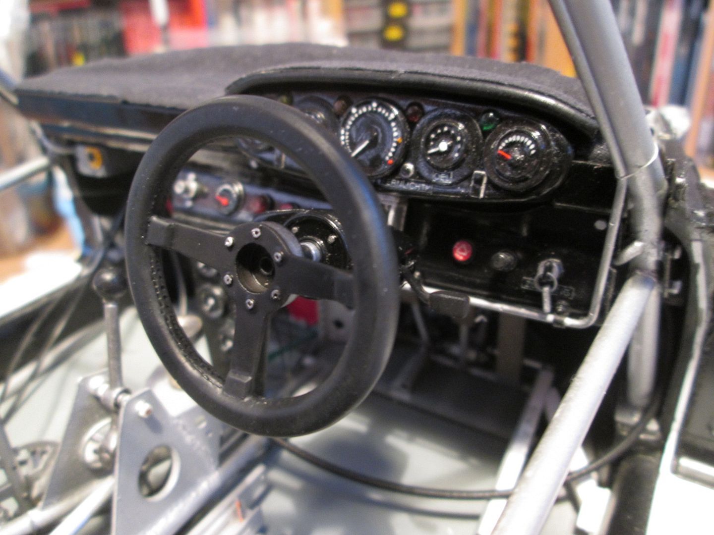

Sorry, Ian - no actual stitching on the steering wheel! I mean, that would be ridiculous - almost as daft as making headlight bulbs with filaments inside them. I have my limits...
I airbrushed the whole steering wheel with a couple of coats of Tamiya semi-gloss black, then toned it all down by carefully drybrushing the centre with Citadel 'Chaos Black' and some Tamiya 'Rubber Black' for the rim. Note also the column stalks fitted behind. This is all now ready for final fitting.

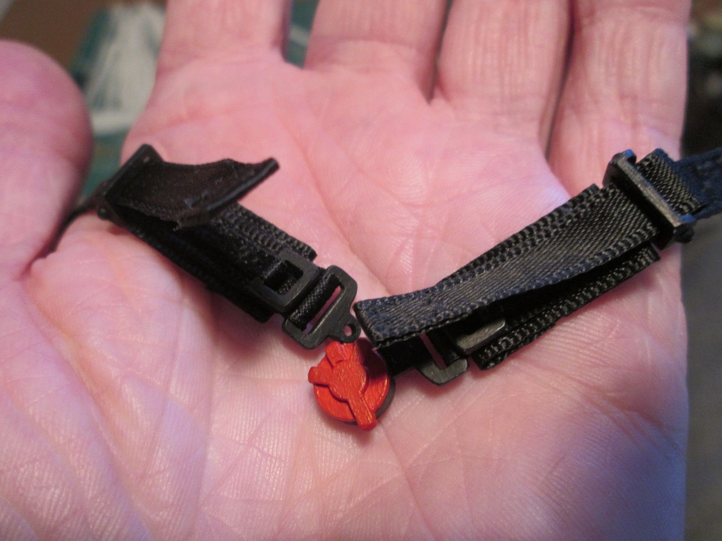

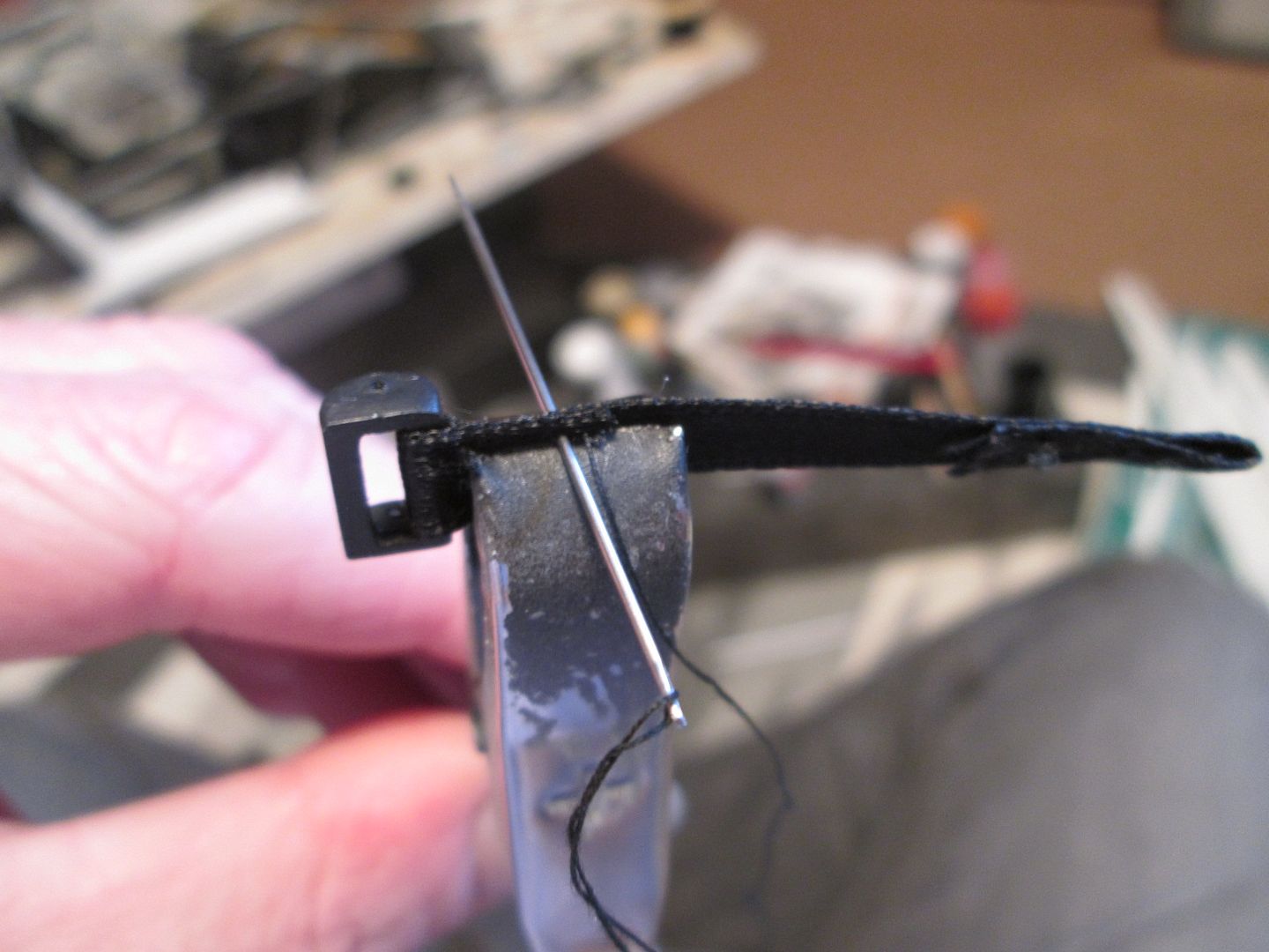

The seatbelts took the best part of a week to make. I had the various sizes of black ribbon from making the 908, so just had to stitch it all together with the various brackets, etc:
The main problem with the ribbon is that once cut, the edges tend to fray apart. In the past I've used CA glue to seal them, but this can result in them becoming stiff. So, all the ends have to be folded back and stitched together. No major wounds or physical injuries during the stitching, I'm pleased to say, although it took a bit of force to shove the needle through three layers when assembling the lap-belts:

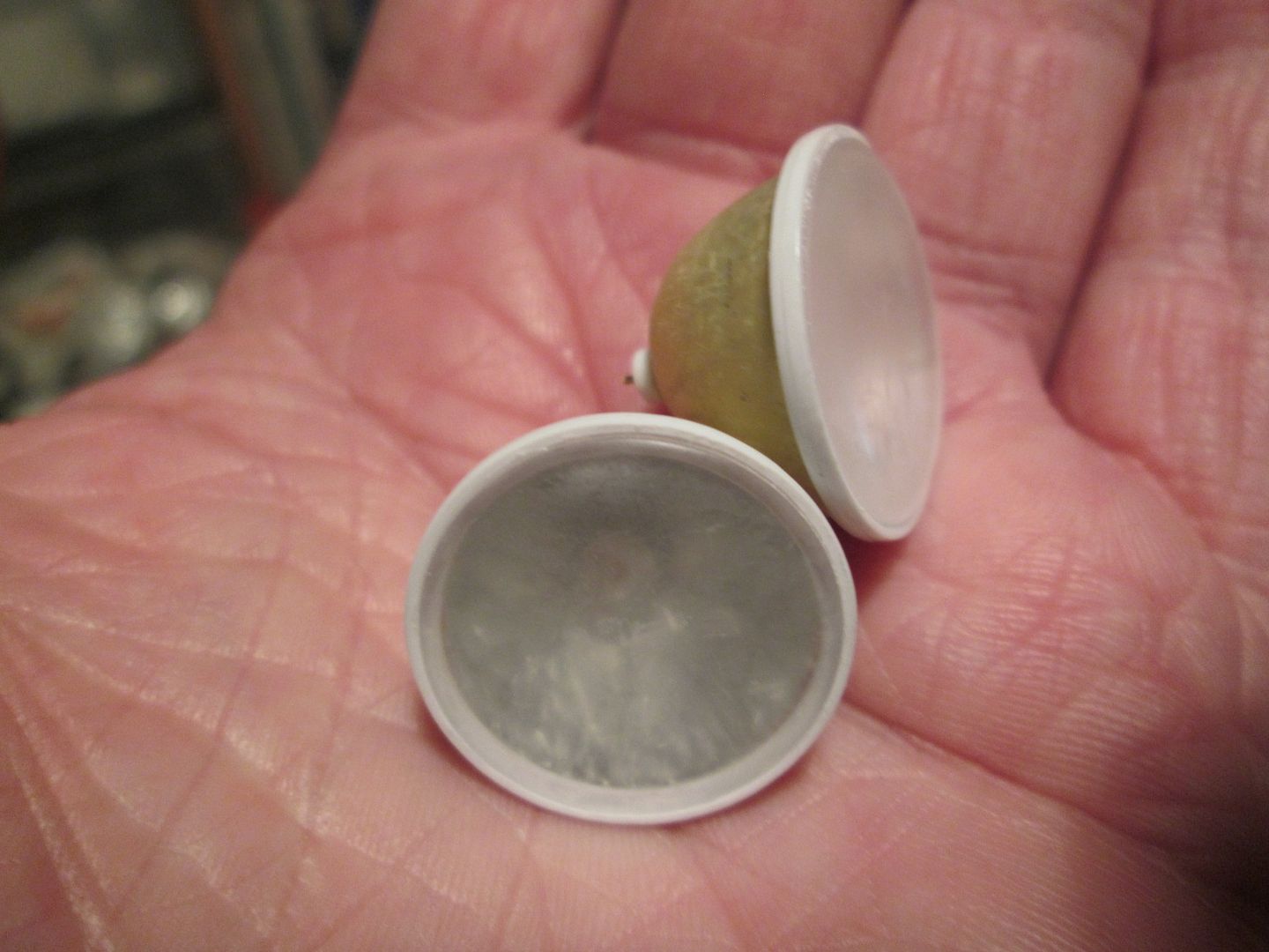

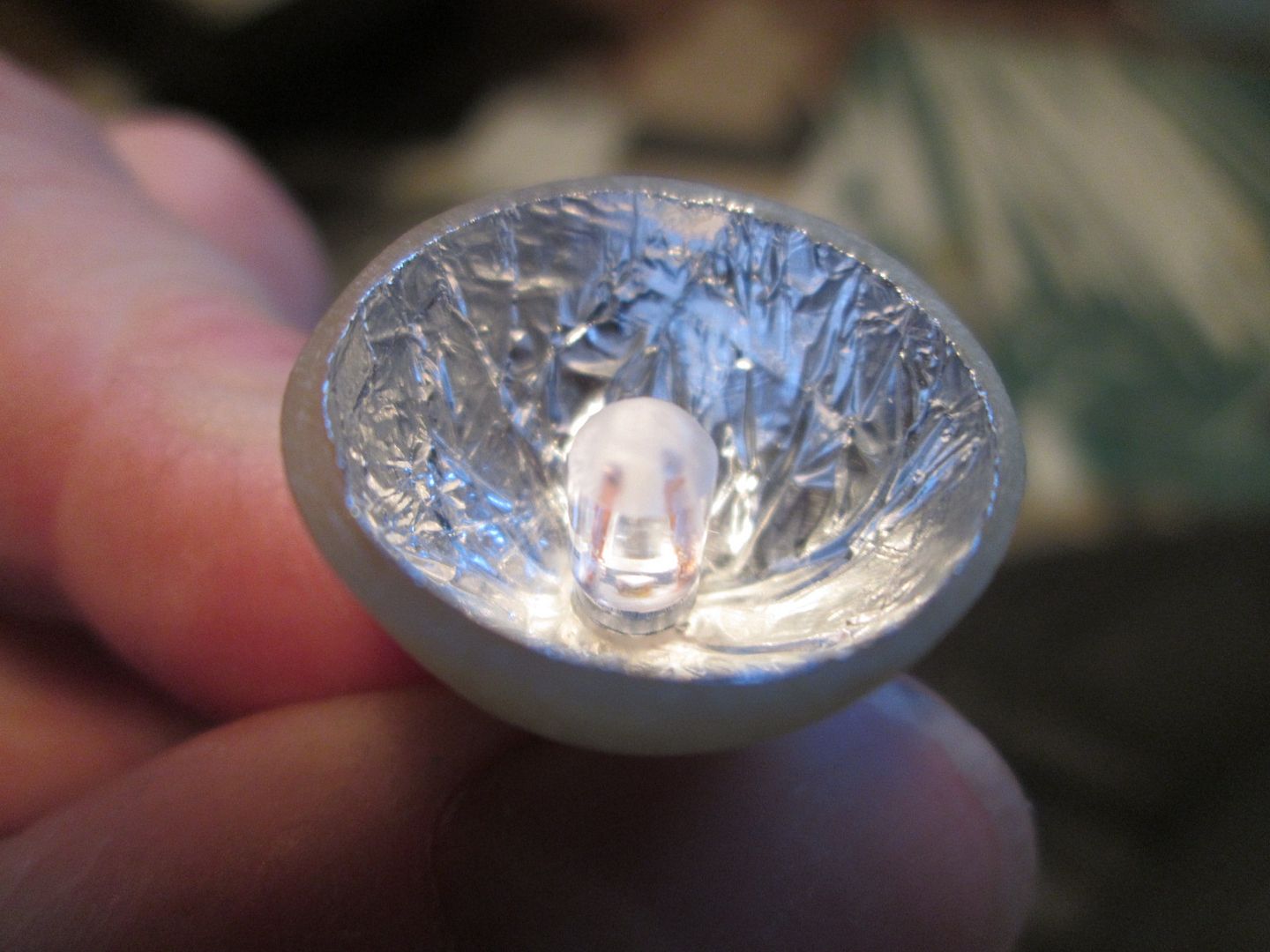

Last thing for tonight - headlights! So, the headlight bowls were laid-up in fibreglass a few weeks ago, removed from the moulds and trimmed up. Next job was to line the inside with aluminium foil to create a bit of 'shine' - I used one of the male patterns to press the foil into the bowl (without tearing) and then repeated the procedure when gluing the foil in place:
I'd already planned to use a length of 20m diameter clear acrylic rod as the starting point for the lenses, but once cut it needed a lot of work with various grades of paper to clean up - I even used a little bit of toothpaste as a polishing compound! You can see by the reflection that I've chamfered around the edges to get some shape into the lens, too.
Of course, having made the bowl, and the lens, I really had to make the bulbs too. These are 4mm clear rod, a little shaping on each end, with two 0.5mm holes drilled into one end with fine copper wires inserted as filaments. A collar of styrene and aluminium tube around the base allows a 0.5mm pin to be fixed through the whole lot which in turn allows the bulb to be fixed into the bowl.
I glued the lens to the styrene ring with CA glue (having tried a test-piece first to make sure it didn't react. The styrene collar has then been filed and sanded down to a minimal diameter:
Now, two things to note here. Some of you will say that I have not put any pattern on the lenses - this is true. The factory car has this style of headlight, but the Freisinger car appears to have plain lenses. I also couldn't think of a good way to create the lens pattern accurately without risking damage to the part! Having glued these together last night, they have become somewhat cloudy. The photos aren't great, I know, but they look better in reality. I'm wondering if the CA glue fumes trapped inside the bowl have caused this - I might try drilling a small 0.5mm hole behind the lens as a breather.
Overall, I'm pleased with the result. I just need to make some small adjuster pieces which will be positioned around the outside, and make sure the whole lot fits inside the pod in the bodywork. There's also a couple of small indicator lights and marker lights to do.

First things first: I think the headlights are tremendously well done!
One question, though: is the inside of the bulbs so "textured"? If they are, you just nailed it!!! If they are slick, why didn't you try Alclad Chrome or, even better, Molotow?
Just my two cents. Going to get some popcorn and wait for the next update!

My aim with the headlights has been to try to get some 'life' into them. Another time I would probably have concentrated on creating a decent-looking lens and surround, and tried to fudge the internals, but for this one it just seemed easier to actually make a complete unit. As I've said before with the wiring - it's easier to work to a proper layout, than it is to just throw lots of wire around and hope it looks right! Adding the bulbs and filaments was a bit of fun - an Easter Egg for the build that'll probably be barely noticed by anyone who sees the model in real life.
To be honest, I didn't really consider painting the insides of the bowls. I knew that nothing I already had would be bright enough, and I have no experience with Alclad paints. Another time, maybe. The aluminium foil seemed a good approach, although it's obviously prone to tearing - so I wasn't pushing to get a super-smooth finish. Using the mould patterns to press the foil into shape worked well, but I was happy to trade the crinkles for no rips!
The fogginess I mentioned inside the bowl seems to have improved during the week without the need to drill any vent holes, so I'll see how that develops. We've got a hand-held engraving tool at work which I'm going to try on a test piece of acrylic - I'm not promising there'll be markings on the lenses, though! Don't forget, the lights on the -78 are tucked down at the bottom of the nose, so they're not as prominent as they would be on a regular 911.

I'd recommend trying a spoon with alcad paints, I think you'll find it extremely easy to use.

Yes, you must try with a plastic spoon first, you gonna see how simple it is...
You must spray a coat of VERY bright Black first - the brighter, the better.
And then, with a very low pressure in your compressor, paint with a light coat of Alclad Chrome. And... that's all!
I take the liberty of posting a picture of a bowl (not a bulb, as I wrote before) of a 1/8 car I'm building, right now. I used Molotow (even better solution, I think). You can see how reflective and smooth it is.

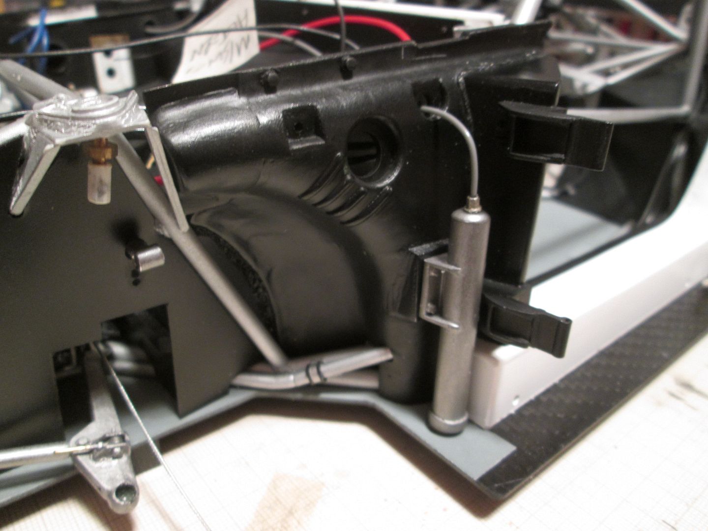

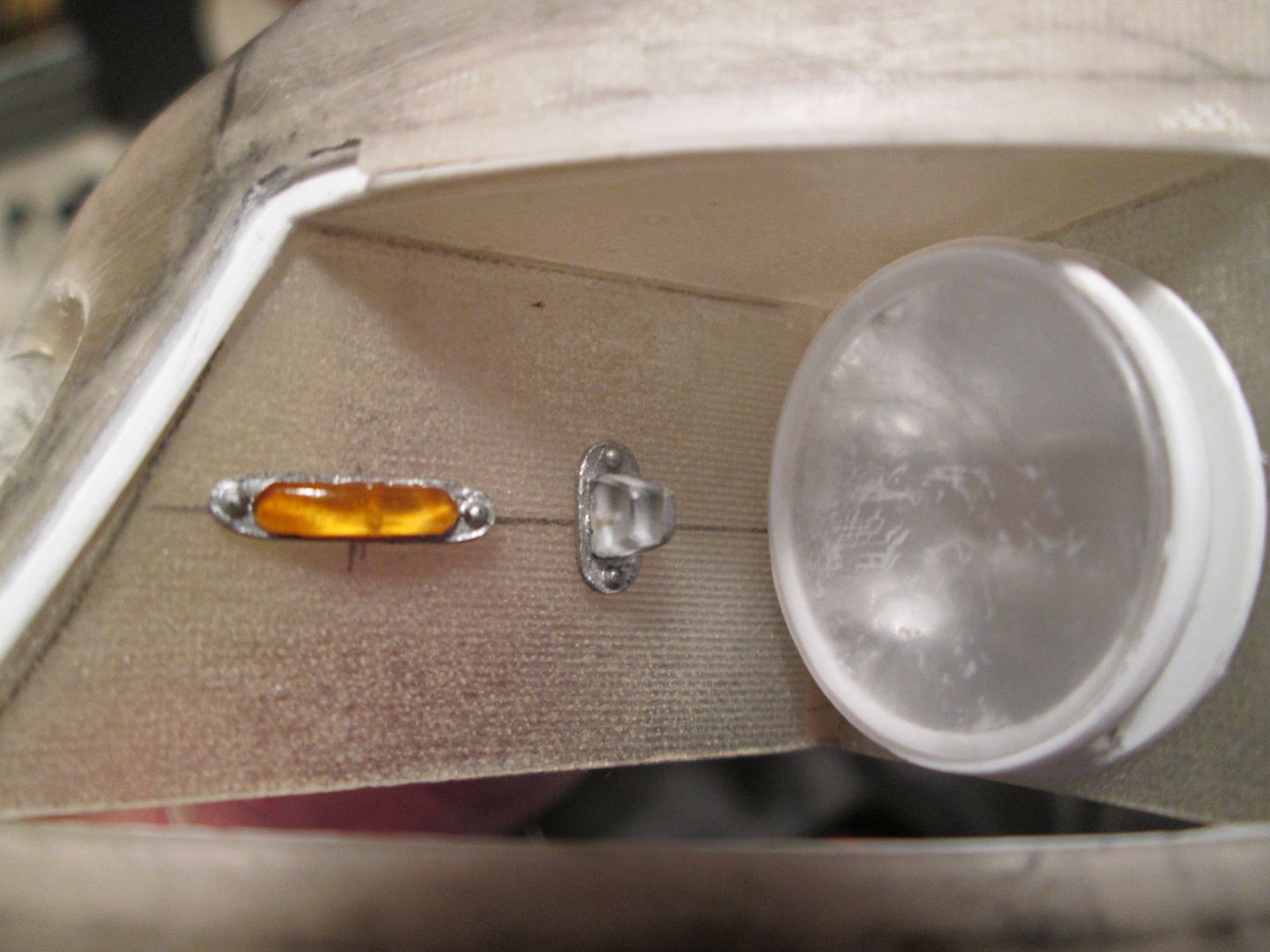

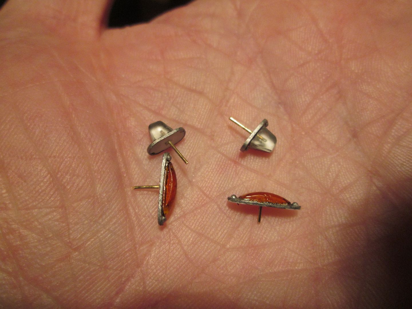

First up, having added a few extra details to the headlight surrounds, I made the two small indicator lights and marker lights:
Very fiddly to make, but I think they'll look fine once the bodywork is painted. For now they're just pinned in place. For the indicators I cut each one from a thin disc of the 15mm clear acrylic rod, then rounded-off the ends with a file. A couple of coats of Tamiya clear orange, and job done. The clear marker lights were cut from the remains of the disc but needed a bit more filing to shape. The backing plates are strip styrene, with 'Wave Option' rivet detailing.

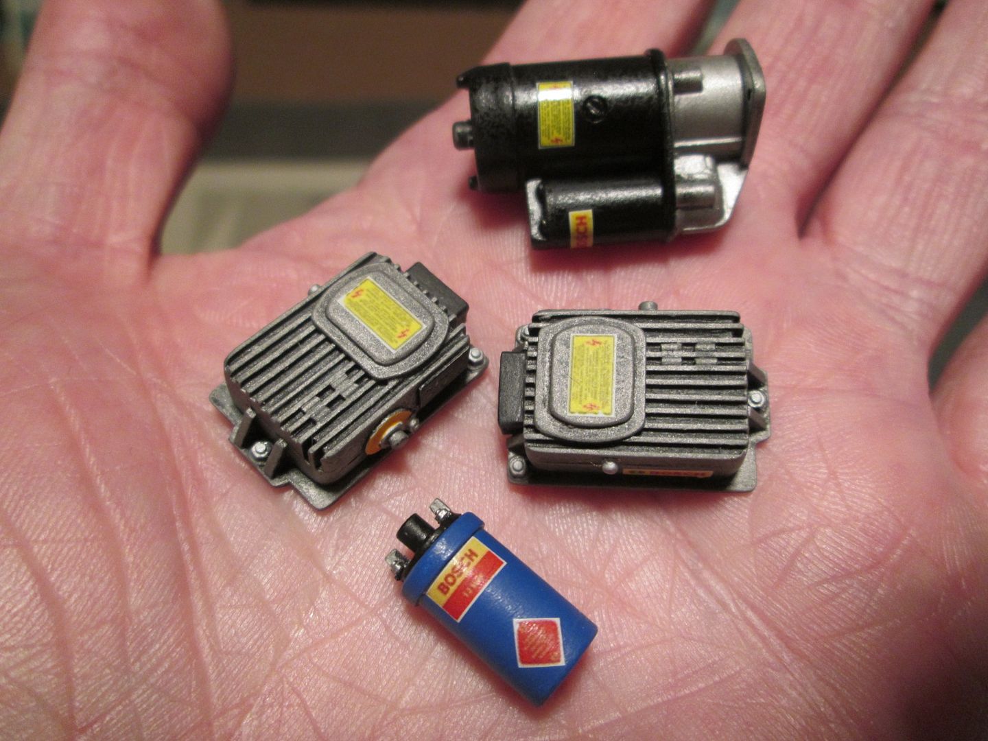

One thing I definitely wanted to do during the holidays was to sort out some of the decals required for a few of the electrical parts. I spent a couple of hours trawling online for suitable logos, etc, then spent a bit of time cleaning them up and checking the sizes. The end result was half a sheet of logos, most of which will hopefully not be required...

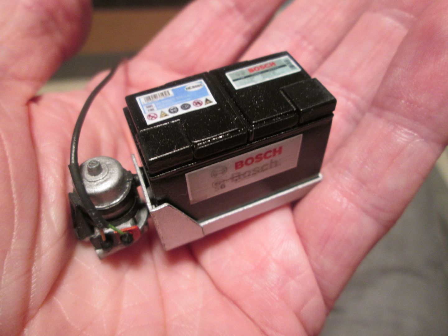

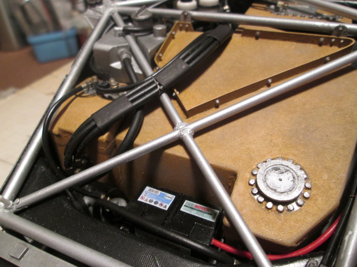

Here's the starter motor, ignition boxes and coil:
...and the battery:
I'm particularly pleased with the battery - although it's buried down in the nose of the car, the decals stop it looking like just a black box. While I was at it, I sorted the wiring for the fuel pump, ready for installation. The coil needed a bit of work to finish the top detailing, and the ali mounting strap (not shown) has been primed and re-painted. Each part has been re-varnished afterwards to give the decals extra protection.

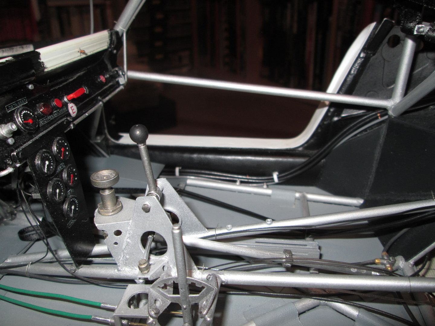

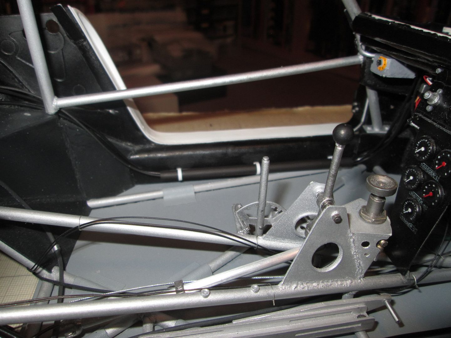

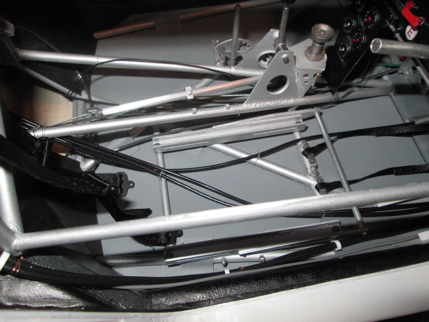

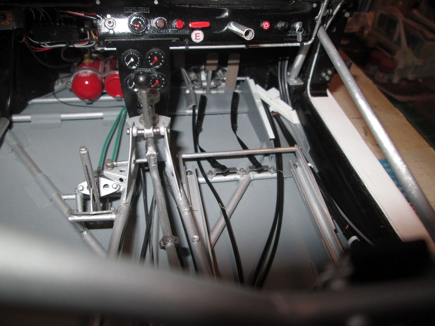

Most of the rest of the work has been in the cockpit. The last couple of photos hopefully give a feel of what I've been doing:
The wiring running down the left-hand side of the cockpit from the dashboard has been matched up with the appropriate pieces coming from the engine bay, with a length of ali tube used as protective conduit. This might be changed. I've drilled some extra holes through the rear firewall to pass a few of the cables through, rather than forcing everything through the holes for the water pipes.
The fuel lines down the right-hand side have been strapped together and are ready to be fixed in place. There's also a thin grey wire there which will be used for the air-jack plumbing - I've also made the fittings for the top of each jack.

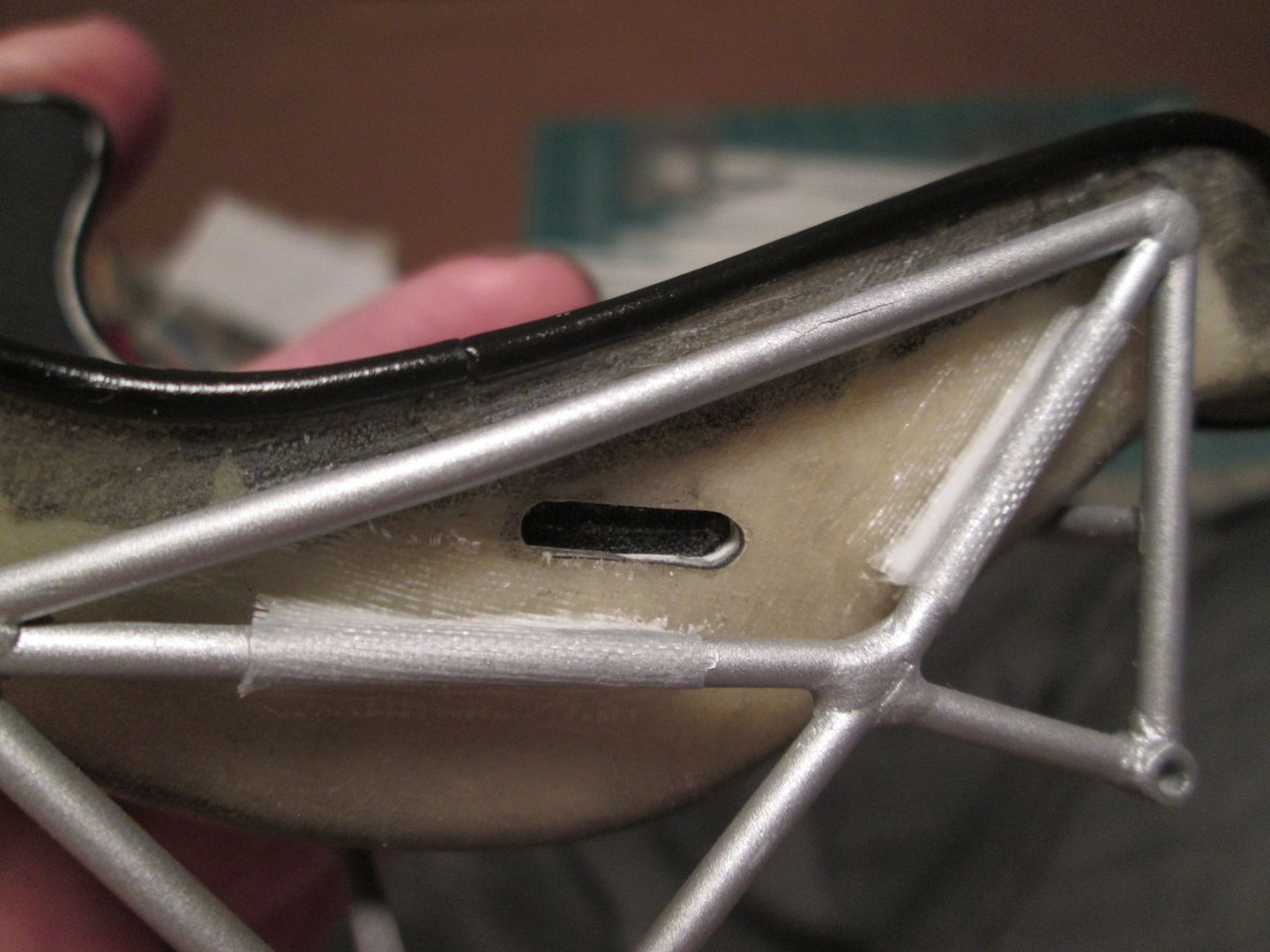

Work continues!

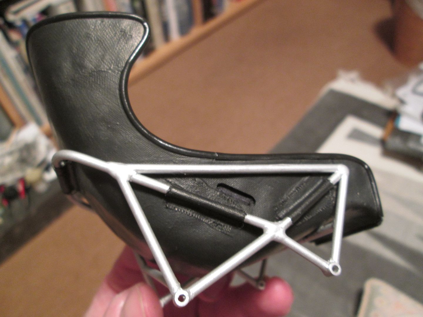

The seat shell was glued into the frame, and five small sections of styrene added at various points as reinforcements. The final touch before painting was to add some small pieces of fibreglass cloth, gluing them in place with CA (rather than resin / hardener):
Just needs the mounting frame pinning to the bottom and it'll be ready to drop into place.
More tidying of plumbing and wiring in the cockpit. The length of ali tube used as conduit on the left-hand side has been covered in a piece of black heat-shrink tubing, and fixed in place with three styrene straps:
The fuel lines on the other side have also been fixed into place, and the cover panel to the right of the pedals has also been trimmed and fitted:
I'm sure I'll find a few more wires to add here and there, but these can be tucked in and around the main ones already fitted.
On both sides the chassis tubes running across the doorways have been touched-up with paint - you could see in a couple of photos in the last update (and others) that there was a lot of wear and tear. Not surprising, given the problems of accessing the cockpit!
It's pretty much ready to fit the seat now, but I'll hold off on that job for a little while in case I think of something else to do in there! Once the seat is in I'll fix the lap-straps, then add the instrument pod and column surround - all easy enough to do.

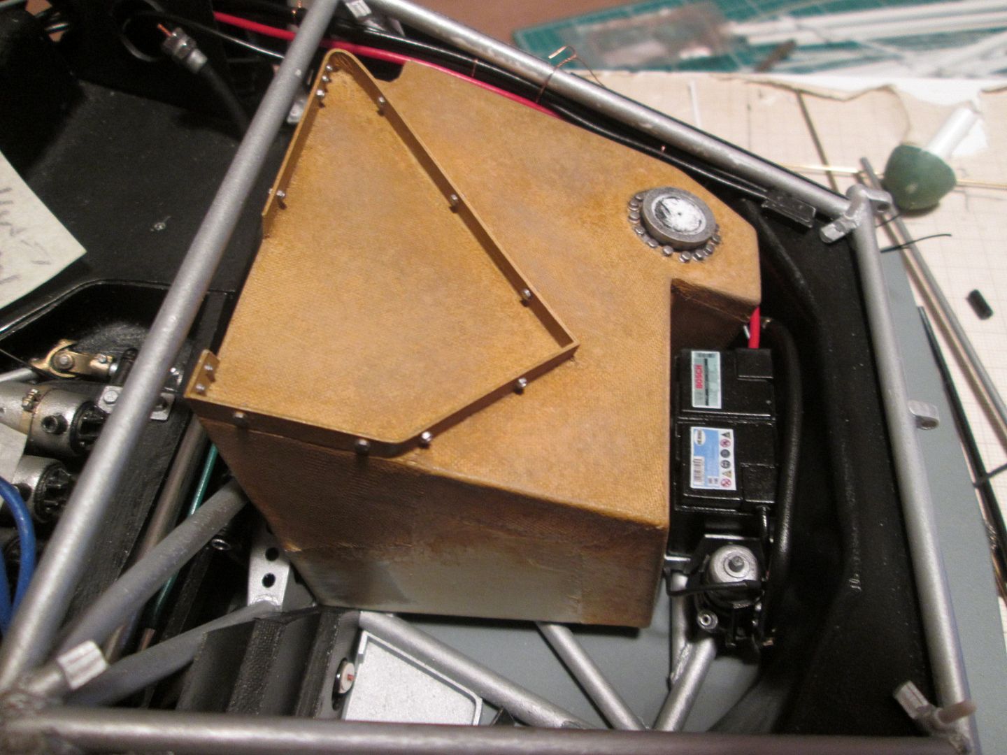

I'm now back in the nose of the car - after spending a bit of time checking the assembly sequence (yes, the steering rack bar and trackrods can be fitted later) I added the battery / fuel pump unit (with wiring), and the main part of the fuel tank:
The fuel-pipe from the tank to the pump is in, and the battery has been wired-up. A bit of test-fitting proved that the upper section of the fuel tank can still be fitted, and the oil tank and fuel collector tank will squeeze into the side - some of this will happen this week. Then I can work on the upper part of the nose - wash-bottle, catch-tank, more pipework - before adding the top X-frames. It's quite possible that by the end of this month the front end will be looking fairly complete...

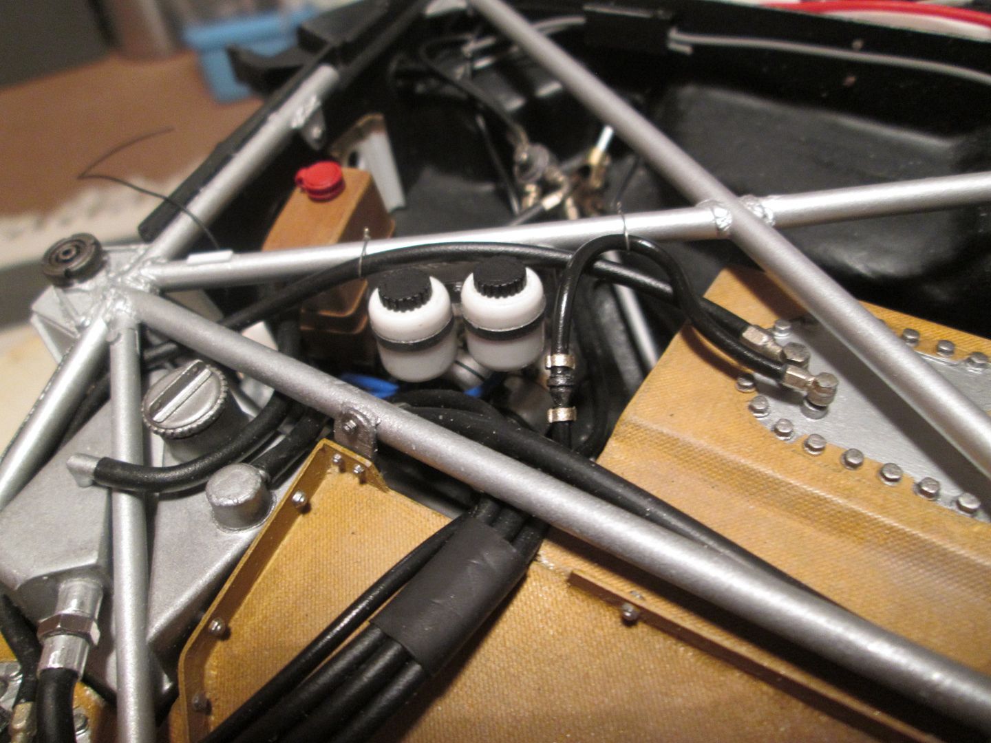

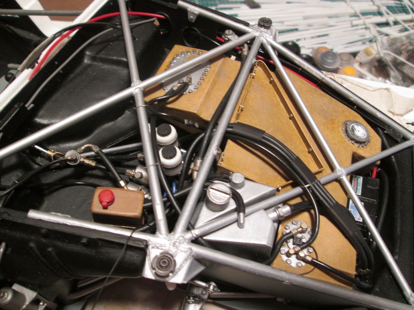

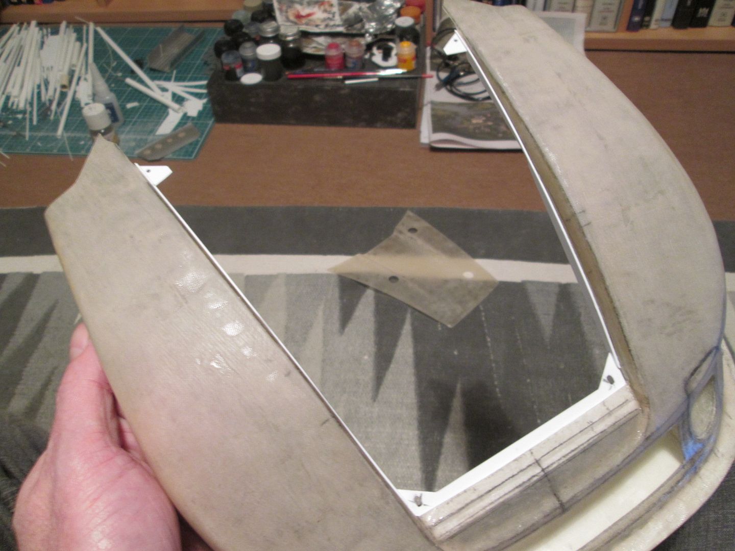

Well, it's not the end of the month, but the front end of the 935 is certainly looking different! Only a few photos tonight, but they are proof that I've been busy...
Everything you can see in the front of the chassis has now been fitted and fixed in place, including the two X-frames over the top. It hasn't been a five-minute job - at every stage I've been checking and re-checking that everything will go in, test-fitting bits and pieces, and basically trying to avoid any slip-ups.
Connecting all the bits of pipe-work hasn't been easy, either. Although I'd cut most of the pieces to a rough length some time ago, I still had to check and adjust everything as I fitted them. A couple of pieces had to be re-made as things were routed slightly differently, but this wasn't a problem as the end-fittings weren't glued-in until the last minute.
The two brake fluid reservoirs are still un-painted styrene, but were given a coat of gloss varnish to (hopefully) make them a little more realistic. A thin strip of painted styrene was added around the middle to match up with the mounting plate, and they were ready to fit.
I haven't fitted the washer bottle and pump yet - I'm still undecided about the finish on this and might still re-do it. There's a few bits of wiring that will be tidied up when the dashboard top is added, too. At the very front, I drilled through the inner duct of the front radiators to pass through the oil pipe to the tank - this will be connected when the main exit ducts are fitted later on.
What else? The seat has been attached to the mounting frame but has not been installed in the cockpit. I was going to do this during the last week (as it would then allow me to fit the steering column, indicator pod, dashboard top, etc) but decided against it until I've got the engine and gearbox fitted. It would make it difficult if I need to add more wiring into the cockpit, and it will certainly be easier to fit the gearbox, shift linkage, etc without the seat getting in the way! I'll have to be careful, though - getting the seat into the cockpit will be a challenge once the roof is on...
