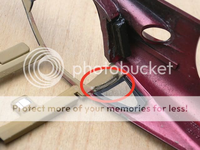

Here is the mounting of gas-lift I mentioned before:

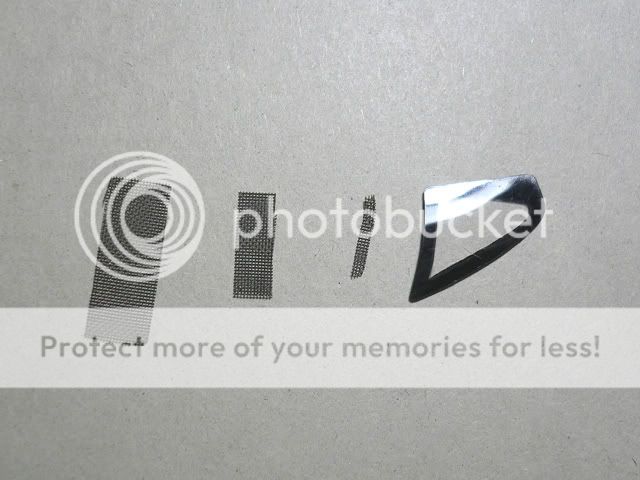

There are air vent holes behind door windows. They have meshes. I decided to reflect these feature on the model:

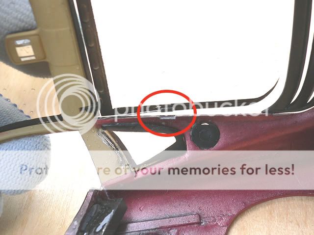

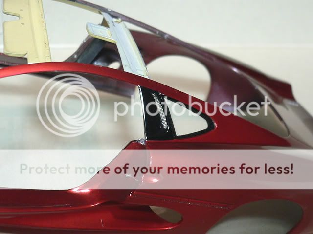

This how it looks like inside:
....and outside:

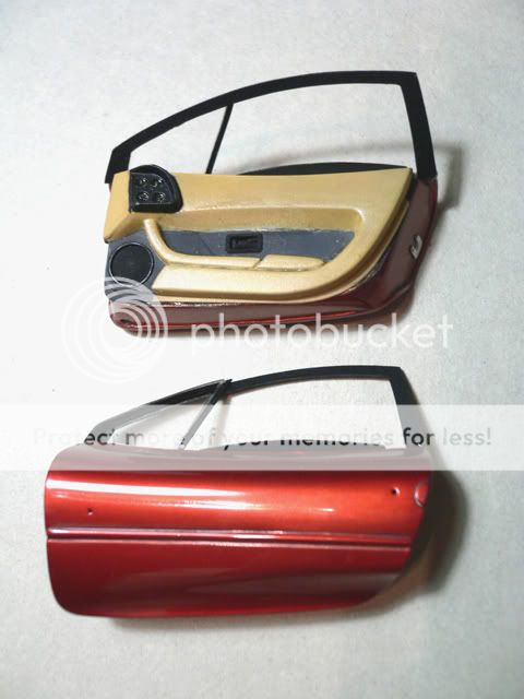

In the doorway of a real car we have nameplate and rubber covers.
As we have two couples of nameplate on decal sheet, I decided to use the second pair. I also used adhesive rubber band and mirror-like “Oracle” tape:
Doors:
