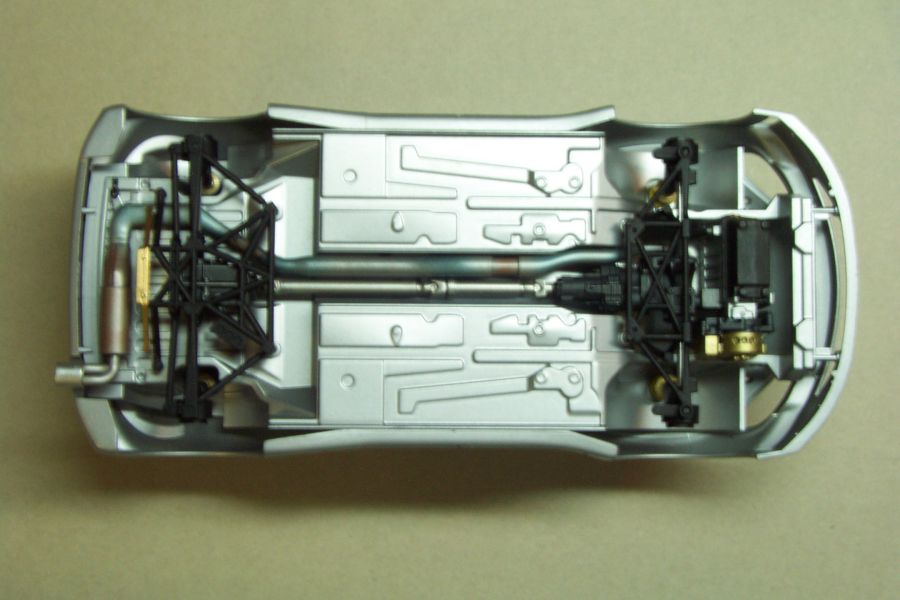

Here are a few crappy shots of the latest developments. The body has been clear coated and polished. Took a while becaus the Carpenta decals that I used for the Rally NZ bonnet and door plates were very think and didn't take too well to the Tamiya clear. They crinkled slightly event though I started with very light mist coats. In retrospect I should have left these decals to last and applied them over the top of the clear coat. That would look more true to life since the bonnet plate is actually a metal sheet riveted to the hood and the door numbers are adhesive vinyl applied over the paintwork.
First shot shows the roof monted camera I've pieced together. There will be a cable running from it to the driver's door held down by silver decal representing duct tape.
A couple of pictures of a dry run assembly of the suspension. Sorry about the shaky photography.

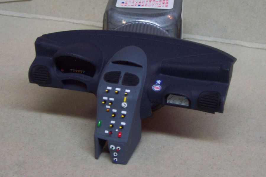

Finaly a (very dark) snap of the dash with the switchgear installed and painted.
