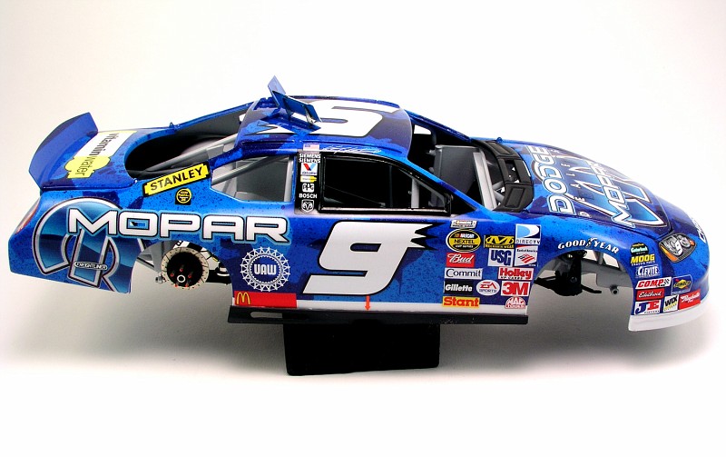

Originally Posted by hakkfan
On to the update!! We have paint!!
After masking off all the inside gray areas, all body parts were shot with Tamiya TS23 over gray primer.
The dark areas were shot with Tamiya TS51. Once it was dry, and the masking was removed, I added the splatter straight from the can using both the TS23 and TS51. Now it's ready for underlay decals.
I drew up the art for the majority of the decals in Illustrator 8, and printed out the underlays and graphics on my Alps printer. I did two layers of white, to make sure there would be zero bleed through.
Once those were good and dry, I began adding the main Mopar decals....
Thanks for looking!
ClayK

Old 10-09-2007, 10:58 PM   #50
hakkfan
hakkfan's Avatar
Location: Avon, Indiana
Posts: 164
Re: WIP: Kasey Kahne's '06 MOPAR Dodge Charger
No rest for the weary! With my Pro Stock finished up, I got right back on the Kasey Kahne Mopar car. As I'm sure Dave will agree, the November deadline is coming up fast.
Once all the paint work was done, the body and misc. pieces were all cleared with Omni two part clear. After curing out for a few days, they were wet sanded and then polished out. The cowl and window surrounds were then masked off and sprayed black. After I was satisfied with the finish I began the rest of the decaling process. Most of the logos and numbers came from various JWTBM sheets, with the rest coming from Powerslide decal sheets. I've still got a few small ones to add, and then I can finish up the remaining body details.
Thanks for looking!
ClayK
