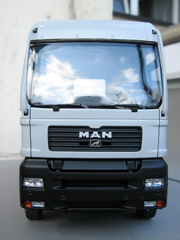

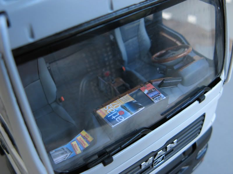

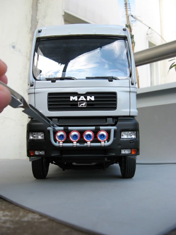

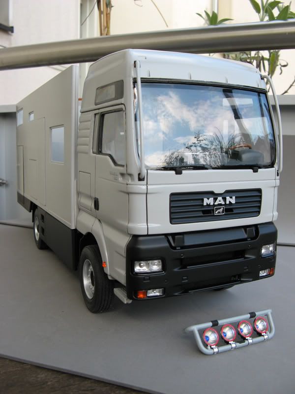

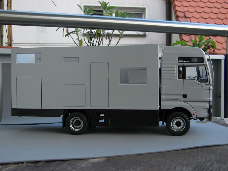

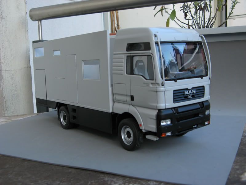

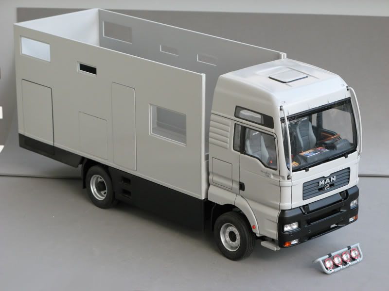

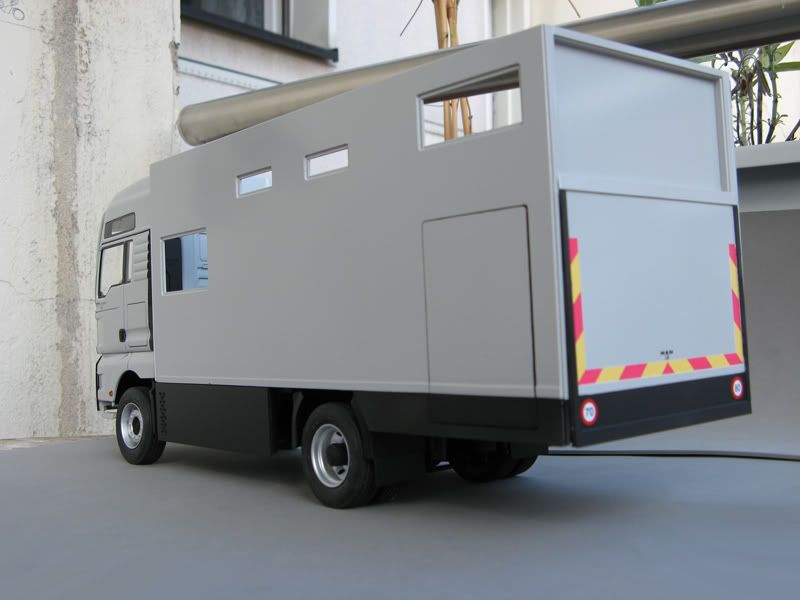

Have been working the last couple of days
Here are the progress pics:
The "bumper" with the lights has still to be added...
and with a set of Luminator Xenon...
Cheers
SEB >> has to keep on working: |runaround|

  #57
Old 07-20-2007, 04:33 PM
voyageur voyageur is offline
Join Date: Oct 2004
Posts: 1,229
Thanked 13 Times in 13 Posts
Re: MAN TGA expedition vehicle
Originally Posted by Fabbri_Guy
COOL! But what is it? Whats it used for in real life?
Hi, welcome to AF.
I'm glad you like it...but please read the thread from the beginning - it has all been mentioned before.
Thanks.
Cheers

Old 07-20-2007, 06:00 PM
rallymaster's Avatar
Join Date: Jun 2005
Posts: 2,959
Thanks: 15

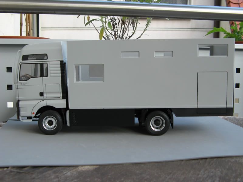

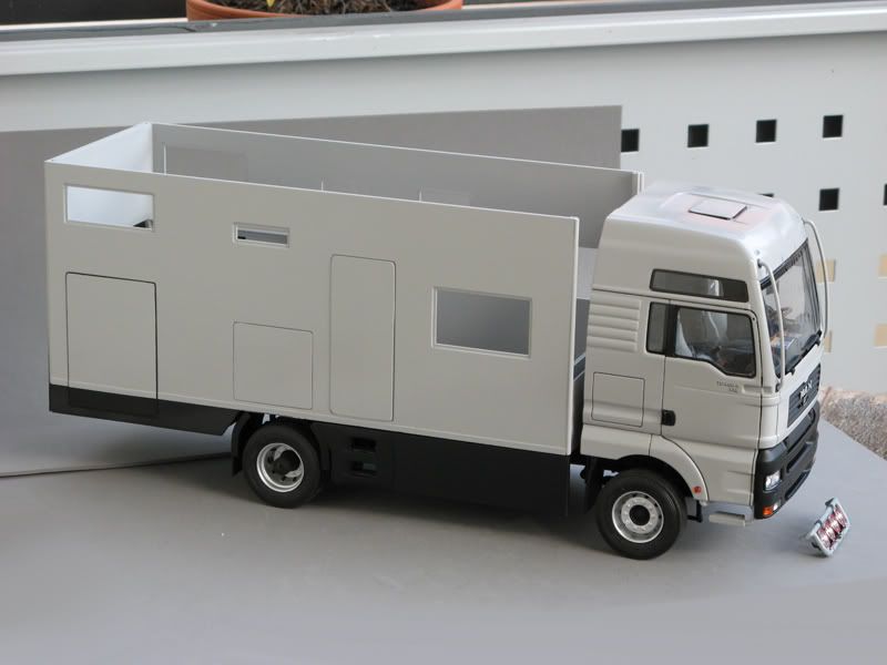

Hi Sebastian,
Very nice model here, the front window looks so clear and real, that's very well executed !
I only have a question you may not enjoy but... Humm, I risk myself asking it
Don't you think you gave to much overhang to the model ?
But once more, what a beautifull result !
Phil
  #60
Old 07-20-2007, 06:35 PM
Join Date: Oct 2004
Posts: 1,229
Hi Phil,
...yeah, I do! But I had no other choice due to many reasons:
- he wants to be able to stand upright in the garage
- he didn't want a truck with three axles
- the motorcycle has to fit in lengthwise
- the sleeping area is atop the garage (you need some headroom there, too)
- and....maximum height is 4000mm by European laws.
Initially it was planned to be 30mm/720mm (in scale/real) shorter...
MAN says this is the maximum rear overhang
for this chassis. I know it looks rather silly, but there's nothing I can do about it
Next project of such kind will be a UNIMOG (with almost no overhang at all).
Until then...
