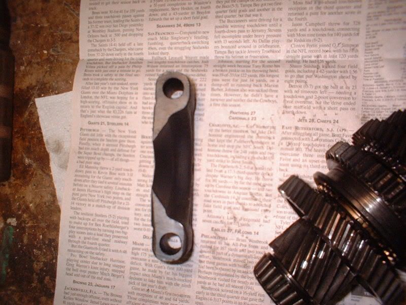

The case is cast aluminum Doc, you might want to use another type of brush as you might make a bunch of little scratches. Nylon or some other hard plastic would probably be best.
The ends of the grappling arms are too thick to fit between the gears. Here's a side profile of the bearing separator (gear puller in upper left of your picture):
As you can see, with the conical profile even this won't fit all the way behind it will fit enough to pull them apart.
My kit is in the mail as we speak. I'll post the full thread by Wednesday hopefully. Then we can work on modifying it but hopefully there won't be too many gaps to fill.

Actually that's a good idea. The furthermost gears came off really easily so it certainly seems doable. Since the shafts are stepped you don't need a full 12" bolt to pull on because the gears will fit on up to the step, just maybe 5 - 6 " or so. I'll give it a try. Just have to make sure it goes on evenly but that's true no matter what you do.
