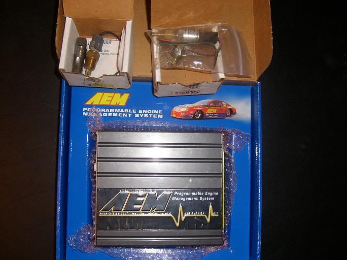

October 25th 2007 - Two boxes on my front porch this morning. A Mario Koenig solid aluminum rear differential mount, and an AEM EMS w/ 3.5bar MAP sensor and IAT Sensor!.

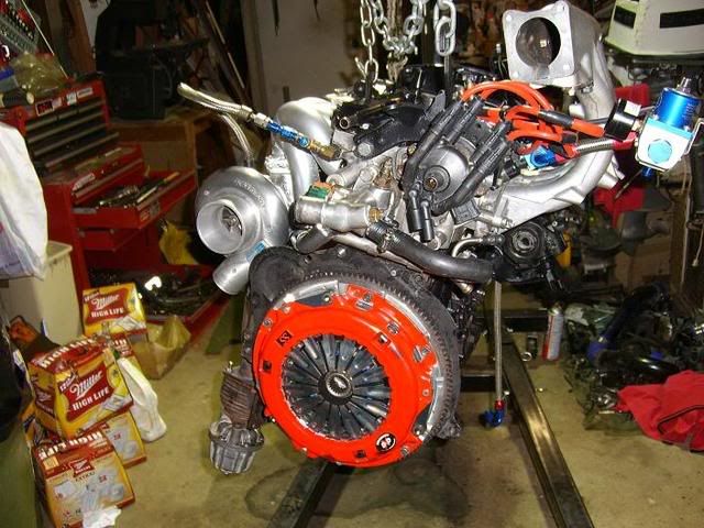

April 29th 2008 - Recent progress with the engine build. Installed new wiseco piston rings. Modified 3s-ge intake manifold and 3sgte throttle body. Installed EB fuel rail and 780cc injectors. Mounted exhaust manifold and turbo, etc.. Almost ready to drop the engine back in.

May 1st 2008 - Engine is ready to go. Mounted transmission to the engine. If everything goes as planned, the engine should be in the car on saturday.
