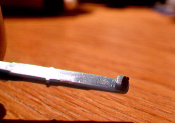

Here is how I do it on this model -
1) Finish interior, drivetrain, and permanently assemble with chassis and body leaving suspension off. *TIP* - Thin the blacked-out area in the pic heavily until it slides into the rear of the body without spreading the bottoms of the rear fenders - your rear valence will fit perfectly!
2) Using a round file, sand the saddle for the rear axle to about 1/8" thickness, eliminates unsightly extensions. Also, lose the locating pins on the rear axle.
Notice the difference between stock and the modified part.
3) Trim the front of the leaf spring where the black-out part is. This will give you room to locate the axle more forward when assembling.

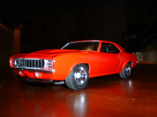

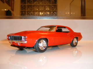

Ok heres a quick update with some photos I will explain what has been going on in the next post.
The quality of the pictures here are crap, as I am still learning to use my new digital camera and the lighting today is terrible, its raining here.
I also had about 4 cups of coffee and am very shaky, not a good time to model.

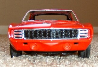

Anyway here is after I have put the grille in. I decided to go with the RS style, I just like the hideaway headlamps.
edit-the pictures were horrible so I have deleted the old and inserted new ones

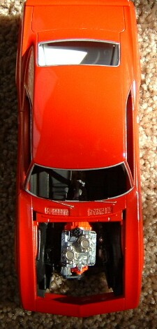

Next picture is under the hood where I am still working on detailing it. I still have not decided where I am going with this model.
I have pretty much decided this is a practice car and the next one I build will be built w/o the mistakes done on this one. I have recieved very much help from murco, and also help from trial and error.

Looking awesome!! Love the color and the RS front end! Most builders don't use it as it can be intimidating to detail properly, but you've done it right!!

The engine when dryfitted sets crooked, not a little but a lot. I guess I will have to sand the motor mounts until I can get a better fit.

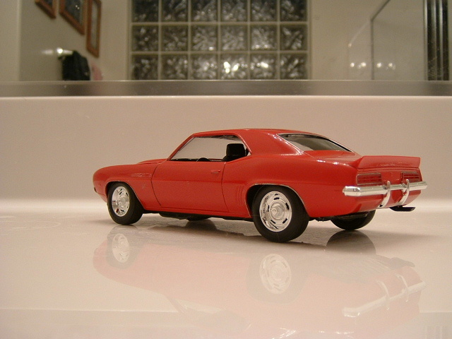

Here are the picks of the slapped together unfinished RS. I still have not finished buffing the painted moldings which I said I was not going to do but have started to anyway. There are some emblems to attatch. The exhause is a total POS on this model, as well as the entire suspension. I did have fun with this model though, and I guess it did not turn out all that bad.
Sorry the lighting once again is terrible.

Looks dynamite!! You nailed the stance perfectly!! Never seen the engine sitting crooked before (never built a small block!), and the color looks great!!
