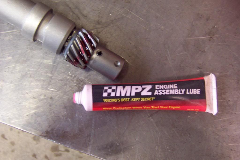

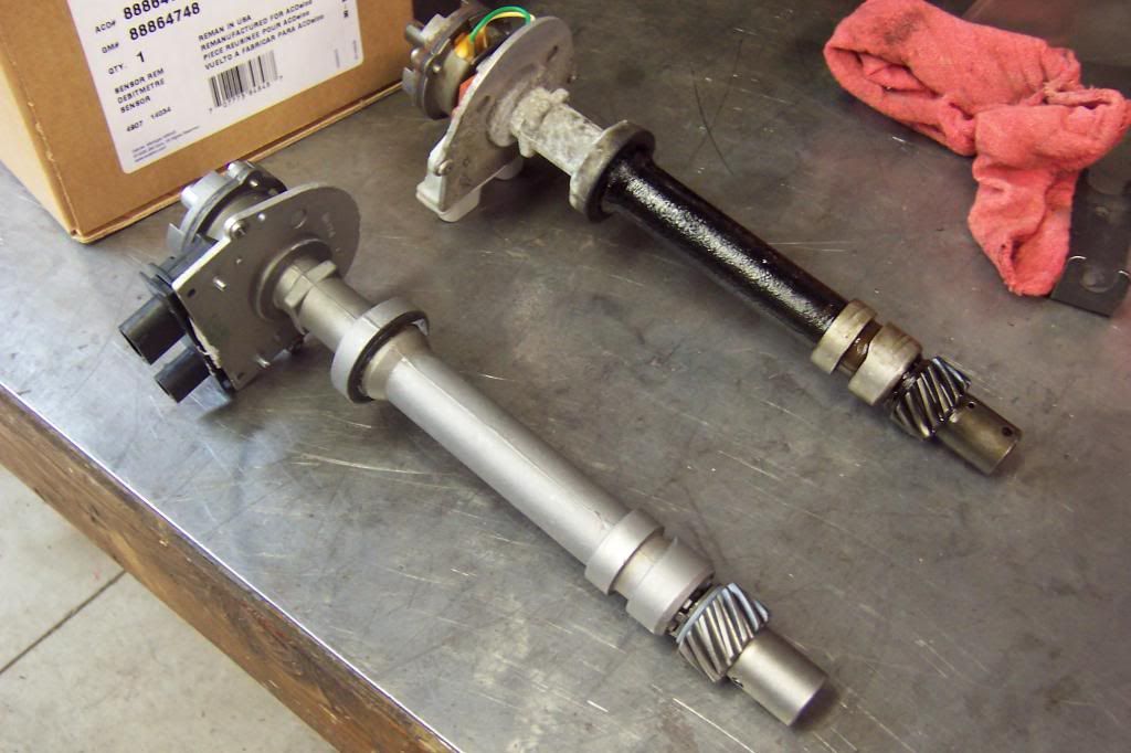

The new AC Delco distributor arrived today. I inspected it, lubed it and installed it. Then I set the timing and went for a test drive and……..drum roll please… It fixed it….well I went for a 10 mile ride and it ran better than it has in 2 months. I think t is 85% fixed. There is still something not perfect. But I am really pleased. The old distributor was a GM. It had same P/N as new one. The end play on the old one was about .062 and .052 on the new one.

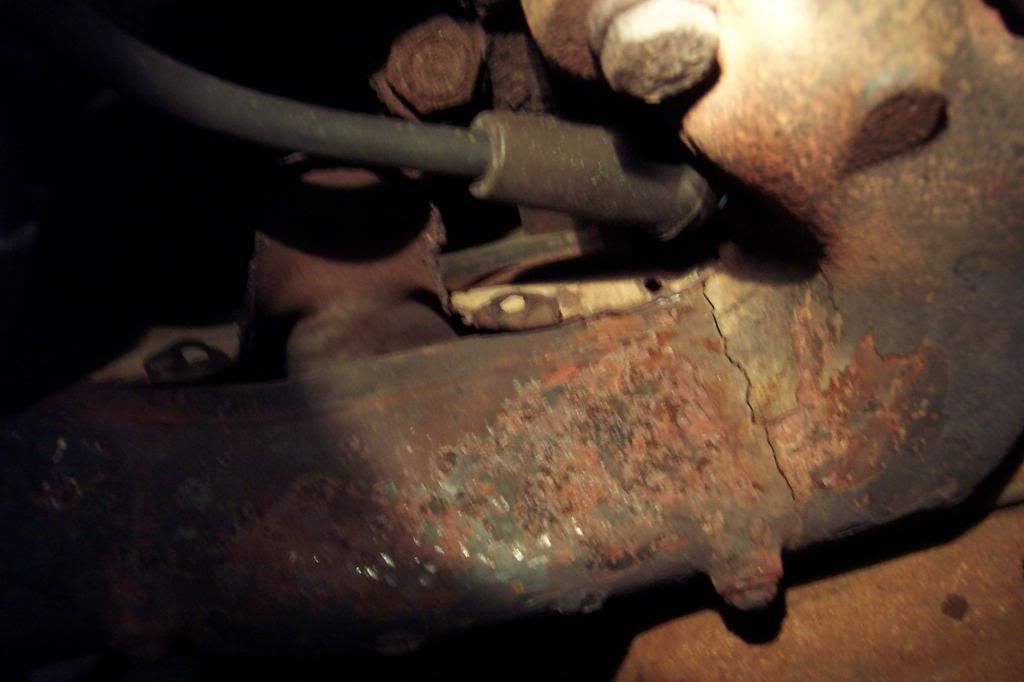

Exhaust manifold – it has been too cold for me to go to the junk yard looking for a replacement manifold. The crack is big but closes up when the motor is hot. I want to replace it anyways. Here is a picture of the crack.

I posted this on feb 10, 2014 " the exhaust manifold crack my be the problem. with a crack the KS will retard timing . also the O2 will report a lean condition to the computer. this will be noticeable after the open loop ends and the closed loop begins. "
having seen your crack you wasting time and money chasing ghosts !

We already know the exhaust manifold should be replaced. This is a priority.
