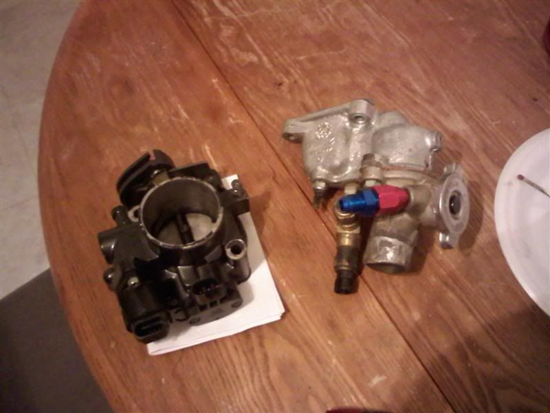

-Finished up the throttle body. IAC is completely disabled and the passage for the idle air to flow is completely blocked (with pennies ). Also the port for the evap is now welded shut as well
-Welded on a -6an fitting on the thermostat to the coolant reservoir. Just had a -6an line clamped up to it before and worked fine, just didn't look complete

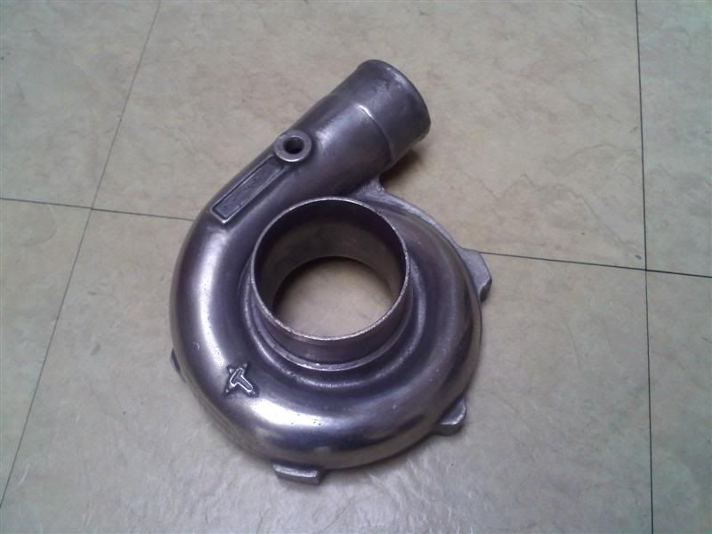

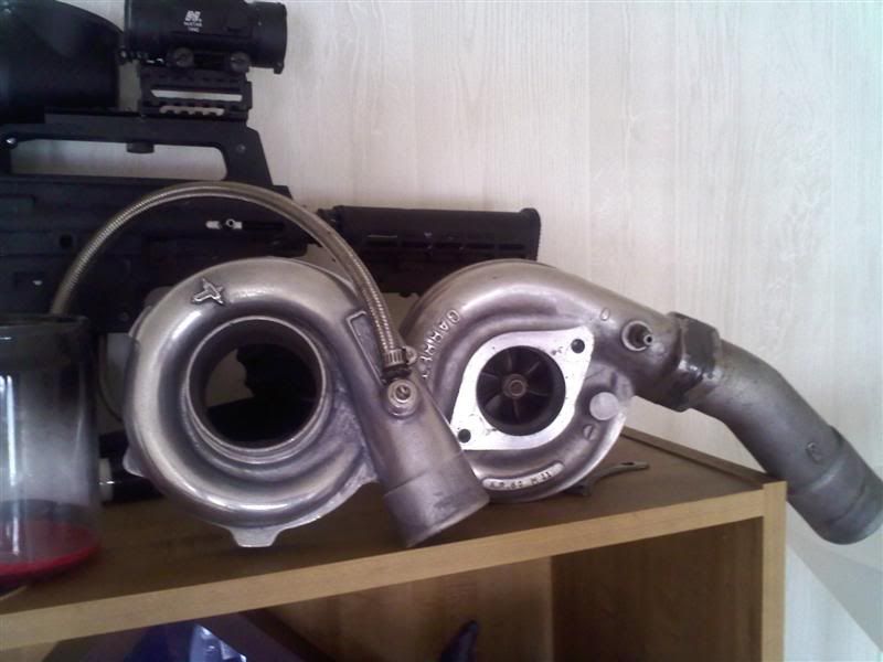

-Polished the compressor of the turbo. Took 5 hours, and far from perfect, but I think it looks good. It's shiny... and that works for me. I had painted it chrome originally but got fed up with the paint dripping off and getting all over the place when working on. Such as hassle and it didn't look good. Pic below

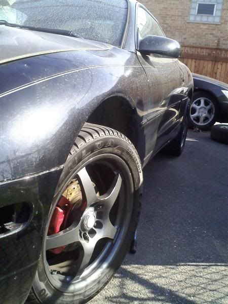

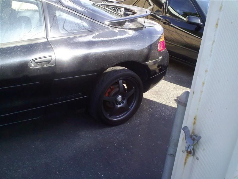

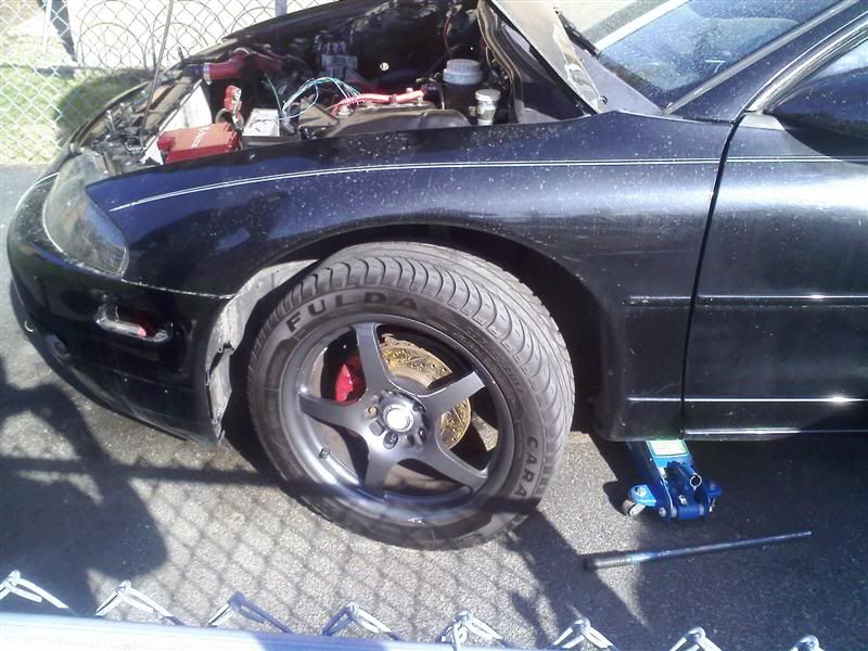

-My boy with the IS300 is selling his rims from it and we decided to test them to see how they look on my car. Price is right, but needs new tires. They're pretty light too. Not sure if I'm going to get them yet though. Each time I look at the car with them on, I think of his MX6 since the body styles are really close. Opinions?

Those rims look really good on there, good choice.

Yea rims look good. Need to drop that thing tho

Ya I need to do the suspension this summer as well, but again was just trying them on. Not sure how I feel about them still though. I've got it printed out at my office so I can stare at them all day. Wish the car was clean when I took those pics, would help out a lot. But seriously, I just keep seeing the MX6 those used to be on when I see the car lol.
EDIT: Oh also, the tires are 2 different sizes between the front and the back. Back are low-pros, I believe 35s IIRC. Way too low for me. I like some meat on them (that's what she said)

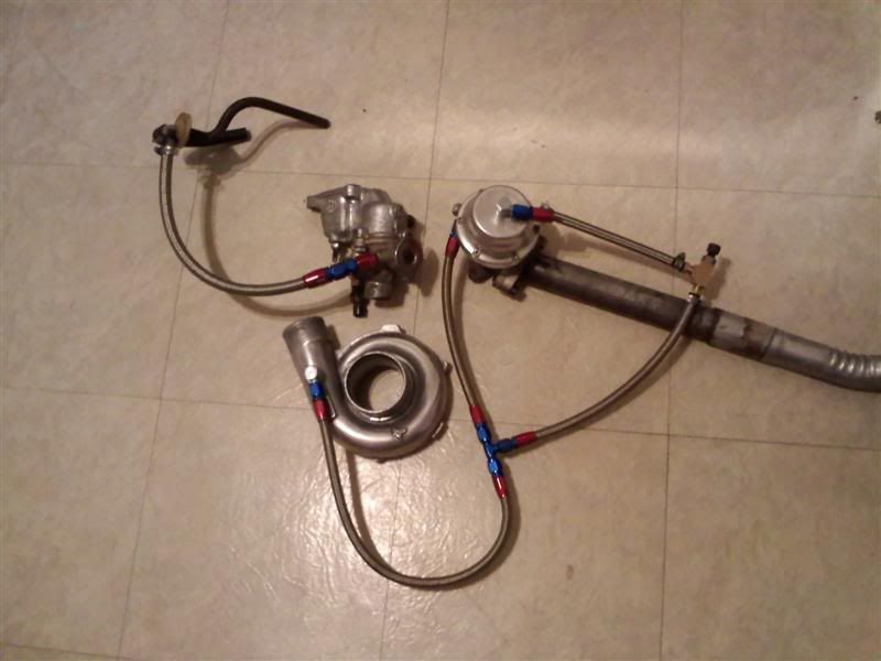

-I liked how the SS lines and fittings looked for the MBC, but didn't like that I just had on the WG and turbo it just clamped. So I bought the right fittings and made it complete. I have an addiction to this stuff I think. Sadly, I bled all over the place from them, including my feet because I was cutting the line in my kitchen while barefoot and the little strands get everywhere. Totally worth it though.

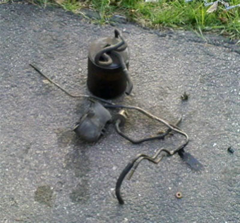

-Took out all evap/emissions stuff. Just have the bracket that holds the canistor in place, but it's mad rusted onto the frame, so when I pull off the bumper I can do it then.

Nice. I like the use of the stainless. Looks super hard compared to regular old vacuum line.
Thanks. I have the problems with vacuum lines breaking and leaking. I decided to the the SS awhile back and it turned out great, but 'as an artist' I didn't like how it didn't look complete. I always hated dealing with putting them together, but actually getting pretty good at it. The -4an is a little bitch. -6an I could cut and put the ends on in seconds now. I want to replace nearly all lines with this stuff at some point.
But the plan is no leaks or breaks... ever, while making under the hood nice.
