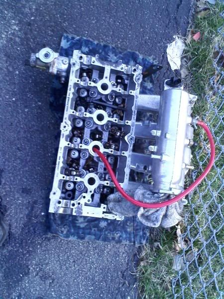

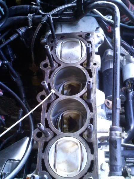

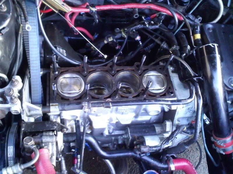

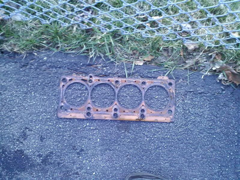

Little update. Head is pulled off. So far everything looks good. Ordered new rings and a ring grinder. Will pull the pistons and throw on the new rings. Trying to find out when my machine shop is open to check the head for flatness.
Head didn't seat properly along the timing belt. Even though it had one of the highest compression, that's where it was leaking on down the back.
Cleaned off the top 2, still like new
Valves all look good as well
Head gasket is NOT blown
