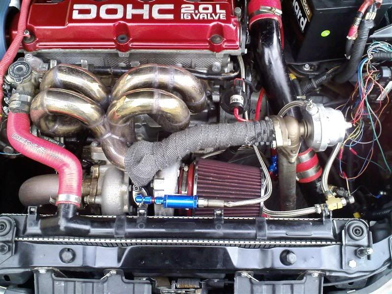

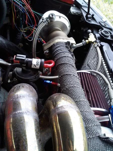

Today was finally nice enough to work on the car. I installed the new BOV, tried to do my best to not have to cut the 1G flange, but that failed. I installed the 1G flange on a Greddy-style flange but turned sidewise so the holes were still there. Installed no problem, used Neds awesome gasket. Took for a run, thing sounds ok, I hit about 8 pounds, and the thing is sitting there whistling, not letting me build boost. Took it apart, gasket was destroyed haha. Back to the 1G. I still may install this other one, but would get a new BOV adapter.
Called my boy and decided to do some filming. Videos are HERE. Car ran like a champ. Was logging the entire thing. Probably ran a good 20 minutes or so. The boost controller wasn't dialed in properly yet, so I set the over-boost protection to 10psi. Car ran great! Close to the end, I needed to shift lanes so I down it to 3rd and move over, the car jerked (I think it was the over-boost) but made it in and the car was perfect still.
Getting off the expressway, I pop the car out of gear, and it dies. I start it back up while rolling up the ramp, and dies again. Ironically, this was the SAME ramp that it died when I blew the motor the first time.
I baby it home, each time car is in neutral it died. Made it home, opened hood, and see nothing wrong with anything. No unusual leaks or anything. Tried starting, same thing. Took a break to look at the log I took. Open MSTune, and log is corrupt. Open the file in a text editor, and it's blank :O WTF!!!
I let it cool down some, and she is idling ok now. Does have a weird noise coming from somewhere that I can't put my finger on. Almost sounds like the fuel pump priming at startup, but that doesn't make sense. I'm going to do a compression test when I find the tester and see what that comes up with. I'm kind of nervous right now about it. Hope nothing is screwed, but I'm pretty sure it is.
