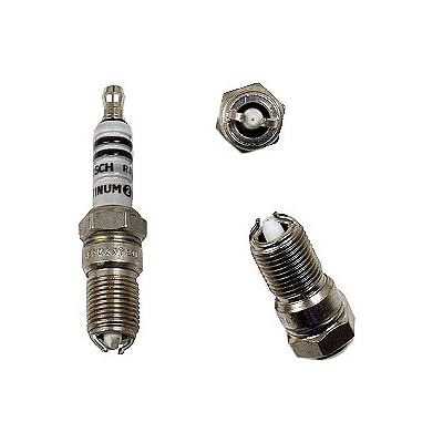

no wd-40 does not last long. and another thing if you put that junk on your spark plugs thread you will have a hell of a time getting them out if you don't change often. cleaning throttle body is a good start. bosch plugs i have never liked do you have the split fire in it? that will eat gas. i'd go from anything but those like ngk's or ac's or even motorcraft and those are junk also i'd rather use autolite or anything but boch's,or nipodinzo.
It was probably five years ago. Back when i didn't see too many preferences for plugs. At the time I just went with what that particular shop recommended. I think they were BOSCH Platinum+2 (Part # 4305).
looks like it has two electrodes on it http://ecx.images-amazon.com/images/...GL._SS400_.jpg
I'll probably change them sometime in the next year to ACDelcos just to be safe.
When i get this spark plug change done... would you guys recommend changing out the spark plug boots as well?
