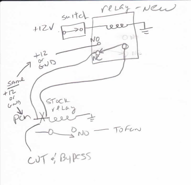

we are talking the same temp switch/sensor. there are 2 circuits in the sensor, one drives the dash temp gauge, the other feeds into the PCM where the computer decides when to turn on the electric fans.
The fans never turn on - that's exactly the problem. Chevy engineered it to where the fans come on at 230 degrees.... that's way too high for my comfort. My fans to my knowledge have never come on due to the temp getting to high. Only by turning on the A/C. The tstat is 195, the PCM turns on the fans when the ECT reads 230, that's 35 degrees above normal operating temperature. I think that is just bad design. I would rather have some wear an tear on the fans than my engine running that hot.
wouldnt rely on the dash gauge, hopefully you have an infrared temp gauge like I do and can measure the temp at the t-stat more accurately than the gauge. I think the gauge would pretty much have to be pegged out to the right before the dam fans come on. Or an ODBII scantool to pull the temp from the computer which is more accurate.
If you are overly concerned, I'd tap into the a/c signal that turns on the fan relays and have a manual switch to turn on the fans in rush hour if you didnt run the a/c. In rush hour, i have turned on the a/c just to keep the fans running and keep the temp down. I wouldn't do this unless you used a diode because your switch could trigger the A/C clutch accidently... just a bad idea.
a better way is to break the signal wire between the PCM and fan relay coil:
in my diagram, I assume the PCM delivers +V and the other end of the relay coil is grounded... of course this may be backwards, with one coil contact is always +V and the PCM delivers a ground signal to the other end of the coil.
you can add your own switch and SPDT relay. your switch can power the relay coil on the new relay.
Note: you are tapping into the fan relay COIL, not the Common/Normally open contacts
i dont know if the PCM supplies +12V +5V or ground to trigger the stock fan relay, if you want to do this then youll need to see what the signal is. you match this signal to the NormallyOpen contact on your new relay.
when you turn on the switch your new relay activates, bypassing the PCM signal (which NEVER operates when you want it to) and you send +12V/+5V ground signal from the normally open contact to the common contact and this signal turns on the fan relay. you gotta cut the wire from the PCM to the fan relay in the fuse block and wire the PCM signal to the Normally Closed contact on your new relay and the other end of the cut wire to the Common contact on your relay. The Normally Open contact has a constant +12V/+5V/ground (to duplicate the same signal the PCM delivers)
the effect is, when your switch is off, the fan relay is controlled by the PCM. when the switch is on, YOU control the fan relay.
