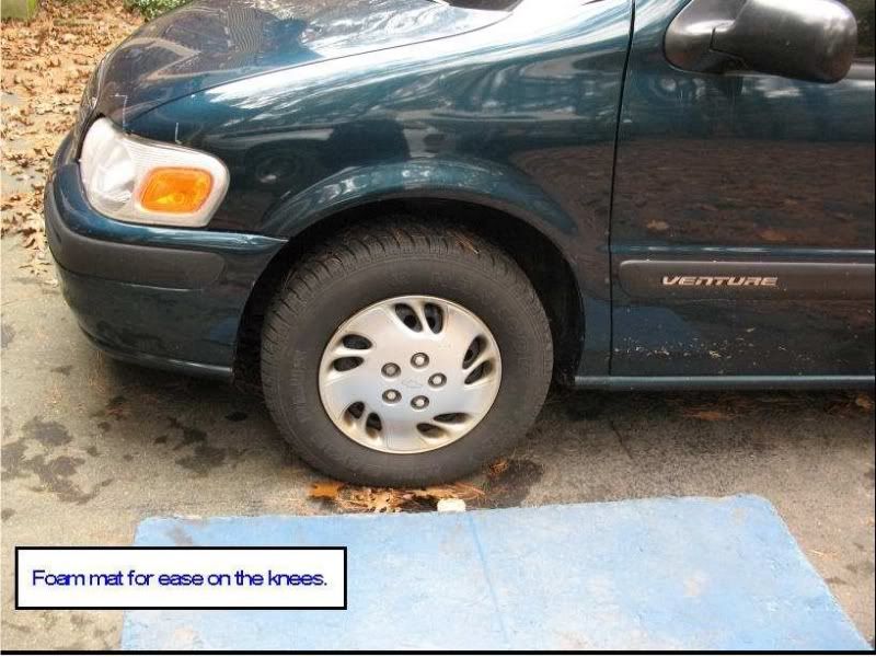

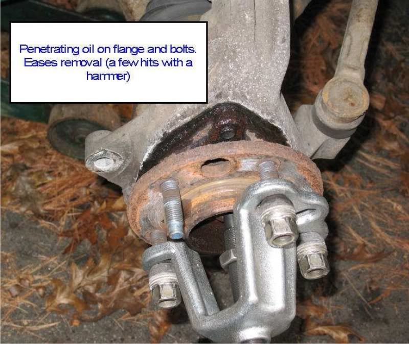

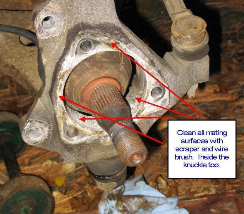

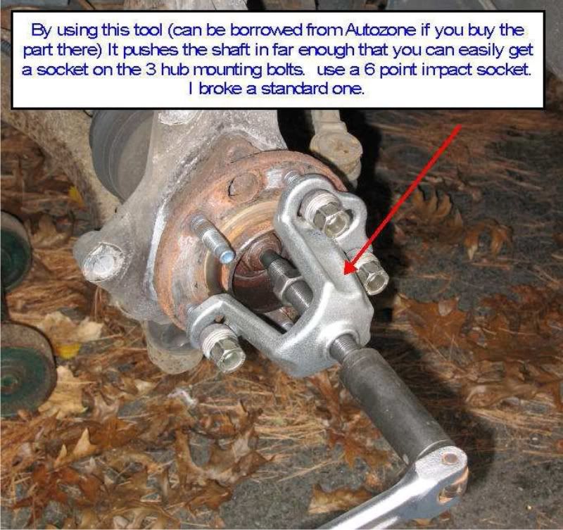

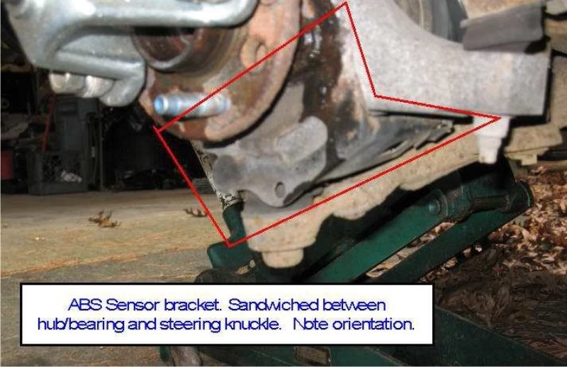

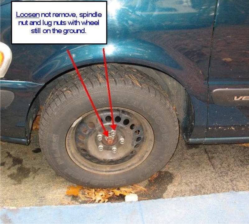

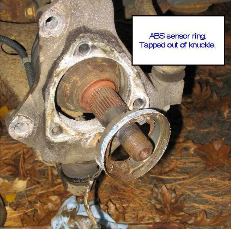

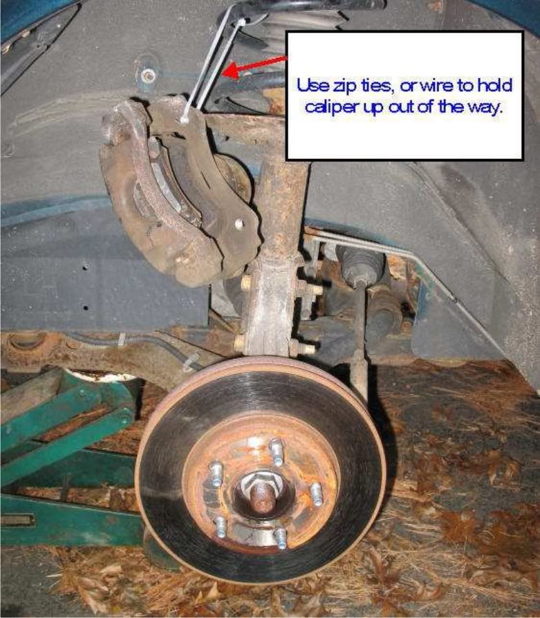

Re: 00 Wheel bearing replacement procedure ??

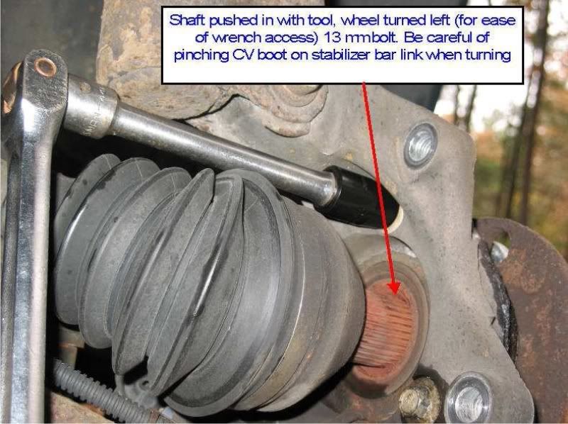

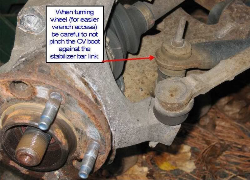

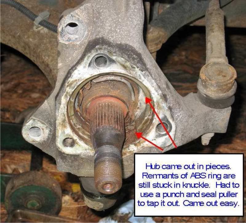

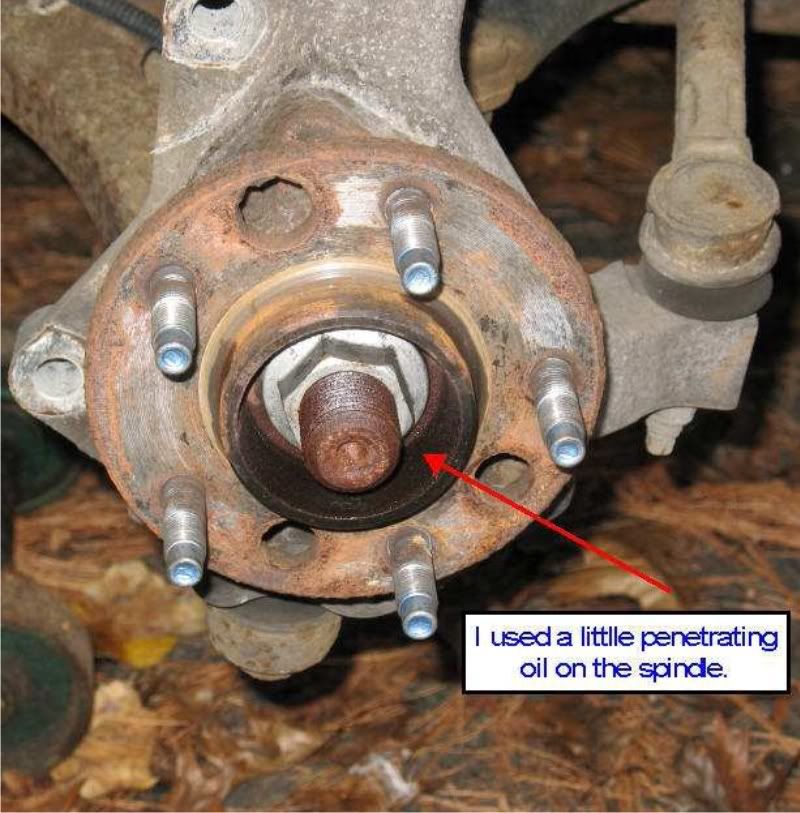

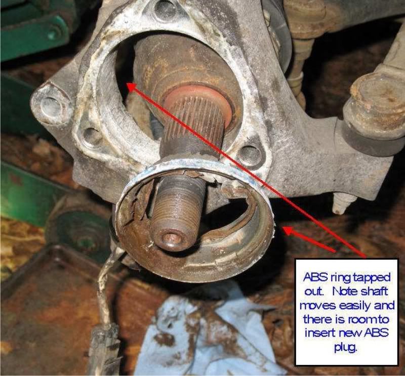

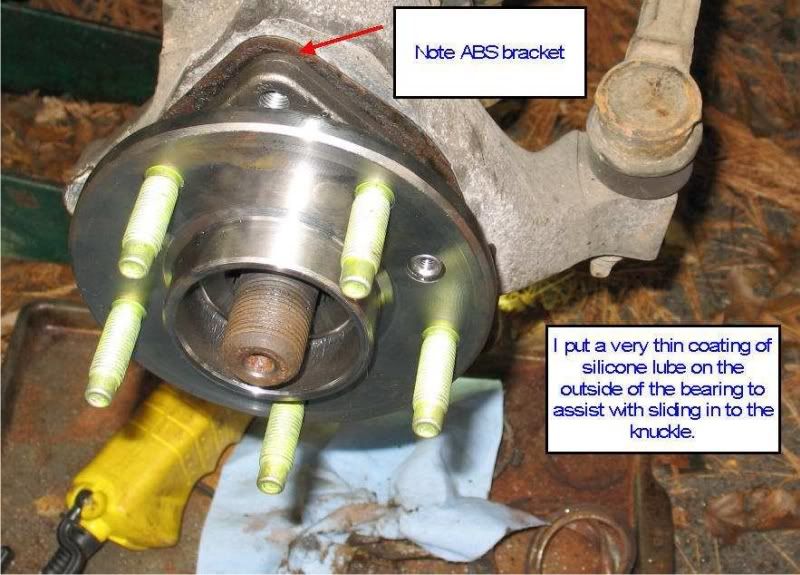

pjw73nh's step by step photo's

Nice job!!! And clear pictures. That should help a lot of people with this job.

Thanks Dwaynep.
It was my first time writing a piece like that. I guess I made the pix too big, so it was hard to get on the forum. Airjer posted it for me. I hope it helps a lot of people. The internet is fantastic for this kind of sharing. The job would've taken me much longer if I had only had just the manual. But with Youtube and the resources here in the forum, I was able to get enough info ahead of time, and get the job done correctly and efficiently. In the future I am going to post all the jobs I do in the hopes they'll help others in the same boat...
