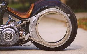

Joel, there is an answer to the chain and rear wheel issue!

Only trouble is it requires three sets of P/E chain
/Joel

LOL! You could belt drive it! I think Plastruct (possibly K&S) make a ribbed plastic sheet that could do it - failing that I've seen some good notched belts in old printers ect.
Maybe one for another project?
What would be really cool is the old leather drive belt idea made from sections of leather riveted together. You could make the belt pieces from 1.5mmx1.5mmx5mm plastic sheet and rivet them with pin heads! Now I've never seen that on a modern chop!

Now my juices are flowing! haha. I haven't really put the belt drive aside yet. First of all the chain might be too short as the rear wheel is moved a few mm back. Second, it would be cool, wouldn't it?? I've never heard of the ribbed plastic sheet that you mention but I think the belt itself would be pretty easy to create. My toughest question, and what's actually stopping me is how to get the belt installed as it has to go through the swing. I could glue it on the clutch pulley wich will later be covered. But I'm not shure it will hold. Always hard to glue something that has to be tightened at the same time to hold its shape.
Any ideas are welcome

This may have been the stuff I was thinking off:
http://tinyurl.com/n8n39q
but I think it's too big for 1/12th scale. However, if you made up something similar with the correct spaced/sized notches you could cast a rubber belt form it using molding latex. I've been told you can dye it black for tyres etc.
Just a thought!
