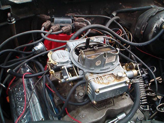

this is the carb i have.its an 65-1850s.where the screw u mentioned? this is my valve cover...the milky lookin stuff i dont like to see..gas n oil?

looks like that carb is a non external ajustable carb re float ajustment.

Good call. One moderate backfire, and the original PV is toast. There is a check ball kit to resolve that. If you go shopping for a new PV, make sure you look at the inches vacuum rating stamped in it, and try to get one with rectangular slots rather than holes for the fuel passages.
You can also run a small music wire through the air bleeds (accessible through the air horn) to make sure they are clear.
Yes, the primary bowl looks to be internal adjustment only, but the rear looks like it might have the screw.
