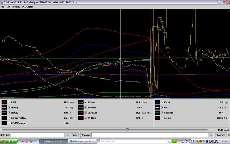

at this moment in time link says i'm making a comfortable 318 at 21 psi as you can see boost was on its way down.
Check out that intake and coolant temp good ole dam
also note minimal knock (blue line at bottom) which i have struggled with.
Let me just say iridiums < ngk bpr7es< br7es forget the projected plugs I am 100% convinced.
