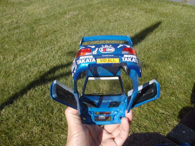

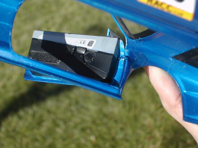

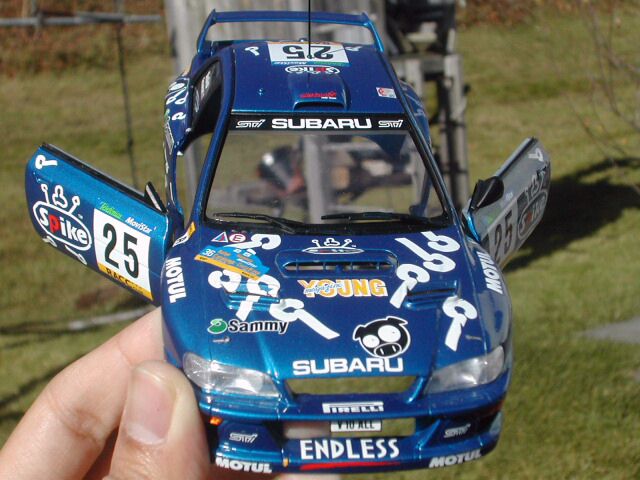

Here are some more detailed pics of the "hinges"
hope it answers some questions... remember its brass rod, with some brass tube hidden underneath some epoxy putty
BTW, noticed a bunch of touch up spots now that ive seen close up pictures of the doors... oops.
