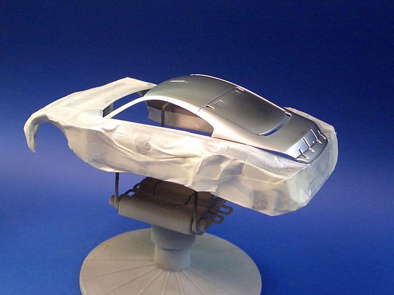

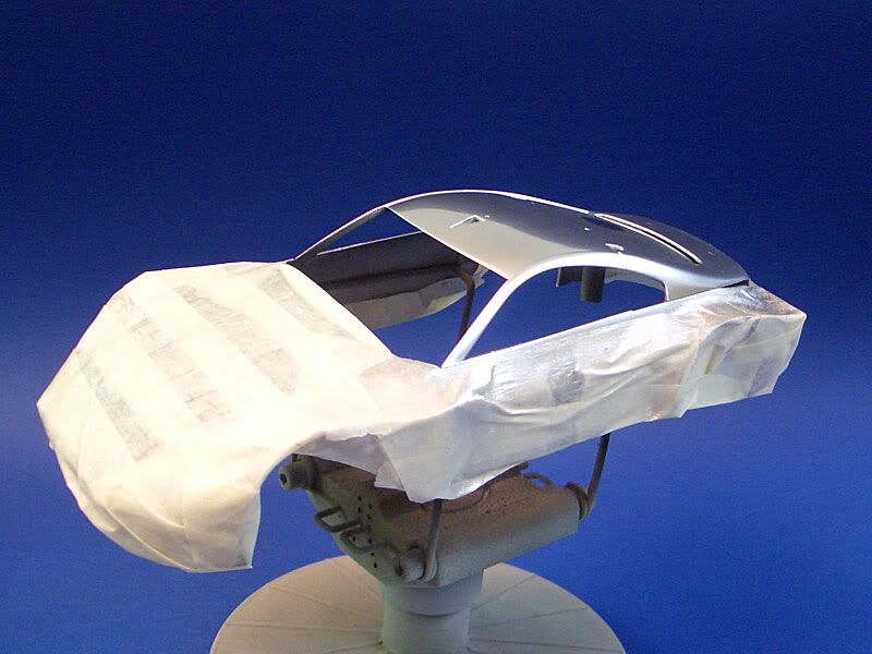

Thanks guys: I tried the Motochrome in the Z roof. Looks like I need more practice, mainly with the Motoclear that I found not so decent... BUt do experience with a stuff that cost 36 usd of 25cc is something that won't help my mind healt
TS14 Black trough AB, sanded with micromesh 6000 and polished, no wax for now. Masked for the chrome.
The Motochrome. I found good for the chome the pressure they advice (20 PSI), not so for the Motoclear: this need to be reduced to me. The first coat is awesome, but the second fall down any chrome appeal: this is after 2 coats. Looks a decent silver plated, like I need, however LOL
And the disaster: the unpolished clear: I must say that I done a test polishing a small area and I feel it much better.
Like you see I lost any reflex. I'll take my precious reflex back with some polish
ciaoo!
gio

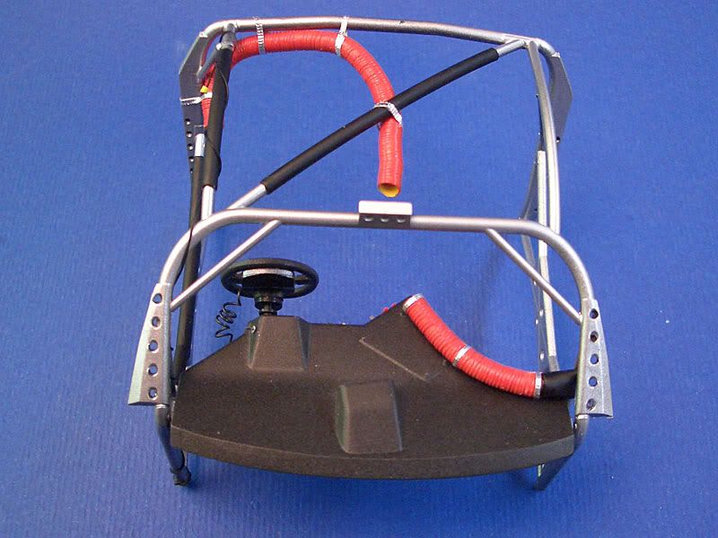

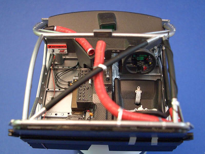

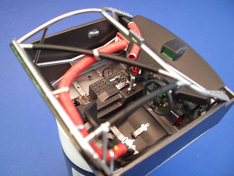

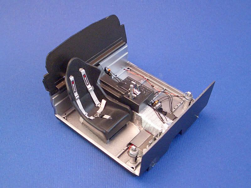

Interiors done. I used several CF patterns, from SM (the best to me), KA, Crazy and some other CF pattern done with a steel masking grill. I done cooling duct done with the "James Tremblett's tip" (or was Tonioseven the guy that created the way?anyway a guy with the "T" LOL) with spring and acryl, my reccomendation is just use the same day or it would broken trying to fold. Electronic connector with various brass and silicon pipes. Seatbelts by Tamy, from the Z detail set. Enjoy
The part in the circle was painted silver, masked with liquid mask and sprayed black trough a mesh. I added also an extinguisher and the steel cover.
Seat painted gloss black, masked and painted with a thick matt black over a thick grey, both Lechler, with low and then hi+far pressure to achieve a kind texture. Than I decaled the back.
cage+ dashboard: I add some detail over the decal in teh dashboard
Roll cage mounted
I previously cu out door panels that formed a "pool" with floor: so I easily painted glossy black and decalled, that I mounted at last.
Not far to finish....
gio
