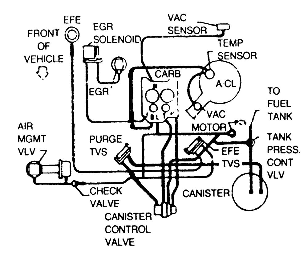

There'd better be a valve. The pipe you are talking about is the breather - this connects to the side of the air cleaner. On the opposite valve cover toward the front, there should be a metal thing that a vacuum line attaches to, which in turn attaches to a point at the front of the carb. That metal thing is your PCV valve.

Originally Posted by GreyGoose006
i know that in my car, the pcv is simply a tube connecting the aircleaner to the valve covers.
there is no actual valve, and i am pretty sure that vacuum from the engine wont make it to the pcv tube.
The tube you are describing is the CCV, not the PCV. The crankcase vent simply supplies cleaned, fresh air to the engine so the CV can draw it out. It is routed to the breather or TB so that under heavy load, and blowby gasses reversing through the CCV are drawn into the engine and burned rather than being vented to atmosphere.
If the engine lacks a functioning PCV, there's little wonder that the oil gets dirty so quickly, and that you would be compelled to run some snake-oil crap like SeaFoam through it to try to clean it up.
Look for this label under your hood, and make sure everything is connected as indicated:
Last edited by Blue Bowtie; 01-01-2012 at 11:18 AM. Reason: Corrected image hosting address

Re: Sea Foam - yes, no ?
well i am pretty sure that i only have the CCV then
where does the PCV connect to the aircleaner?
working from memory here, i am pretty sure that the only vacuum line going to the aircleaner is teh one that actuates the little butterfly valve that sucks hot air off the manifold.

There should be only one small (about 5/32") vacuum line from the carburetor (on the 'B' port in the diagram) connected to the THERMAC valve on the underside of the air cleaner.
There should also be a large (about 5/8") hose from the breather filter in the perimeter of the air cleaner to one of the rocker covers. That is not a vacuum hose, but merely a fresh, filtered air supply to the crankcase vent (CCV), and it is not shown in the diagram.
There should be a PCV valve and larger (about 3/8") hose from the opposite rocker cover connected to the large vacuum port near the bottom of the carburetor, usually at the front of the carb base, but possibly at the rear. That would be the 'L' port in the diagram.
If the engine has aftermarket rocker covers, there may not be a provision for the CCV, but apparently from your description the hole there was used for the CCV instead of the PCV valve. Do you have a photo?
