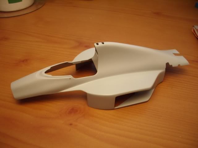

Whilst waiting for parts to arrive I have done some work on the bodywork.As I'm going to display the finished model with the engine exposed (bodywork off) I seperated the front wing from the main cowling with a razor saw.I then set about prepping the main cowling for paint.
Overall shot of cowling in Tamiya Light Grey primer.

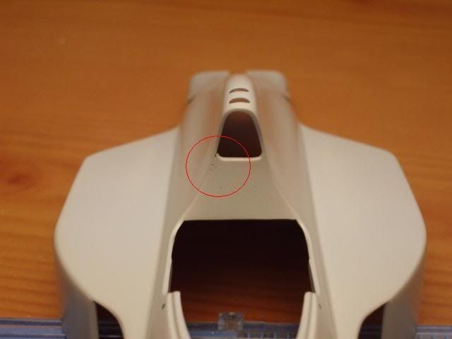

There are a few areas on the cowling that I am not satisfied with.
A few pinholes to deal with on the headrest area.(circled)
The rear section is better.I am very happy with the join on the rear of the air intakes (red square)
But the front section again has some pinholes (red circle) Not overly noticable but it will need correcting before painting

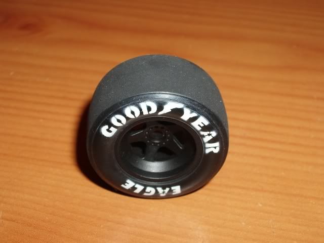

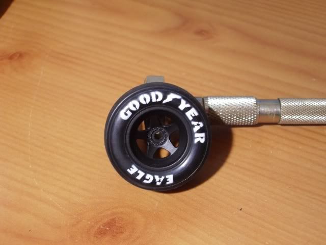

On a happier note I received my Goodyear template for the tyres and was pleased with the result it gave.

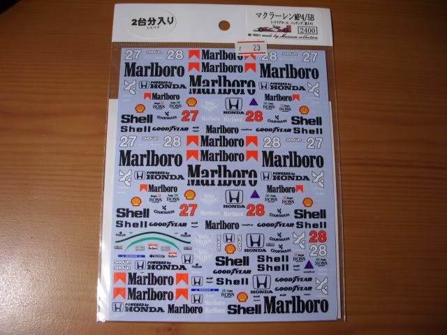

I also got the decals.A big thanks to Ron at Racing Miniatures for supplying me with these.Another company I have never used before but excellent service and one I will use again.They also include replacement photo etch wing endplates front and rear to replace the over thick Tamiya items.So that was a bonus.
I haven't used Museum Collection decals before and these are the HI Tech type where you peel off the carrier film when they are dry.If anyone has any tips on their use,please let me know.

great work Steve! What paint did you use for the goodyear logos?
Here's a link on how to apply S27 High Tech decals, might be helpful CLICK

Thanks for that link.It should be a help when I come to place the decals.
I used Humbrol Satin white enamel (no.130) for the Goodyear logos.I tried matt white first but it looked a bit dull so I cleaned it off and went with the satin white instead.

I made a bit of progress on the McLaren over the last couple of days.The wiring supplies I ordered arrived along with a few other parts.Whilst I was waiting for these I prepared the exhausts and filled the pinholes in the main cowling.This is now primered and ready for colour.I think I am going to prepare all the body parts and paint them all together in one spraying session,first the white,then when dry the flourescent red.

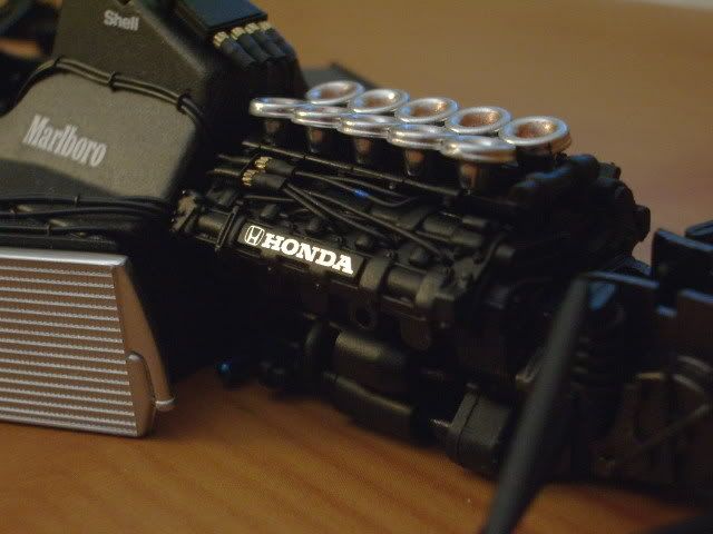

I started work on the engine wiring and finished the plug wires on both sides.I cut off the molded electrical connections on top of the engine covers and replaced them with the Perfect Parts items.The thin plug wire was then added to these and connected to the plug holes after drilling a tiny hole in each to locate the wires into.It all took a long time and I got very frustrated doing it,but the end result was worth it.
Here's a quick picture of the wiring I did on the plugs etc (apologies it was taken indoors) Oh,and the Honda logos on the engine covers were a new item from Crazy Modeler.They come on a sheet and are self adhesive,just cut out and place them on.It was easier than painting them by hand and a lot neater.

The Honda decal, so its like self adhesive PE? Sorta like some of the components you get with the FW24. I used standard (non self-adhesive) PE on my 312T3 and although it was nice, it didn't seem like it was worth the effort over BMF covered in X-18.
Also, the engine in the 5B, its just matt black yeah? Those Maclaren guys sure make the life of a modeller much easier

Yeah,the Honda logos are like chrome photo etch parts pre-cut,self adhesive.Just cut out,stick in place,burnish down with a cocktail stick and peel off the clear carrier film.
The engine is black with the gearbox at the back a metallic brown colour.

Steve, I really like what you have done with the engine. All of your work looks great!
