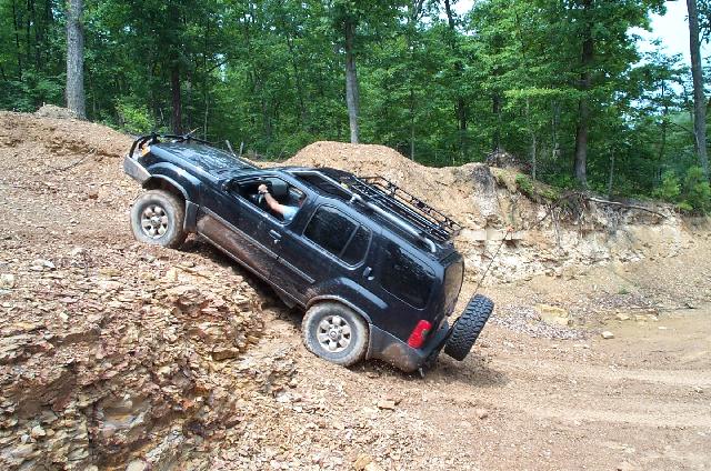

Here's a good pic.
Originally posted by Chris_McCracken
Why is everyone putting these tires up so high? Looking at that picture, I can see absolutely no reason why the tire couldn't be mounted 6 inches or so lower, just high enough that it doesn't interfere with the receiver or shackle... It doesn't need to be above the bumper height...
Imagine if this hill were a little steeper...
(picture of MT, taken by killerx.)
gothamist

Hmm.. OK, I can see that point of view now... Has anyone considered angling the aupport arms inward toward the hatch? There's a pretty good distance between the arm and the hatch, and I would think that if you angled the arm towards the hatch it would help (not sure exactly how... just thinking aloud).

While Gothamists picture is a good one, I run into more situations coming off of rocks. Once your rear tires leave the rock you need a lot of departure angle to keep from ripping things off.
