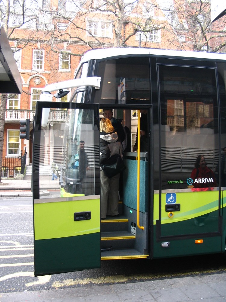

engineering these hinges is harder than i thought. i want the doors of swing round the frame, and to lay almost flat to the bodywork. hard to explain what i mean. some buses have these doors, they open and close without pivoting as such. the door is always running parallel to the bodywork.
anyone know the name to these kind of hinges?

i found an example picture of the hinges, but it only shows the door, and not the hinge detail. it should help explain what i mean though. as you can see the door must come forward away from the frame, then it moves to the side, always running parallel to the bodywork.
EDIT - found it, a spot of quick googling and research into bus/coach door mechanisms hailed the answer, it's called a parallelogram plug door, apparently. the link below gives an bird's eye view of it. scroll down and you'll see it.
http://www.nabiusa.com/parts/parts_page.cfm?res_id=7
