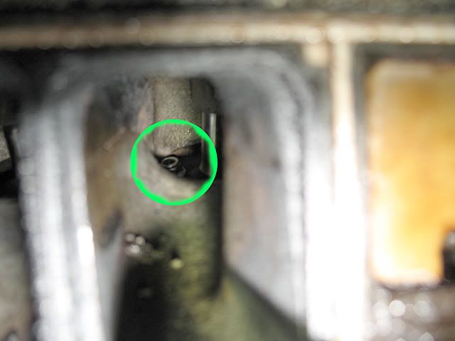

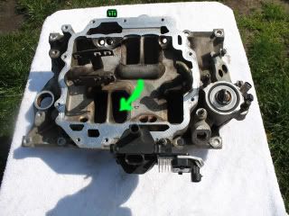

I actually had tried the vacuum cleaner before reading this. Several different sizes of clear surgical tubing that I'd taped to a household vacuum with electrical tape to seal it off. I did this many many times in an attempt to retrieve it. I'd tried a flexable grabber as well. None of which worked. Although I knew my lower intake gasket needed to be replaced, I really didnt want to get into it at this point. I was still dealing with the fuel problem...which is how this all happened. I'd dropped the 8mm nut for the fuel lines and hadnt blocked up the intake holes. I think I may have pushed the nut in further, when I tried to retrieve it with a magnet...as I said before...it wasnt magnetic....FIGURES!
So, today I pulled it all apart. And found the nut. It had entered the intake port just above the 4th injector, and when I pulled it apart, found the nut sitting just ontop of the piston. I was lucky, as the piston beside it was lower and the nut would have surely disappeared for good inside.
Anyway, lower intake is back on as well as a new gasket...so hopefully nomore leak over the back edge near the firewall.
Here you see the port it entered (arrow), and where the nut ended up (top in green)
Amazing huh!? I retrieved it with the vaccuum at this point
