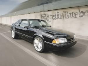

is that dan04cobra, or atleast his car in your sig? cause ive seen that pic b4 on mustangfourms and i notice the both of ya are from mass
