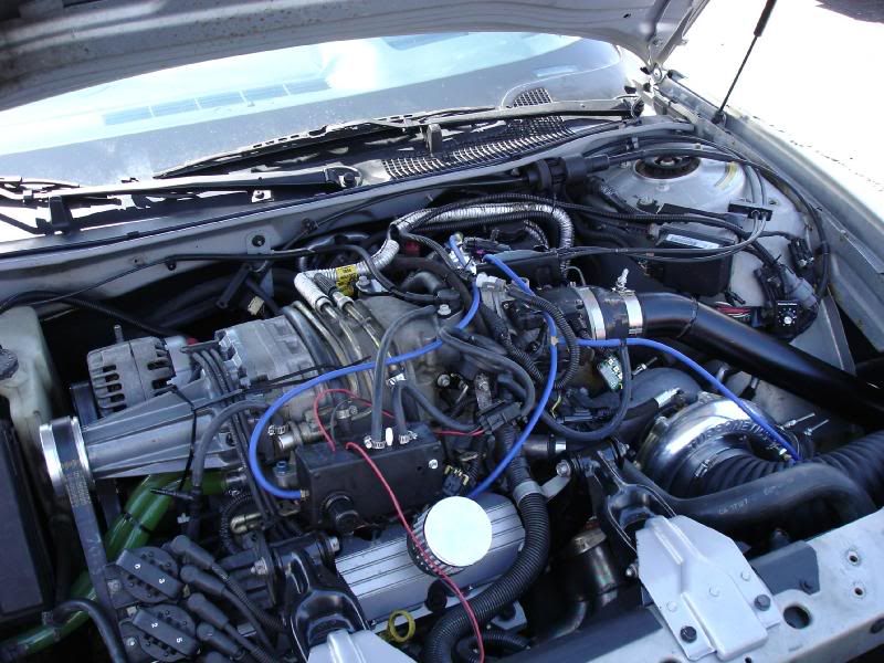

This is another one these setups done by ZZP.
This guy ran 11.16@128 with alot of room for improvement and at full weight.
The car is twin intercooled with dual Liquid to air cores running off of two pumps and one radiator.
The custom boost controller allows the M90 to operate like stock and then shut off at an adjuistable turbo boost level. It's got dials to adjust the boost of the M90 and the turbo, works pretty cool and we look forward to doing more projects like this.
We had the M90 installed with a 3.4" pulley and set the bypass to open when the turbo started making 1# of boost to the M90 inlet.
-Zooomer of ZZP
