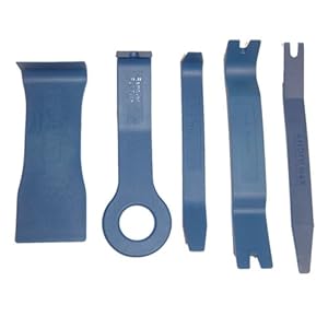

Composite trim removal tools are a handy item to have (and cheap) for removing the panel push pins without damaging the pins, or panel. Click Here
