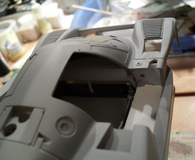

first of all I closed all holes in the bodyshell. plasticard 1 mm and cyano glue as putty
then i add the side vent holes for cockpit.Plastic is quite thick,so u have to work vary carefully with a sharp blade to make it thinner near the holes
bodyshell now is ready for primer. I masked all the clear parts with tamiya tape
