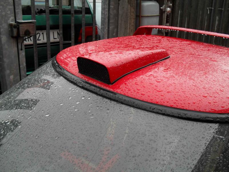

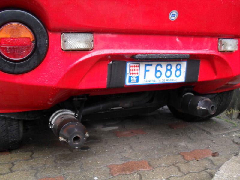

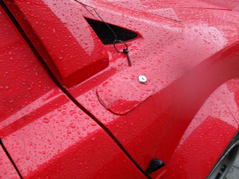

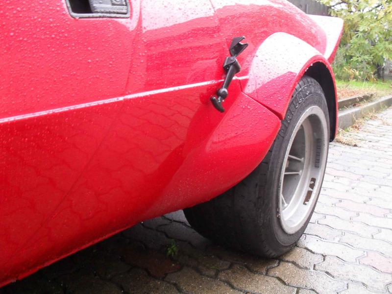

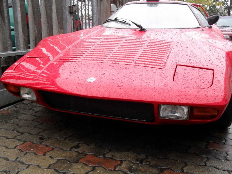

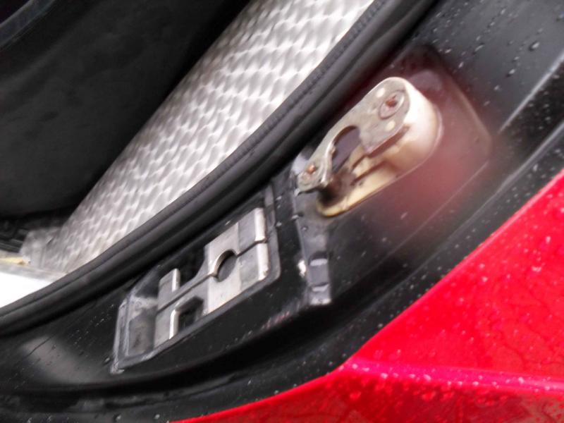

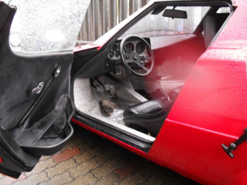

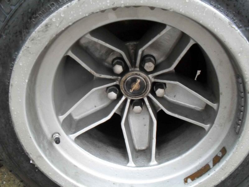

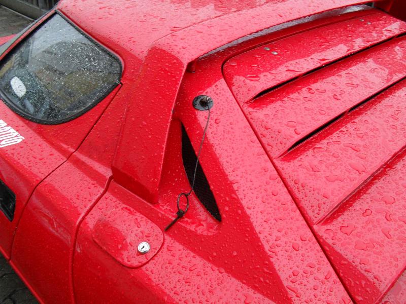

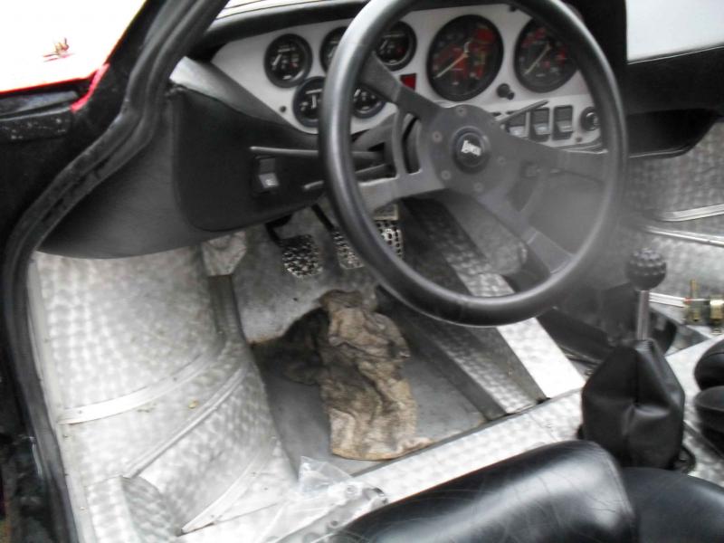

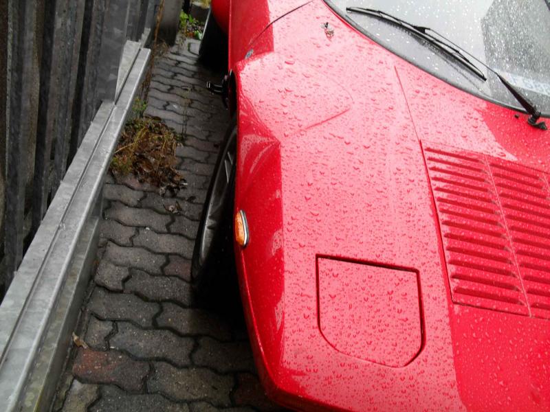

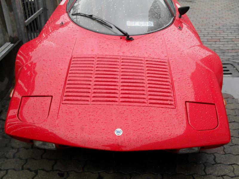

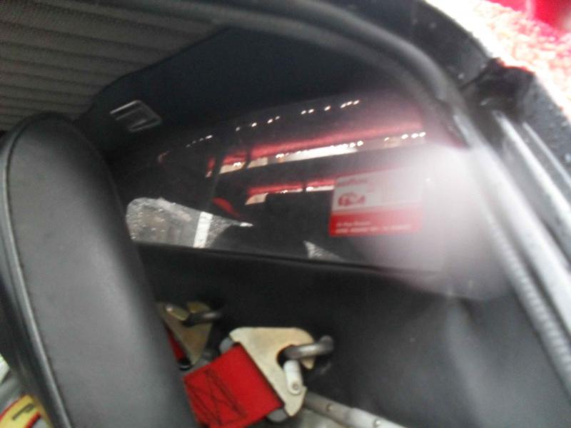

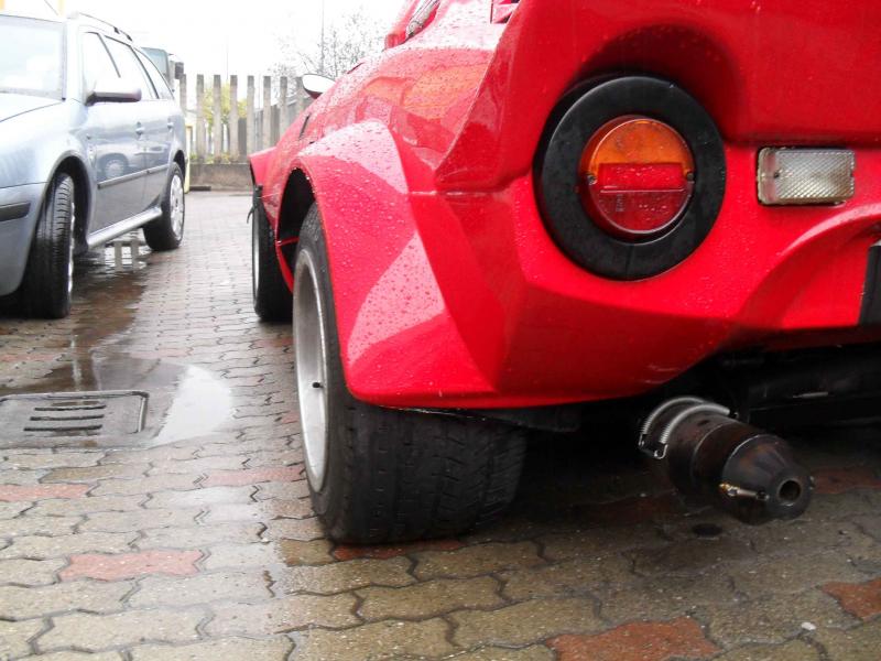

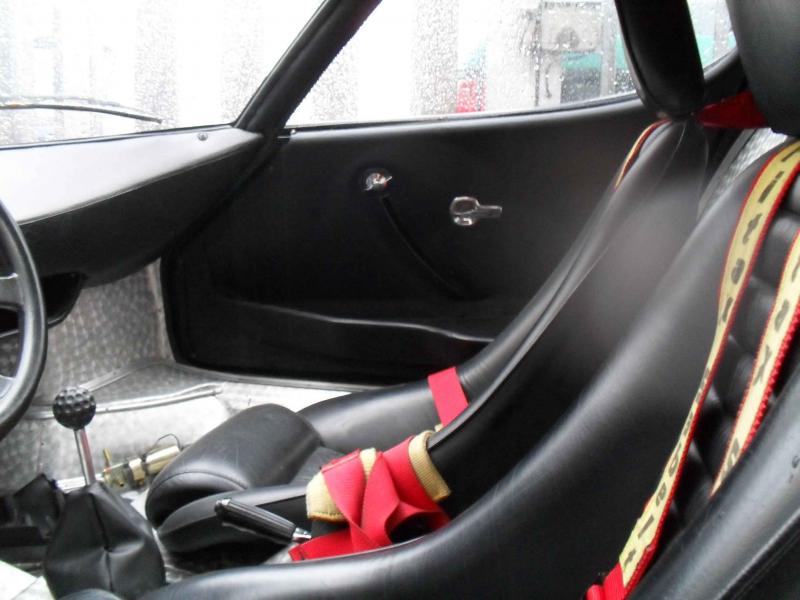

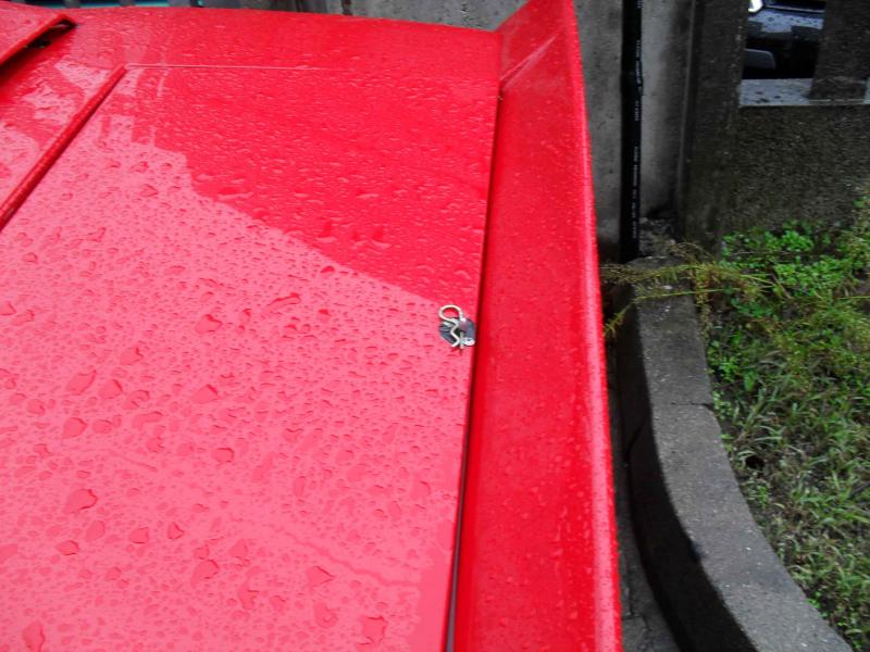

Ciao Capri,
here enclosed are some pictures of an ex-works gr4 car (this is not the stradale version, is the real racing car).
Real thing, owned by a (lucky) friend of mine living in my town.
Hope this help in the building of your model.
These are the most interesting pics I have.If u want to see some more please have a look here:
http://www.modellismo.net/forum/stat...a-stratos.html
As u can see the biggest mistake in Doyusha model is on the rear wheel arch (look at those pics and look at your model).
I have the safari version, but already cloned in resin the wheels (rims and tires) to make the "anabolic" version.
If u, or anybody else needs theme PM me.
Paolo - LoveGT40 Modelworks

Re: Doyusha Lancia Stratos HF 1/12
Wow,very cool pics from a very cool car!
Thanks a lot!
Yes,the rear fender is wrong in the doyusha kit.
Im trying to get it close to the original.
Kind Regards
Christian
