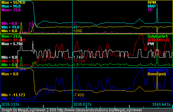

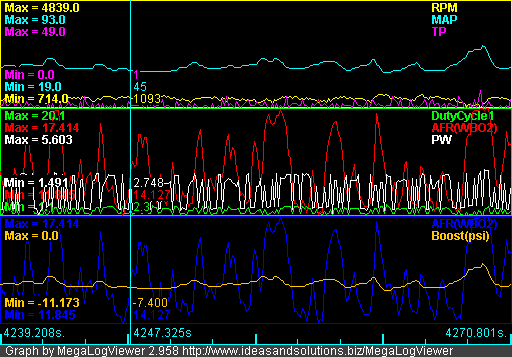

Didn't make it to the car yesterday, but got there today. Sadly its raining so couldnt do too much. However, I did get her idling pretty nicely. The TPS was bouncing all over and can't come to a conclusion why. Ran new wires, tried weird jumpers... nothing was working. I reloaded the old map and worked off that to try fresh. After some work, car is idling pretty good. Little rough at times. It does run extremely lean at times and early it killed the motor a couple times. Not sure why the AFR is all over the place though.
Here's the MS log: http://www.dsharp-design.com/1129Log.xls
Just to show people since they all can't see my logs, this is what idle is looking like. Pulse width is still bouncy.

This may sound ignorant but is it possible that the TPS is bad?

I tried a spare TPS that I have and was getting the exact same results as the current one. The SAFC used to read the same thing so I bought a replacement to fix it. Didn't change anything. Both sensors are within spec also.

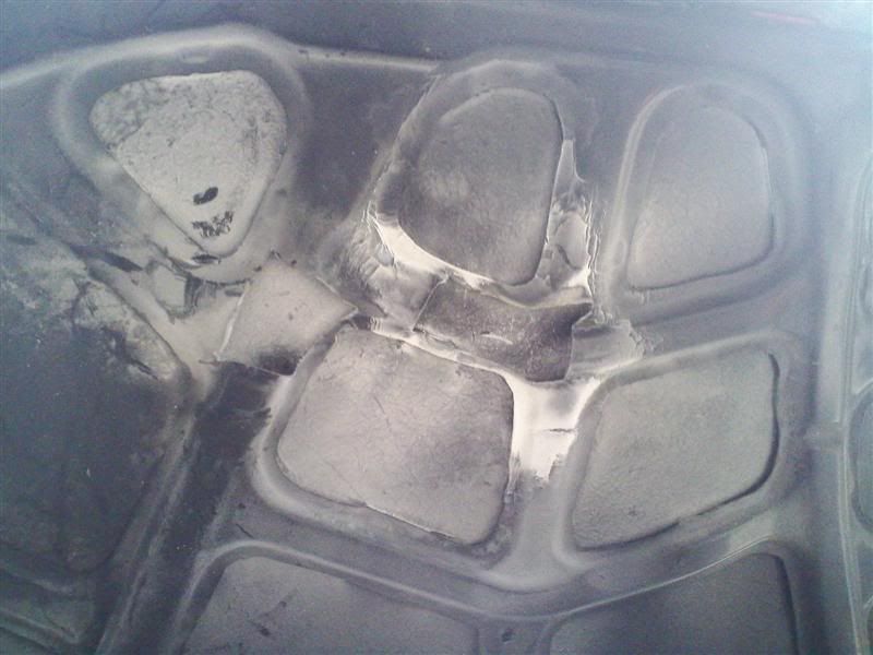

I cut the hood while the car was warming up good. Unlike Jason, I didn't have to pound the top of my manifold. Made 2 cuts on the braces on the inside of the hood and she closes perfectly.
Perfect fit

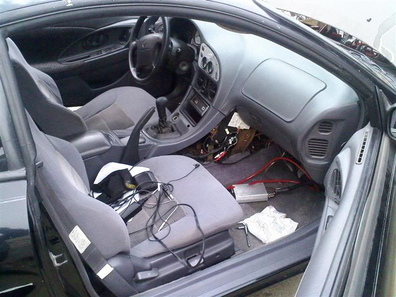

Random inside shot. Have to clean it up a lot still and rehide MS and the cables.

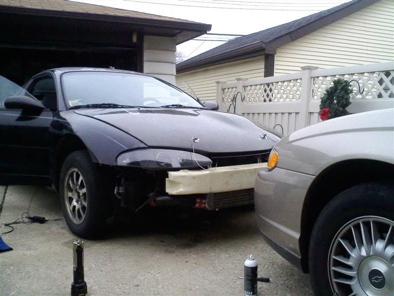

Then finished mounting the bumper and cleaning up some other stuff and the garage. Was hoping to do some more driving all this week to get the break in done, but it snowed, and have another 2 snow storms on their way, so who knows when the car will leave the garage again
