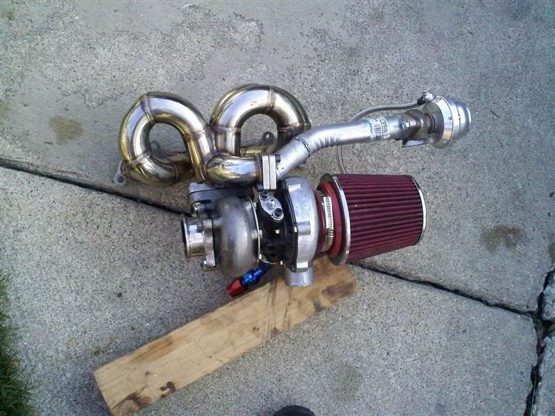

Today I was hoping that the coolant leak was done with at the T-stat and I'd be able to get running better. Sadly, wasn't the case. As I pulled the car out from the garage, everything I did on Tuesday failed. FML.
Luckily, the extra T-stat housing I ordered came in today along with another package I needed for the car and it all worked out for the best. I pulled the manifold from the engine to pound in the runners. Bought a torch and heated them which helped some. Also dropped the $30 for a thread tapper thing to finally finish the 2 broken studs in the head. I had JB welded some studs in and those apparently failed. So did those right and holding very nicely now.
While it was off, was able to replace the -10an fitting that broke with a new one and take care of some other minor things that needed to be fixed.
The "Power Plant" as I called it all day. Sexy
I used some new maps and those are failing as well right now. Car idles, just badly. It's high, then low, high, low.... in the video below you can hear it pretty good. I took some logs and will be going through them and seeing what Jason thinks about them. I've been going over the car trying to eliminate all possible problems, like using new vacuum lines to MS and stuff like that.
